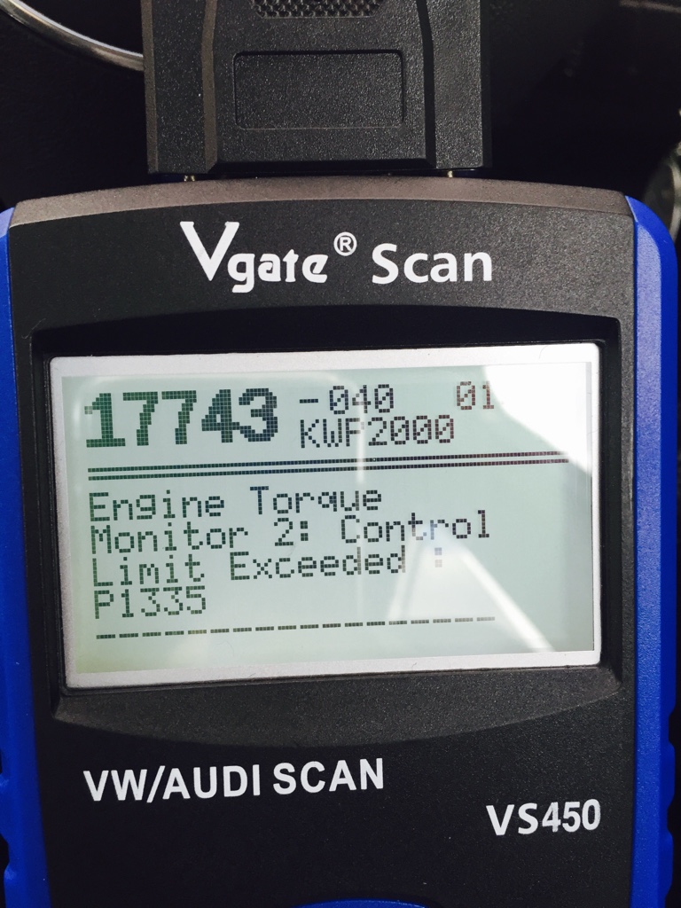

Scanned car last night before I set off for Walsall this morning, scan came back clear..
70 miles into my journey about to hit the M6, the EPC & ESP lights came on & I loss power. Coasted over to the hard shoulder, turn car off & back on & continued journey.. Not a problem after that.

Will scan wen I get back tonight.

Hoses are fine, just ran scan & cleared this message.. Strange one
Car running fine now, no issues on way home

I had what sounds like the same problem. Loss of power when using cruise control. It was a poorly fitted turbo pipe. I am told its the way the brain works out what speed you are doing, it confuses it if there's an air leak and decides thers a fault. It may not be the same problem....but it sure sounds like it.
