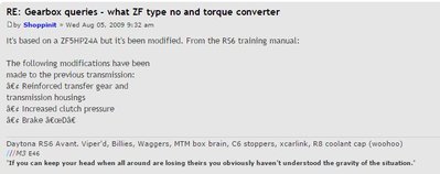

Where does it state that?
Re: Gearbox etc...
Um, here...

Re: Gearbox etc...
Yes, that's what was done to the ZF5HP24A...and it didn't help worth shiiteblm70 wrote:Um, here...
Never once heard of the RS6 trans referenced as anything else...and it still needs upgraded VB pressure, updated clutch discs, and multiple pins and seals replaced to be better.
