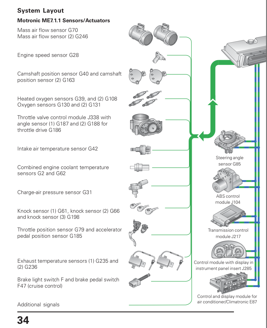

I'm also slightly confused by some people referring to it as a crank position sensor. Some Audis appear to have both a crank sensor G4 and an engine speed sensor G28. Does the RS6 make do with just the one or is there also a G4 sensor which is maybe the one my mechanic has found? Anyone have a schematic that shows the layout?

Sorry, you obviously missed my other thread "Worrying Experience" where Shop correctly diagnosed a faulty engine speed/crank sensor. My Vagcom verified this. I sourced a sensor which is not the right one, and it looks like it's a main dealer only part after further searches. Looks like a job for Virdee after all...
I just wanted to be 100% sure that there is only one crank/speed sensor on the beast, as many other Audis have two.

I think that's wrong Stoo.
G28 is engine speed sensor
G40 is cam sensor 1, G163 is cam sensor 2.
Cam sensors are a little bigger and have 2 bolts that attach them.

Nobby is correct according to the system layout diagram I found in a C5 study guide. Should be receiving the sensor from Audi today. Apparently it takes between 2 and 3 hours to fit.
