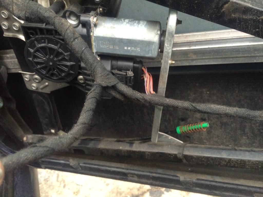

Whitey33 wrote:Hi all, I just changed the n/s front window mechanism, now, when I close it window, when it's nearly shut it lowers 100mm, it's like a safety system is acting but out of sync with the window position, can this be re set, or have I done a schoolboy on the install? Cheers.
Hi,
What caused you to change the actual mechanism?
Mines packed up, see attached pic...
Ebay are selling the wires for a C5 A6, will that do he job??
Has anyone got any part no's for what needs replacing?
