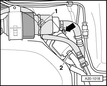

...ive got a drawing of the fuelpump/filter, but dont know where its located...

Mines is on drivers side approx between drivers and passengers door under a cover..........remember I have the correct side for the steering wheel unlike you foreign lot

As Amanda says. Annoyingly they don't have the nice connectors which just pop off, but have jubilee style clips.

No the fuel filter is on the outside of the car on the floor plan ie underneath the drivers and passengers side doors.mavada wrote:aha, so the carpet has to come off?
