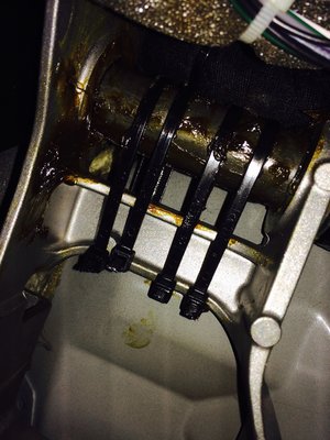

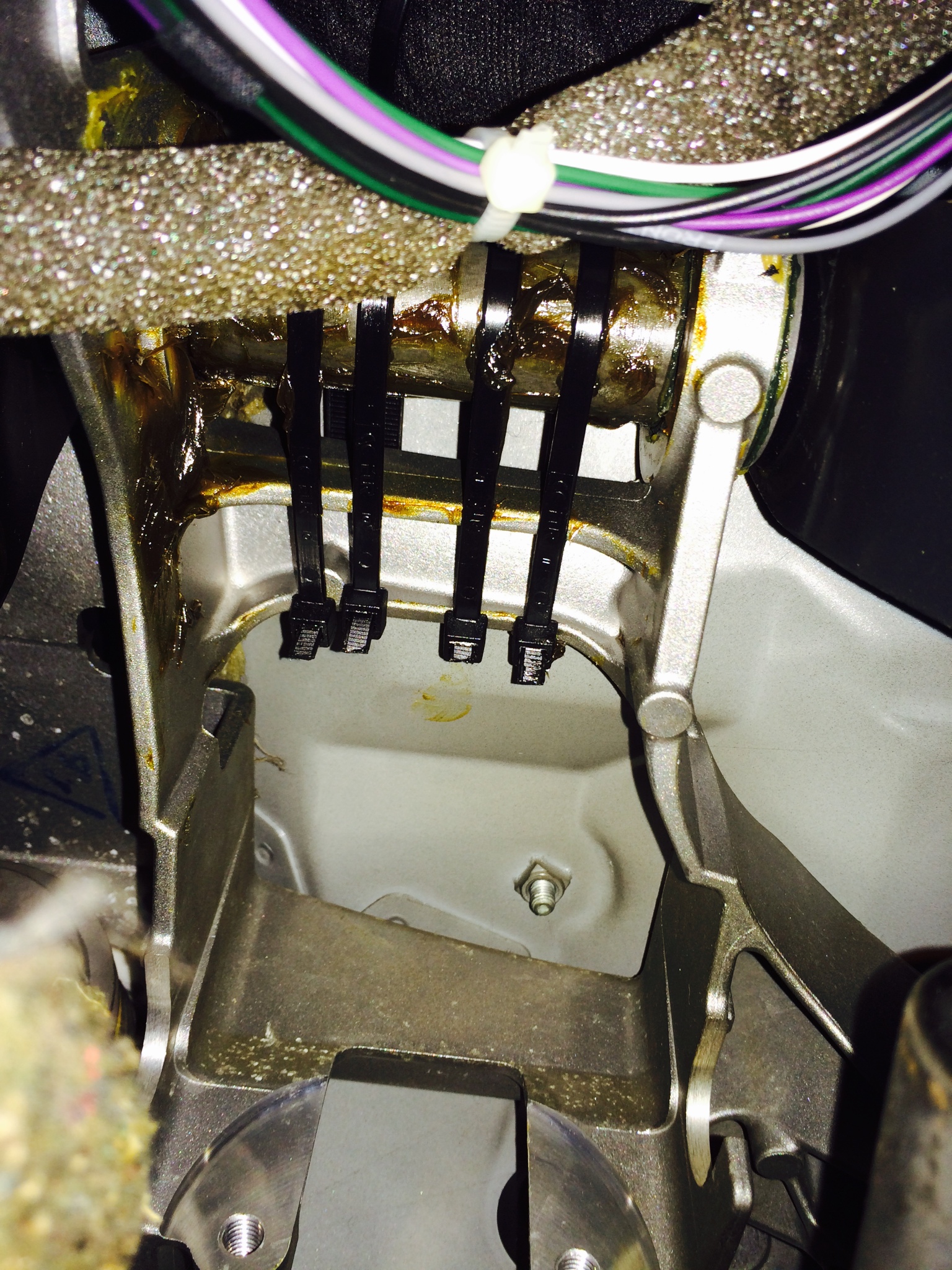

Okay i looked and saw what was done, It is where the brake pedal connects at the top.
Here is a couple of pictures so you guys can do this yourself, it's only a 10min job
Re: Vibrating accelerator pedal
Marvelous thanks. I take it that bit still rotates so needs a little greasing?

taspland wrote: Here is a couple of pictures so you guys can do this yourself, it's only a 10min job

Well, not a fantastic fix really, is it. But, if it does the job.
Proper replacement bushing has got to be the best way, but the pedal box is a proper faff to get out so sometimes a Heath Robinson half measure is good enough.

I'd be looking to put some bearings in there if possible. It's not easy to see how it's set out from the photos but obviously the original bushing isn't up to the job.

I did mine, and it's stopped the vibration, with regards to movement, the bar only moves about a quarter of a turn for the brake pedal, and the cable ties move with it,
I'll keep an eye and see how long it holds up, but for a freebie I'm very happy with it, for a perm Fix then Unit20 can fit a replacement washer.

Just to add to this, MRC worked their cable tie magic on the + last week and it's pretty much eliminated the vibrations.
