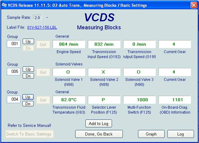

mavada wrote:
Shoppinit wrote:Sounds like the car won't come out of park then.
Maybe your selector cable as come off / snapped.
Can you plug the vagcom in and see what gear the gearbox thinks it is in when you move the selector? Might be an easy fix.
/edit: cat - the first link you posted showed me a cat before you fixed it.
http://audisrs.com/about16043.html&high ... gear+ratio
This...:
From Doug:
''Common problem is the gear selector switch - easy to see if it is in the gear that it thinks with diagnostics. We see that all the time so best to check that before you change boxes.''

Can you talk me through this? Where do I look and what exactly am I looking for? If its an easy fix I'll certainly give it a go

Similar like this...

mavada wrote:Similar like this...
And what do I need to look for/ change??
mavada
Posts: 3270
Re: Gearbox locked in gear
Post by mavada » Sat Jun 01, 2013 9:20 pm
...to see if it is in the gear that it thinks its in, group 001 last value... :thumbs:

Ah yes, now i understand. I must try that when i get my Vagcom back. What does it mean if the value is incorrect/ correct? Gearbox rebuild? Replace sensors?

My thoughts are the same, plug in with Vagcom, check to see if the TCU is seeing that you've selected the gears when you move the lever. If not the gear selector switch is dead. It's on the outside of the gearbox and can be replaced in situ. It's fiddly but possible.

RS2 wrote: My thoughts are the same, plug in with Vagcom, check to see if the TCU is seeing that you've selected the gears when you move the lever. If not the gear selector switch is dead. It's on the outside of the gearbox and can be replaced in situ. It's fiddly but possible.
I think that the reason that you can't pull it backwards is the almost 'hill control' type feature that these (well the last 3 I've driven anyway) gearboxes have that they won't allow the car to roll backwards when in a forwards gear.
MG
Unfortunately, I don't think it's the selector because you can hear the cavitation when he puts it in a gear. I don't think it's the F125 either. It does sound like something has broken.
