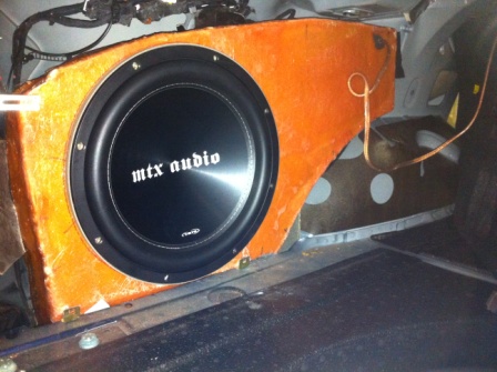

A short post to show that it is possible to install a 12" subwoofer in the rear cubby hole

Drove it with a MTX amp, mounted under the rear parcel shelf. The amp had its own built in low pass filter. Have to say it was one of the easiest installs I have ever done.Shoppinit wrote:How are you powering it? What wiring did you do? Have you got a low pass filter on it?
Live feed (12+) taken from the battery in the boot so nice and handy. The remote turn on and signal wires taken from the Bose amp/ sub (right hand side cubbyhole), The signal to the Bose is low level (not amplified) so ideal to send to the MTX amp.

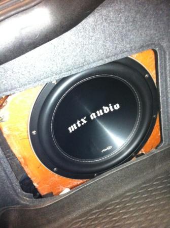

So you've pulled out the CD changer, amp and TV gubbins and replaced it with this sub?
What is in the other cubby hole now? Is the old BOSE sub redundant, or are you running both and get more bass?

You are 100% correct Tv tuner and cd player removed when the RNS-D was replaced with a RNS-E. The Bose was still in place and connected. By having the second sub I found I could turn down the bass on the head unit so all the other speakers didn't have to work as hard, which seemed to improve the over all sound. My normal music of choice is David Bowie so no drum and bassChrisRS6 wrote:Most of what you just said went way over my head![]()

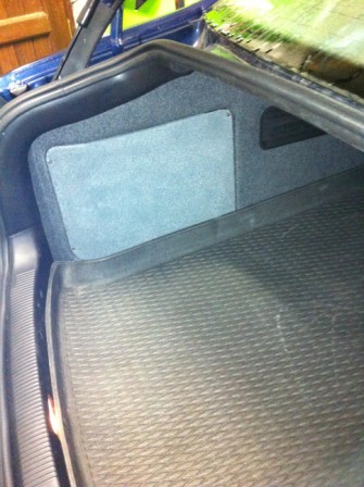

Love the matching carpet colour.

The box looks too small for the sub. You'd have been better off with a 10" or 8" which would sound better than a 12 in an under sized box.

I think that for a homemade job it really isn't too bad. Yes, better results would have been had by paying an ICE company to make the box and provide a tuned sub but for non-audiophiles that probably balanced out fairly well. The only thing which was a bit of a shame imo was the fabric on the panel but it is stuck away where people won't really see it. You can get fairly well matched acoutic fabric for parcel shelves etc, used that maaaaany moons ago.
