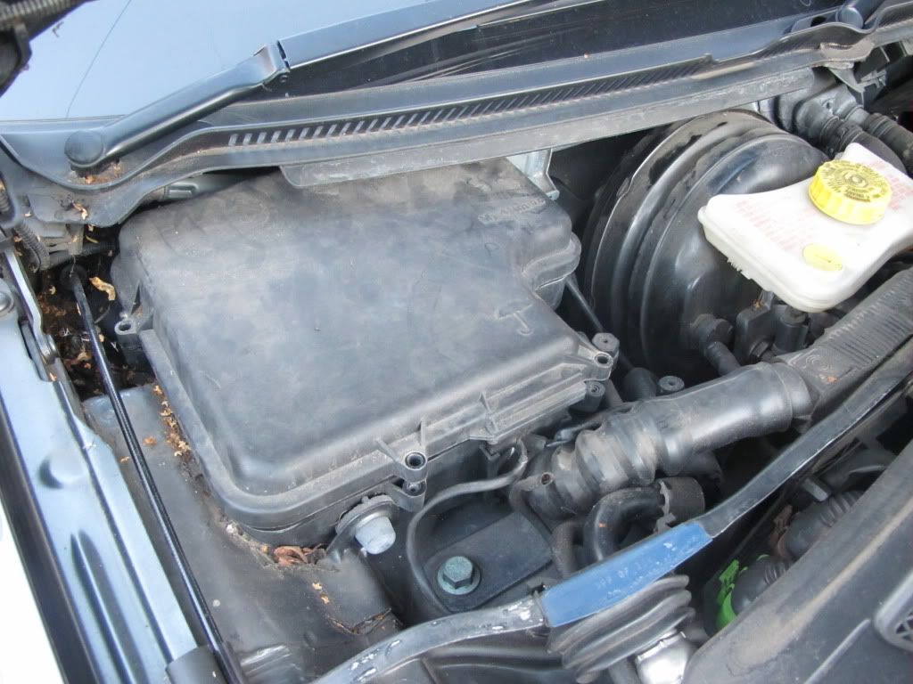

thanks for help guys, its getting trailered away tomorrow, no battery is in the boot its showing half charge and good voltage, i drained loads of water from and around the coolant bottle and along the scuttle area, loads with a dish cloth (half a bucket) and sucked up yet more water with a pipe, I couldn't see any drainage holes around that area, is the box top left the ecu box, checked inside all dry
as i don't have use of another car,hopefully its something simple, i have drained all the water that was built up, speaking to my mechanic friend he thinks it could be a bad earth, unlikey to be water build up, but i really don't know, its stuck in park so going to be a mission to move it tomorrow have to get trolleys under all four wheels

there is a drainage hole but it gets stuffed with debris....that could be your problem because you have some wires going from the battery to the starter in there and if they were under water this is what might've happened...

wow look at the state of that, i would not be surprised if mine is the same tbh
is that underneath the black box in the left corner? where can i find that? please help anyone!

not sure how it is for the RHD cars in UK, but i am pretty sure is the same, it is located somewhere under the cooling liquid tank...

Yes its underneath the coolant bottle, the battery terminal from the boot, it was full up to the brim with water down there, both drains were blocked, the positive lead from the battery had snapped off, hense the dead car!! i managed to get the cable reattached, and drained out a full buckets worth of rain water!! after reconnecting it started first time!
its in the garage now for the drains to be fully unblocked, new battery terminal fitted new fuses etc, and the cable sorted out!
so glad i found it!

Took it to a garage who replaced the terminal section totally and rewired the cable
thanks for posting this saved the day, the terminal is found underneath the coolant bottle not that black box for anyone looking for it

So this is the place you can jump start the car then if you can't get in the boot. First time i have seen the pic, good work.

I was just thinking the same thing! Just realised I didn't put the car on a battery conditioner, when I go to start it in feb/march time, I may have to use this picture!
