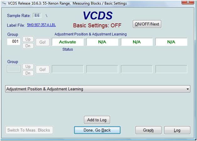

I'm going on Holiday into Europe tomoorrow and need to adjust the xenons for driving in abroad. I found a guide on how to do this with vagcom but when try to do it I'm not getting the On/Off/Next button displayed (see image below)?!.. I have a proper Ross-Tech cable.. What am I doing wrong?!..

Just checked the fault codes and I am getting the following which after a quick google might be due to me running lowered suspension (H&Rs)?!.. Anyone else had this issue?.. They seem to be set in the lowest possition?!..
Sunday,05,August,2012,21:11:52:61332
VCDS Version: Release 11.11.3 (x64)
Address 55: Xenon Range Labels: 4Z7-907-357.LBL
Control Module Part Number: 4Z7 907 357
Component and/or Version: dynamische LWR D08
Software Coding: 00050
Work Shop Code: WSC 00000
VCID: 0403E94314003E9
Fault Codes have been Erased
1 Fault Found:
01539 - Headlights Not Adjusted
35-00 - -

Is the suspension set flat - not tilted up at the front?

Suspension was setup with the front slightly lower, is on level surface when I'm trying to do it?!..
