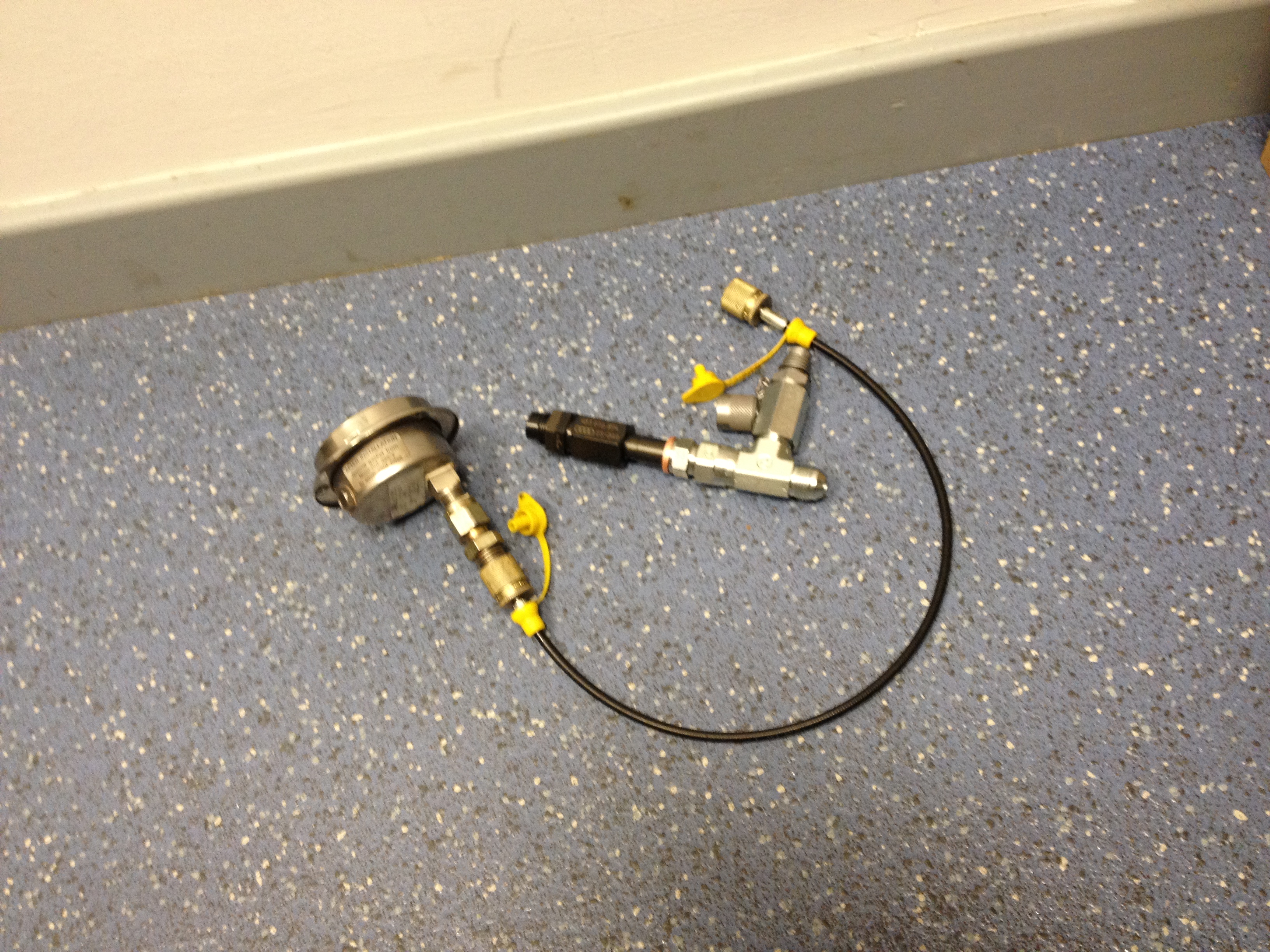

Made up test fitting and have a pump that will do the job.......... if it doesnt work its coilovers

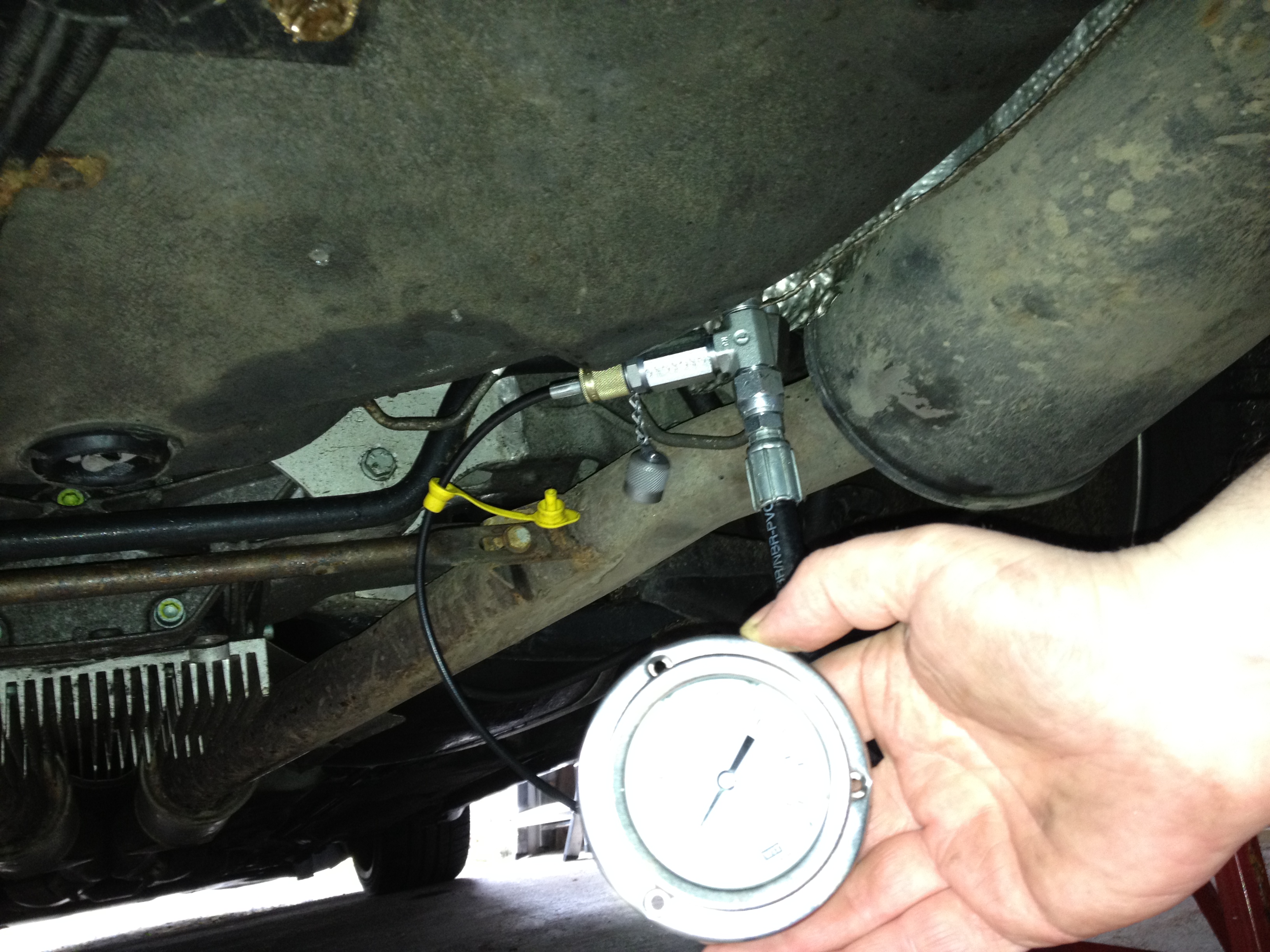

Disconnect pipe to OS front from accum and connected pump with gauge. No pressure as suspected.
Charged OS front shock to 5 bar which happened very quickly with minimal volume of oil which would suggest no air. Increased pressure to 20 bar again no change to ride height on OS front.
Reduced to 5 bar and disconnected QD coupling.
Fitted male coupling onto test pump and connected to accumulator again no pressure. Started charging and the pressure quickly reached 11 bar, then volume started going into the accum which proves gas pre charge is still present. Levelled out at 15 bar approx and slowly increased with more fluid until sudden pressure rise at 20 bar which is the accum maxed out. Vented pressure and estimated that approx 0.75 ltr volume in. Recharged to 16 bar. Rocked car with gauge fitted and pressure seen to fluctuate with movement as would be ex with front shock disconnected.
Remove test pump and gauge and reconnect QD couplings. Rocked car hold roof rails and full damping has returned.
Road test car and its back to its former glory with no noise and safe sure handling. :biggrin3:
