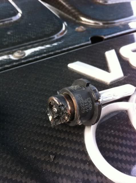

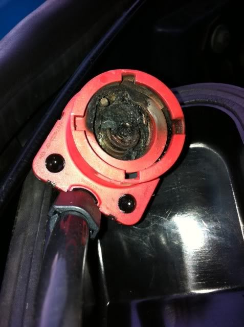

Quick one really. The drivers side headlight bulb went slightly discoloured and shortly after it stopped working.
Went to take it apart to switch the bulbs to check if it's the bulb or ballast and I noticed smoke coming out of the part pictured below :shock:
Has this happened to anyone before, any thoughts?
Also, how do i remove the bulb (don't want to break anything)?
Sid

The black and red cover just pulls off the bulb . Check the inside of the connection as it could have melted the connector ..

Smoke was coming out the red & black part :?

Bit of an update?
Pulled it apart today. Here a couple of videos and pics.
I'm guessing I need a new bulb and ballast/wiring.
Seen one on ebay for £35. Guessing they'll be pretty dear from Audi.
Any idea what's happened?

Those bad boys use some serious juice when in use... chances are a touch of moisture caused a short.

Got it done today morning.
The headlight will need to be removed. It's held with 3x star shaped screws (2 on top & one through a hole on the left), its also clipped in on the right hand side.
The ballast is held under the lamp and is easy to remove and replace (one screw).
I think I need a new set of bulbs tough as they don't seem to match. One is yellow-ish and my original was a lot more blue. Will get a new set ordered off eBay.
