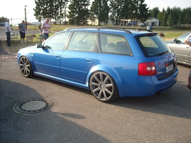

Post by iR8V10 » Thu Nov 10, 2011 10:28 pm
Have a search on SRS for definitive wheel thread I started for the rs6, loads of pics...
I went for genuine c6 rs6 wheels and loved them to bits!

Post by rob8457 » Thu Nov 10, 2011 10:51 pm
im in love also, made my mind up its just got to be the RS C6 wheels gonna reserch where to get them from apart from Audi.
