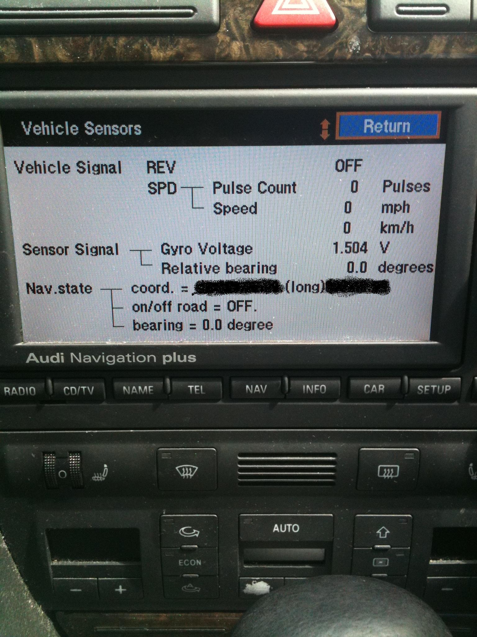

I had the alternator on my 2003 done last week, but today i went to use the sat nav and the location was not updating fast enough for it to work, so i checked the signal in the engineering mode and all fine seeing lots of satellites and seeiing my mph on the Gps, then i checked the speed pulse and this wasn`t working at all, not seeing my speed or anything. So my question is does, anyone know where this gets the speed pulse from? and any ideas what the garage could of knocked or done for this not to work?

When i look in engineering mode, on the nav sensor info there seems vehicle signal says its off, is it possible that if anyone can look at there rnse in engineering mode and see if thats the same on theirs.

heres how mine looks at the mo,
thanks

Also, I'm no expert but I would presume that the "OFF" on the screen is refering to the revserse switch signal, not speed.

When you drive the car with the engineering screen up what happens to the pulse count and speed numbers?
Re: RNSE
Does sound like the signal's not getting from the dashpod to the head unit. Bit of a mystery as to why that would be though. Perhaps pull the head unit out and see if there's an obvious problem with the gala wire?
Re: RNSE
All done and working, i removed the unit gently, then i noticed 1 wire on the back that was hanging there all on its own which which had the metal connector on the end and had come out of the connecting block that plugs into the unit. On top of the unit it tells you what pin connector should connect to, and the no.3 pin was the vehicle signal and this had the wire missing, so pushed the lonely wire in the connector block, connected that to the unit, had a drive round and its all come back to life. so you were spot on Shoppinit. The only thing that i don`t understand is how this come out, but who cares its all working now.
