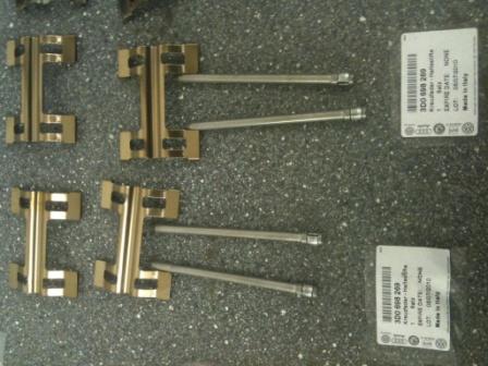

I have answered some of my own questions now so will post here for anyone else doing this type of work.
First off, the pins in the front were stuck very hard and got well dented as I drifted them out and that was with me being really carefull and using penetrating oil.
To get round that I bought 2 fitting kits - 3DO 698 269 - It appears the stainless sliders are no longer available.
Then I found the bolts needed for the rear calipers - WHT 003 250 and N 907 403 02.
What are no longer available though are the caliper bolts to hold the front caliper on ! - Part number: N 100 650 02 (M12 x 1,50 x 70 Grade 10.9) - Also no longer available are the shims that sit behind teh front pads nor the springy metal bits from the back calipers.

I thought I would finish off the thread I started, if nothing else it will make you laugh ! (or cry as you feel my pain)
After buying all the bits I needed (or so I thought)..
A3DO 698 269 Service Kit - 2 x £16.58
AWHT 003 250 Bolts 4 x .82p
AN 907 403 02 4 x .78p
I went to put the new pads in and found that without some serious hammer work they would not fit in, if they did go in then they were so tight they would have stuck on the discs the first time I hit the brakes.
So, I took the caliper off to have a better look.
What I found was that corrosion had got under the stainless steel sliders so that they were bent upwards and were thus restricting the pad movement, it looked like a chemical reaction between the two different metals.
Simple I thought - lets take them off and clean them underneath - oh no - not so easy, they are held in by 3 x M5 screws that were corroded in so, I had to send them off to be spark eroded out ! - £120 !!!
Then, once I had the caliper back I thought I better replace the bleed nipples, again, what a pain, 3 came out (just) the other was stuck in so had to go away to be teased out and even then it made a mess of the thread it left behind.
At this point I thought, I better check the actual pistons. Low and behold, when you applied pressure some came out OK but none were great, they were all sticking a bit so... you guessed it, I took them out also !
I then looked up the price with Audi for a new set but they were too expensive.
You could see on the dust seals that they were Brembo part numbers 20.4872.40 and 20.4872.42
I shopped around and, with the UK Brembo agent never returning my calls (the calipers are in fact Brembo part numbers 20.7675.02) - I had to order them from abroad with a new set of pressure seals also. (£80 incl shipping) - The pistons are nothing more than a standard 28mm and a 32mm - GPR Motorsport in the UK used to list them for £8 each but are no longer agents :(
While I waited for the parts to arrive I paint stripped the caliper and re-painted it and, after a new pair of stickers were applied, got some high temp lacquer on the top of it all.
I also took the opportunity to send my wheels off to be chemically stripped and repainted ready for the re-build (4 x £55), it was then that I found one was badly buckled, luckily the original owner had bought a spare so that had to go off to be done also (another £55). 4 new tyres seemed appropraite while I was at it (Vredestein Ultrac Sessantas @ £615 for all 4 from click-on-tyres limited)
So eventually (6 weeks later) I had two rebuilt calipers, all back together, ready to go on the car.
That's not the end of it - I managed to cross thread BOTH pipes going back into the caliper as the 11mm nuts were so corroded (and it was dark and cold out).
I salvaged one pipe but had to buy a passenger side one for £31 (8EO 611 707H).
So, the car was ready to go and then I realised the tax had run out as had the MOT - More money !!!
However, I'm there now, she is all back together and the brakes feel (and look) great.
I don't want to have to do that again in a hurry (nor can I afford to) but my pain might make yours easier should you have to undertake the same job.
Just need some sun now ! - Justin :)
