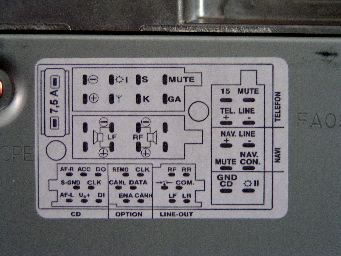

Is there a mod that allows the TV to be watched whilst the car is moving? I'm thinking for passenger rather than driver..!

If you cut the "gala" wire on your Navi and insert a switch, you can then enable and disable TV in motion. The wire is usually labelled as either "GALA" or "GA" on your nav unit.

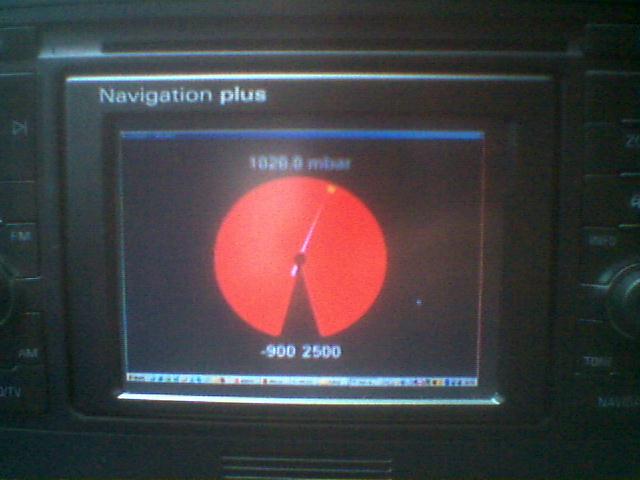

that'll be the big tv shaped thing in the middle of the centre consol, here's a pic of mine displaying a boost gauge

cool- looks like a Windows PC connected up there :)
