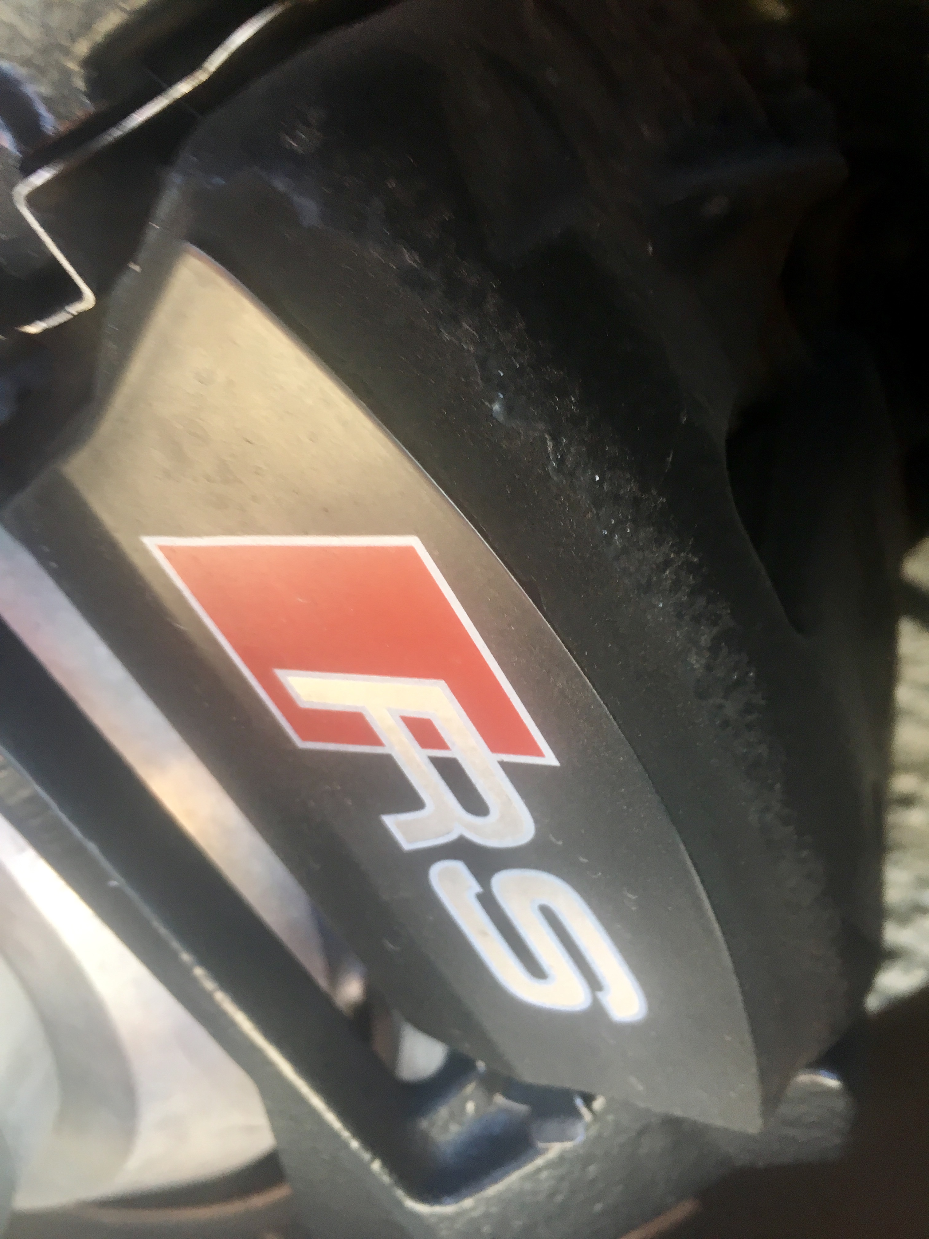

Post by skirs6 » Sun May 27, 2018 6:59 pm
Not the best pic but you can see the black filler around the edge as obviously there is no recess 👍

Post by Ashventini » Sun May 27, 2018 8:50 pm
Thanks. I can see the filler. Looks like quite a lot of it which makes me wonder why so much? Does the plate not sit flush to the calliper? I know there is no recess (Ridge the shape of the top of plate) for it to "butt up" to but this amount of filler suggest it needs a lot because it doesn't sit flat? My calliper are not going to be kept black. I am having them done in Ferrari yellow - so I don't want a load of back filler visable.
Thanks for the photo. If you can give me some insight as to why this filer was needed. Your look fine BTW as you have stayed black..! which im not going to.
