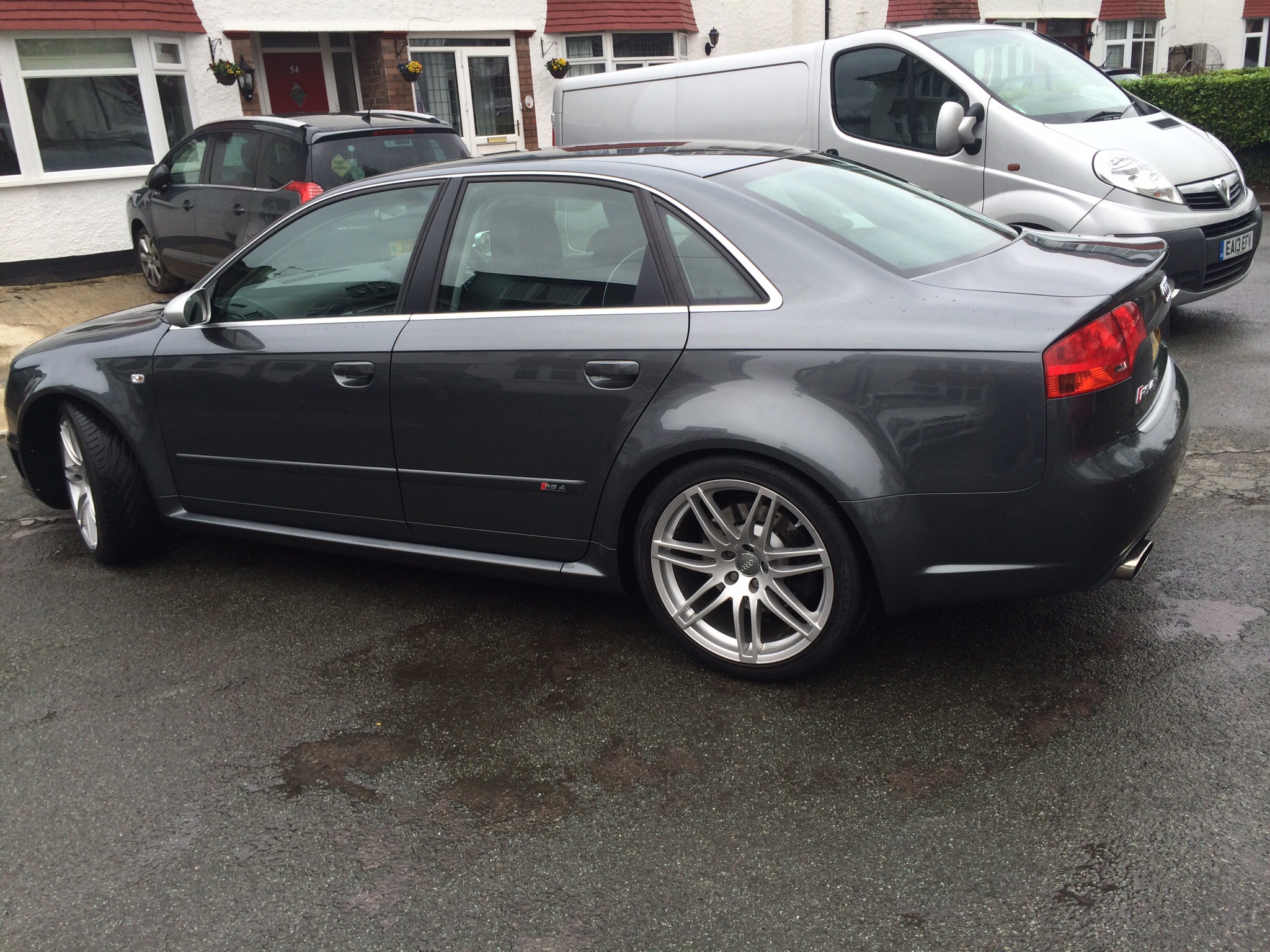

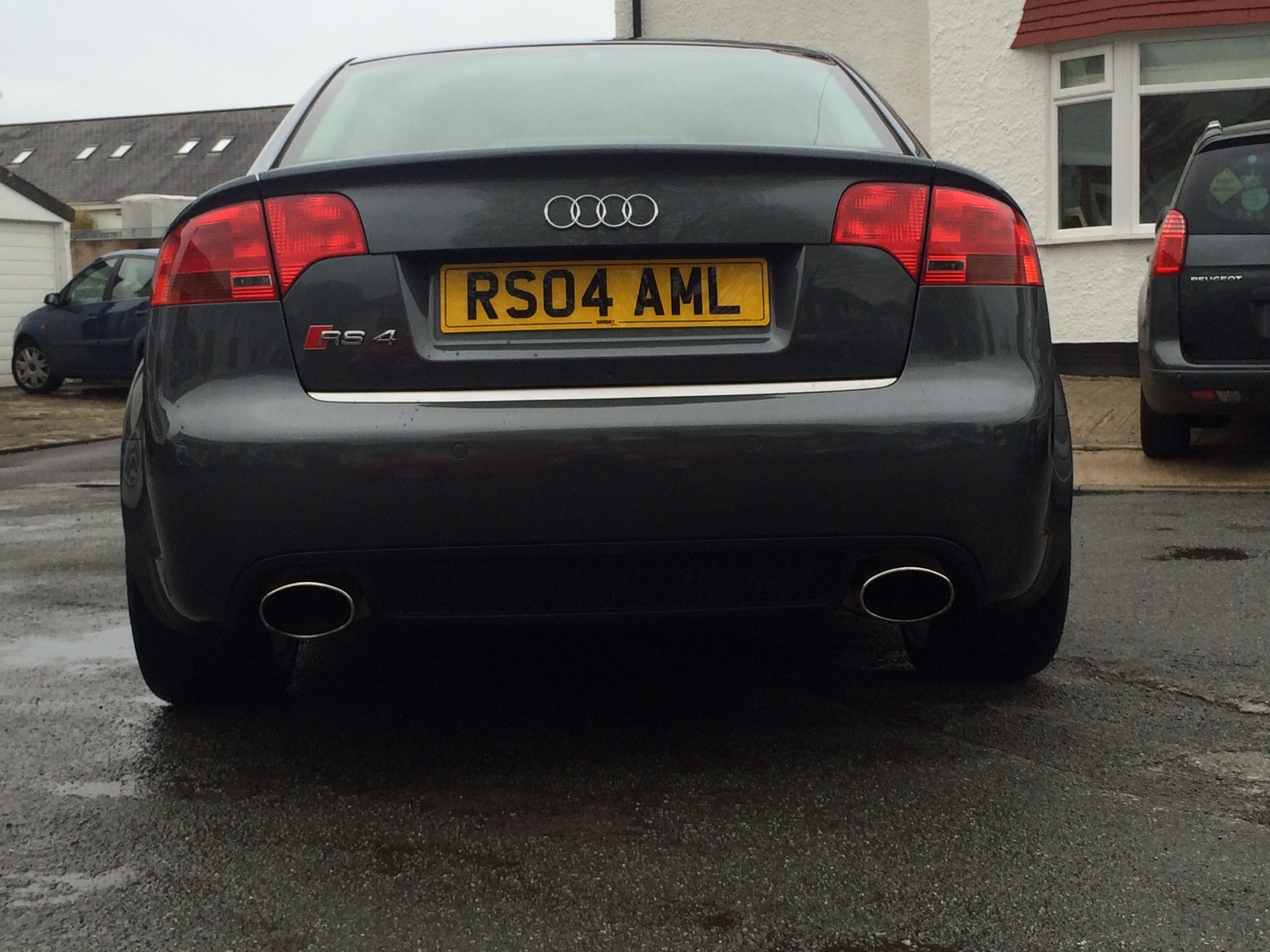

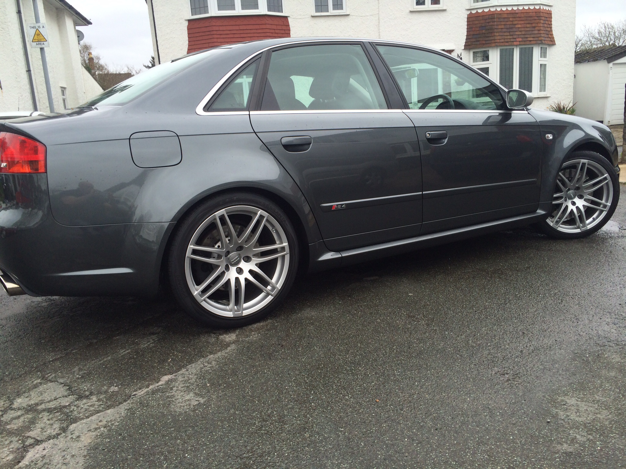

Here's some pics of my B7, standard apart from the Milltek (for now anyway)

If you are after power / performance mods, then avoid a cone filter and stick to an aftermarket panel filter (in fact the OEM isn't really bad at all). Most of the supercharged cars use panel filters so if they are good ennough for them then they are fine on NA cars. The cone filters will sound amazing though and if fitted with one of the Revolution carbon intake kits it will look the nuts too, but any extra gain will most likely be offset by heat soak from the engine.stiffmeister wrote:I'm a bit gutted that the Milltek doesn't really boost performance much if that's the case.. It does sound ok![]()
Just ordered a K&N filter cos the standard one is grubby and I know these filters are good from my bikes.
Next step for me will def be, off to Unit20 for a full decoke, stage 2 remap and quiz them on deflapping the manifold (whatever that is?) poss ditch the standard cats too if that helps.. All suggestions/input great fully received guys
(Will try n get some pics up as soon as it stops bloody raining!)
As far as exhausts are concerned there is not a lot to gain with any aftermarket cat-back kit. The biggest gains will be from gutting the pre-cats (400 cell). This will still mean you can pass the MOT without any problems, but will get a little smoke when first started (can't remember if a remap is needed for this, I have a feeling it is not essential). If you replace the standard cats for sports cats then again there is very little to gain as the standard 200 cell cats are very good. Maybe a bit more of a gain from 100 cell cats but sports cats are very costly. Bin the cats altgother for max gain and low cost but this will mean you need a friendly MOT man once a year or go through the hassle of swapping exhaust every time.
