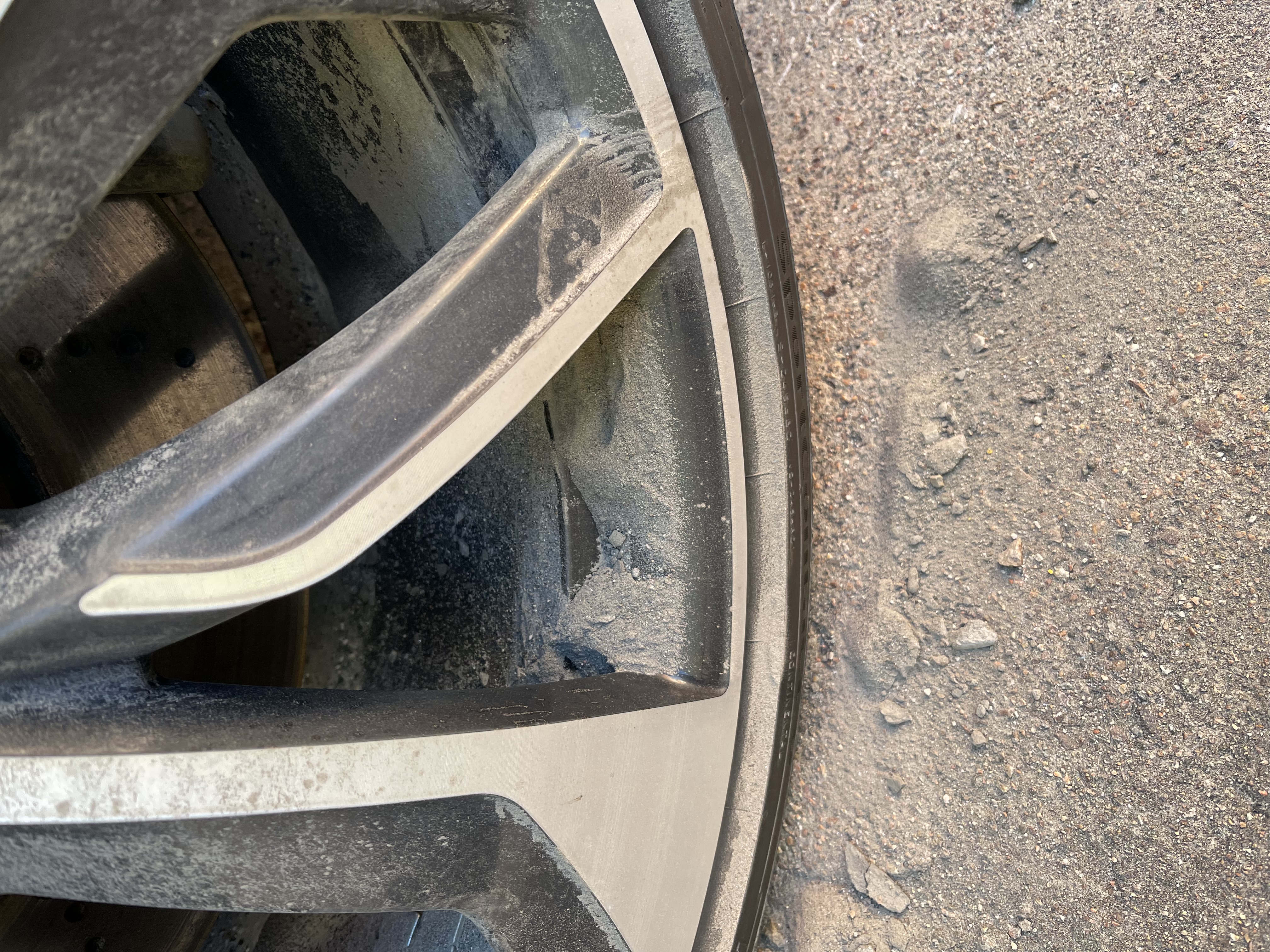

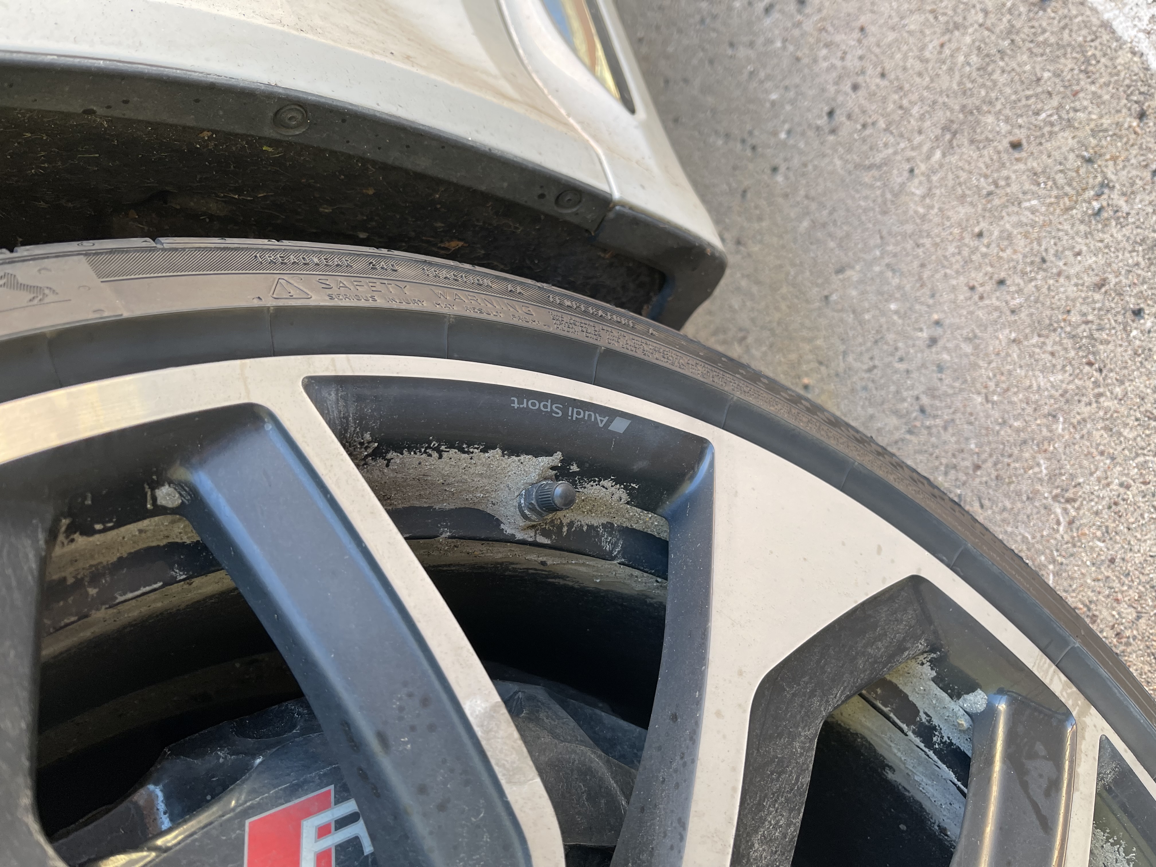

I've recently come back from a 5000 mile road trip up through europe to Norway and Sweden.
At one point on the way back I notice a wheel wobble that resonated at 80mph (130kph) at which point I thought I had lost a wheel weight, no biggie.

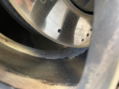

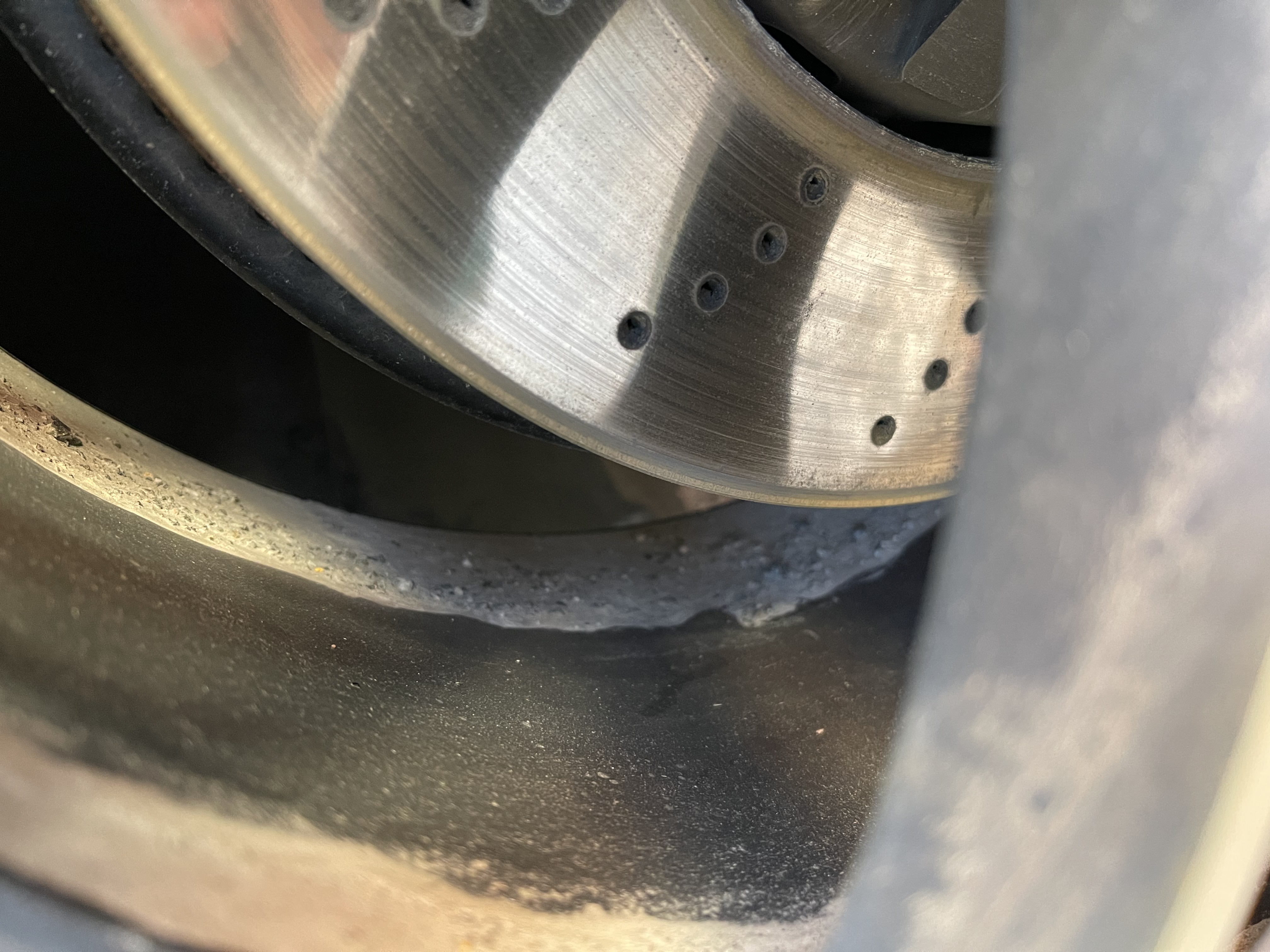

Any how when we stop at our hotel for the night I check the wheels and find I've not lost a wheel weight but have got a build up of very fine road dirt stuck in the groove behind the spokes of the wheels. Also a ring of the same around the inner edge of the barrel of the wheels too.
I brushed the offending dirt build up off the wheels and the following day the wobble disappeared!

Re: Wheel wobble not what you think!
The amount of unequal build up of dirt, mainly around the valves was throwing the wheels out of balance!
Looks a bit like cement or something, to be sticking like that. Might be worth a look under the car as well if you can.
Yep, that will do it. Did it come of easy enough without staining wheel
We did drive through a number of road works, it was not cement dust but a very fine road dust that ended up as a light coloured mud that stuck itself unevenly to the wheel rims as it dried.
It all brushed off with a little effort.
