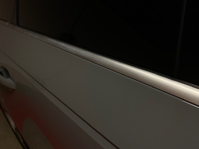

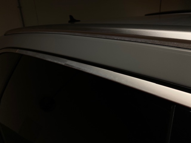

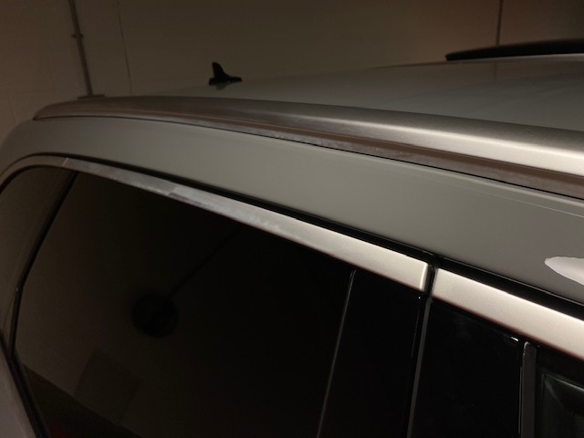

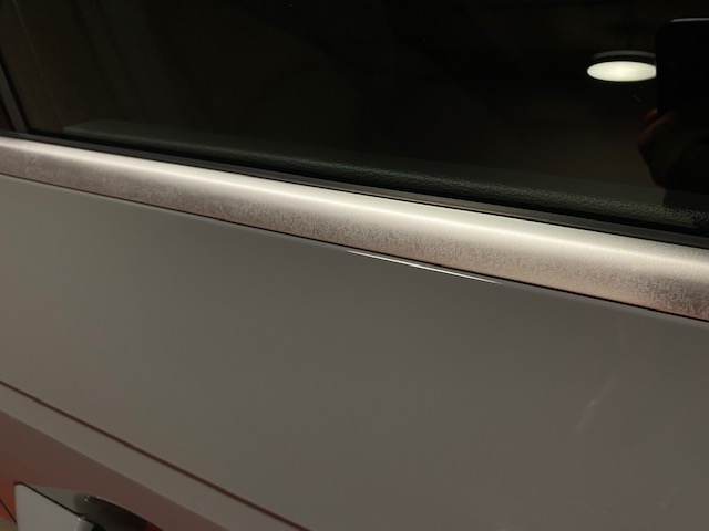

Dear fellow Audi RS enthusiasts,
I took delivery of my Audi RS4 B9 a few months ago and have enjoyed every mile so far!
However, on delivery I noticed some strange marks to the aluminium styling trim around the windows and roof rails.
I didn't think much of it at the time and thought it was just some water residue. I recently took the vehicle to be
detailed and ceramic coated and expected this residue to be removed however they informed me that it couldn't be cleaned off and didn't want to try using chemicals on it which could cause further damage.
So I've just taken my car to my local dealer hoping that they would fix this under warranty. However they declined it and said this is the responsibility of the dealership I bought the car from...
It would be helpful to know if anyone else has had similar issues with aluminium trim?
Any suggestions on how I should proceed would be appreciated too!
Please see photos attached

This issue has arisen in the Q3 Owners club forum recently - most likely when the car was cleaned when new for the PDI cleaning bay people in auto-pilot mode sprayed the car with the wheel cleaner which is a mild acid - hence the result. I had a similar issue on an A4 Cabrio a few years ago, the trims had to be replaced.

When I had my B7 RS4 new, I got bird crap on one of the aluminium trims and it created a stain that could never be removed. I think it’s quite normal for stains to occur on anodized aluminium. You need to take extra care.

This is a fault from manufacturer as the spots are under the clear coat and can't be buffed out
You need to get them to replace the trim
I had this on my B7 thats why i always go for the black pack on my cars
A friend had this on her merc on delivery and she wasn't happy when i pointed it out but she did get it changed under warrenty
