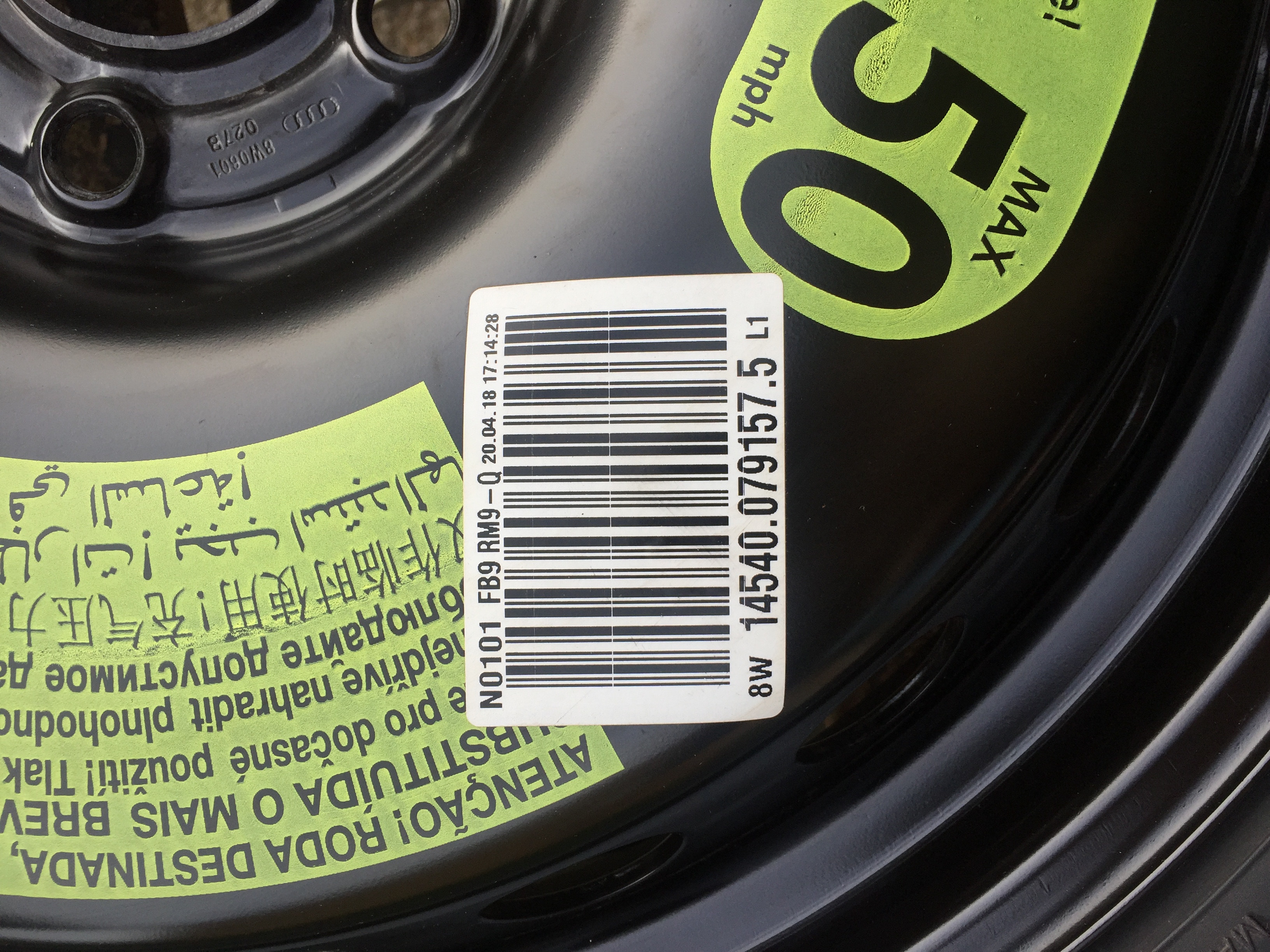

Can anyone point me to one or if not can anyone confirm that 8W14540.054402.7 is the part number?

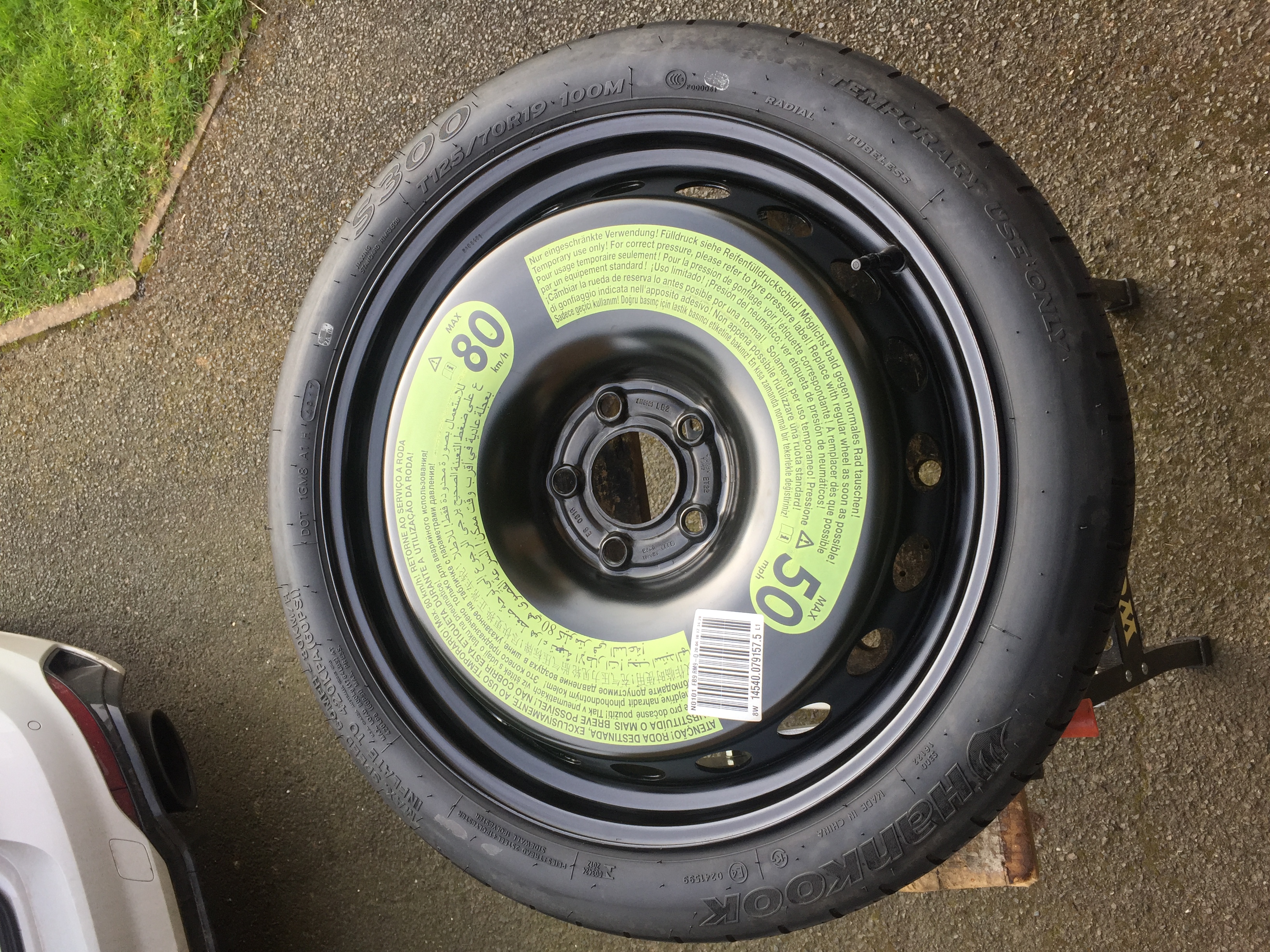

I'm lucky enough to own an 18 plate RS4 B9 in Sazuka Grey and it has a space saver wheel in the boot under the floor panel and I've had to use it twice so far once for a puncture by a nail :thumbsdown: the second by a sidewall pinched due to a pot hole :oops:
Any way see the images I have attached of my spare.
It fits on the front or rear of the car, I've have used in both locations. Just make sure it's the correct pressure, mine was low from Audi. Luckily I keep an electric tyre pump in my boot.

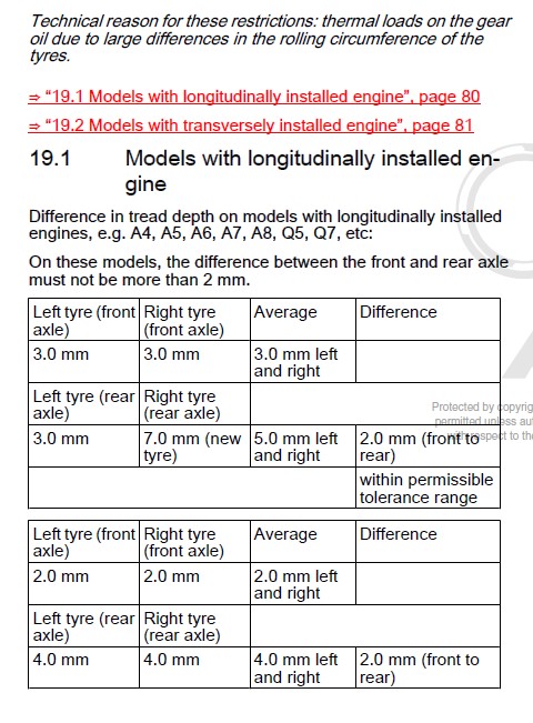

Try using tyre seal after a motorway blowout in the outside lane and your tyre is completely shredded. Ask the AA and RAC why they now carry loaner get you home tyres for their members?
I understand them putting tyre seal in even less when once you get to a tyre fitting center, because our tryes are not a common main stream size 90% of them won't have one in stock.
Also don't forget that the tyre tread depths have to be within limits as well or the torsional differences will cook your diff / gearbox oil apparently.

Cheers - ordered and in the boot, feel better for having one

My car came with a get you home wheel, so best ask Busa what he had to do.
The spare on mine fits under the floor panel around and over the sub base unit and is fixed with a big plastic screw thing that screws into the sub base unit to keep it in place while you drive around.

Thx for share.
Have noticed from photo that tire is 19".
Many B9's have been ordered w/20" wheels.
Any forum member know if there is a 20" tire option available for this spare rim?
Thx,

It shouldn’t make any difference, it’s the outer dia of the tyre that matters

20" wheels have a lower profile so the rolling circumference is the same, or close enough.

I have 275 30 20" wheels and rims on mine. The get you home spare rim maybe 19" but the sidewall is bigger so that takes it up to the equivilent 20".
I didn't have any problems when I had to use it except the TPMS bugging you ever time you start up.
