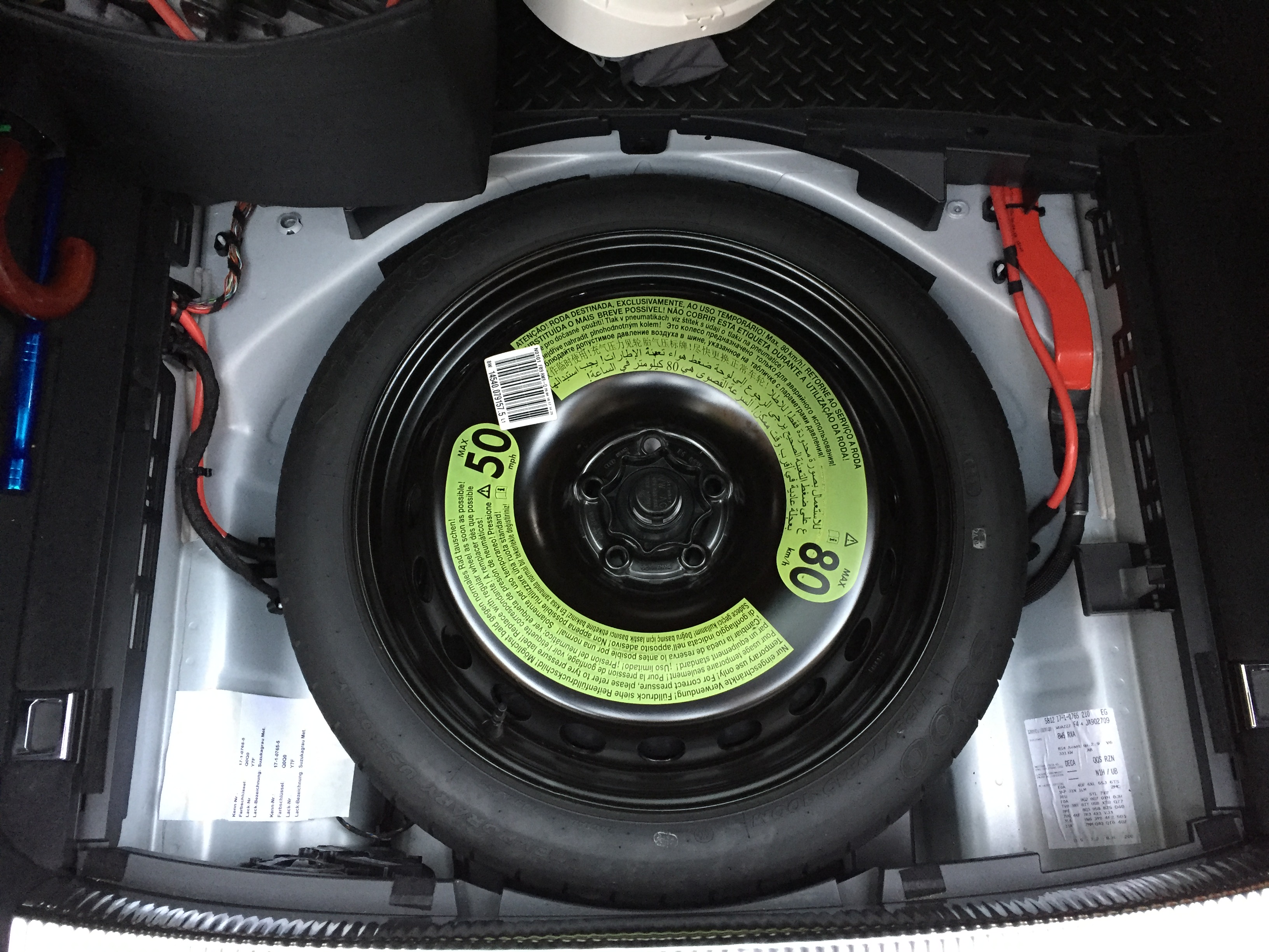

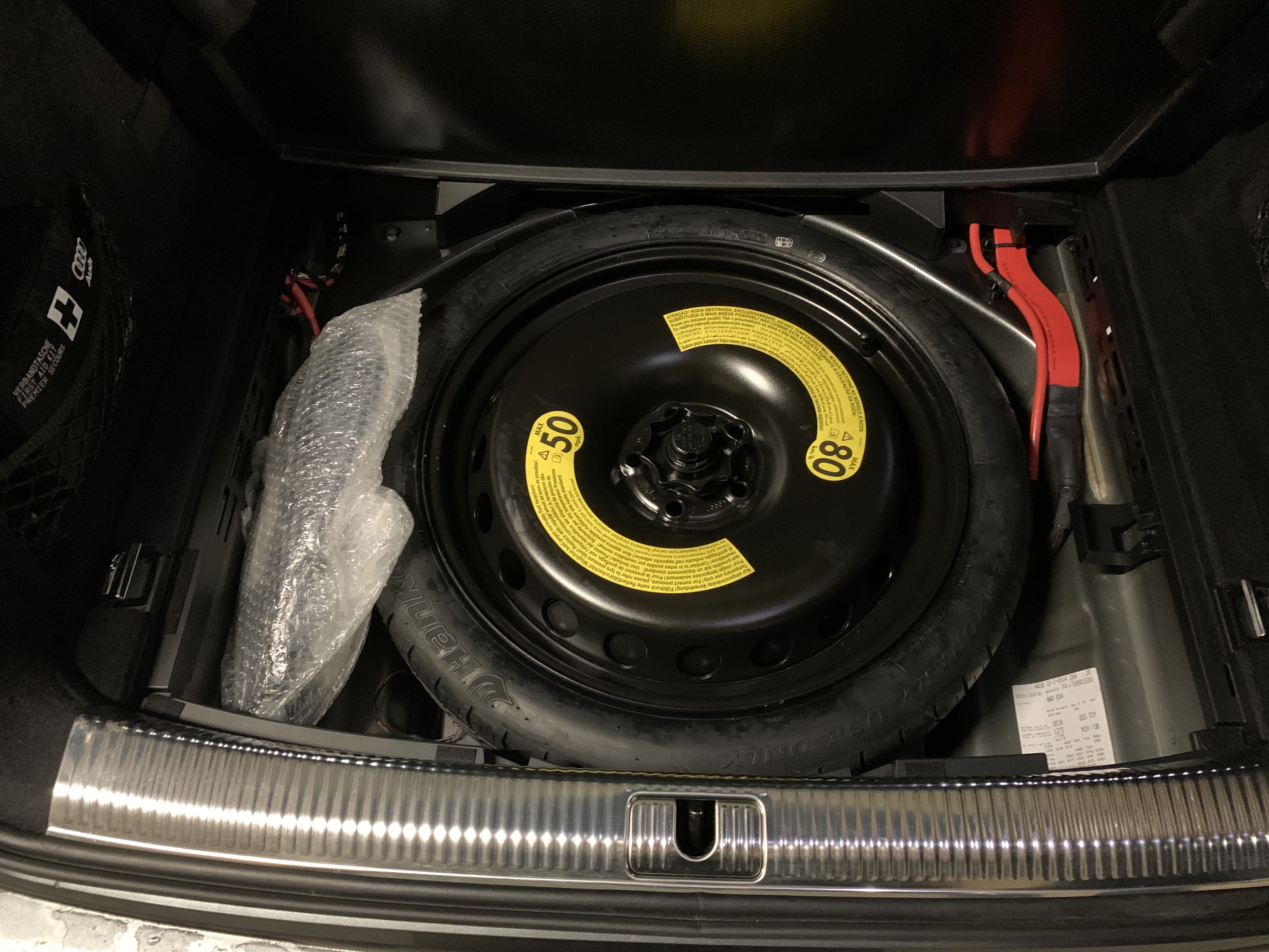

I’ve attached a couple of pictures of my boot with the spare in
I hope this helps

On all the photos above I cant seem to make out the audi part number? The part number is the one that is stamped onto the wheel near the bolt holes. Can anyone take a quick look and confirm the part number please and also list the other spec of the wheel that is stamped there like the ET number.
The only wheel I can seem to find is 8K0601027B with ET29 but I'm unsure if that's the correct one.

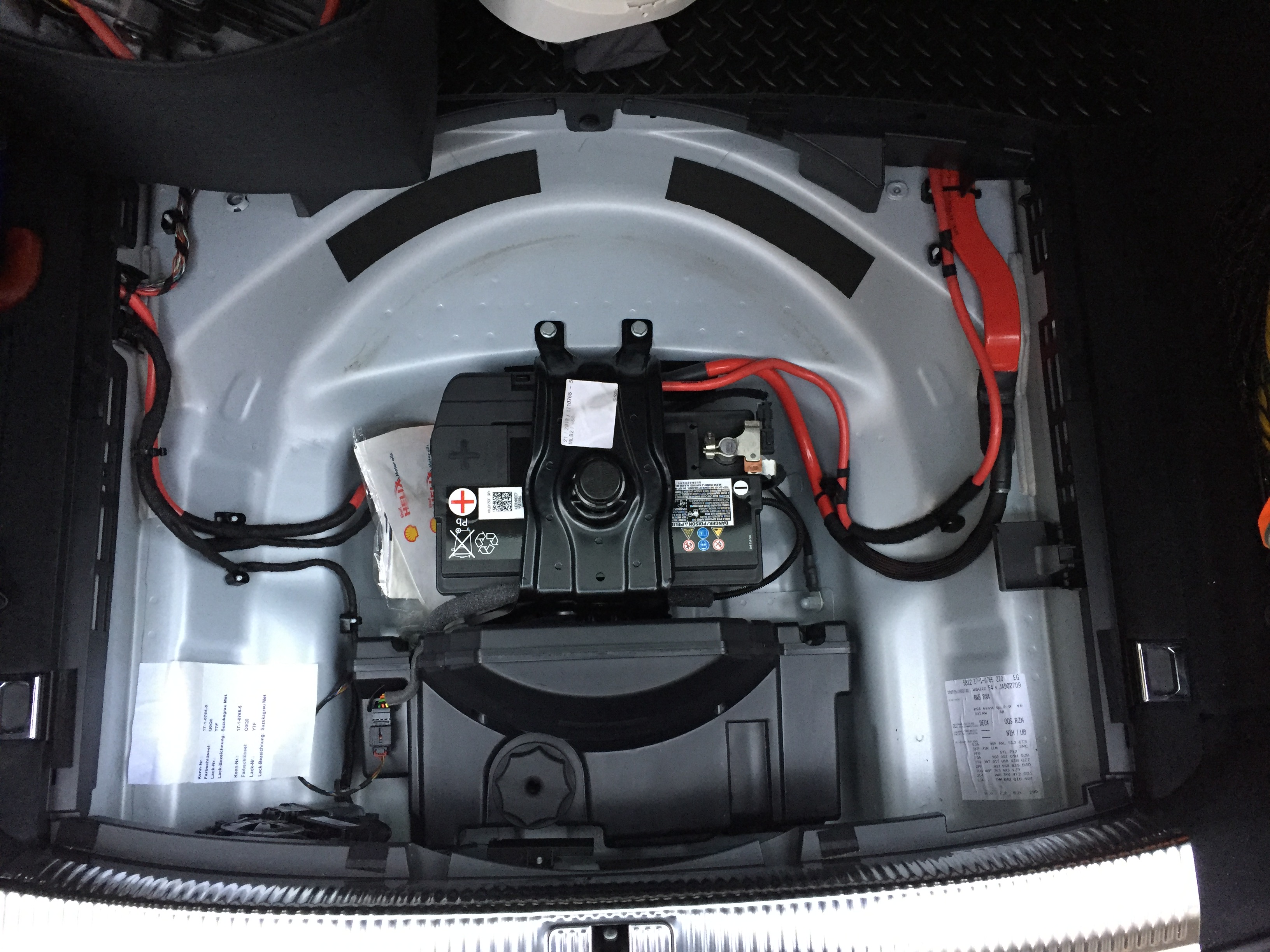

Thank you Jool, in the meanwhile I bought the spare wheel, and they installed it at the local Audi Dealer.
However, the mechanic has noticed that there is no compartment for storing tools such as the jack and the wrench which before were near the compresso/seal kit.
So they ordered a new component to store these tools, with a different shape so to replace the existing compartment between the rear seats and the spare wheel compartment.
But once arrived, it doesn't fit in the RS4 because the car has additional Electronic Control Units vs normal A4 in that space and they returned it.
So they want me to leave the tools going around in the spare wheel compartment.

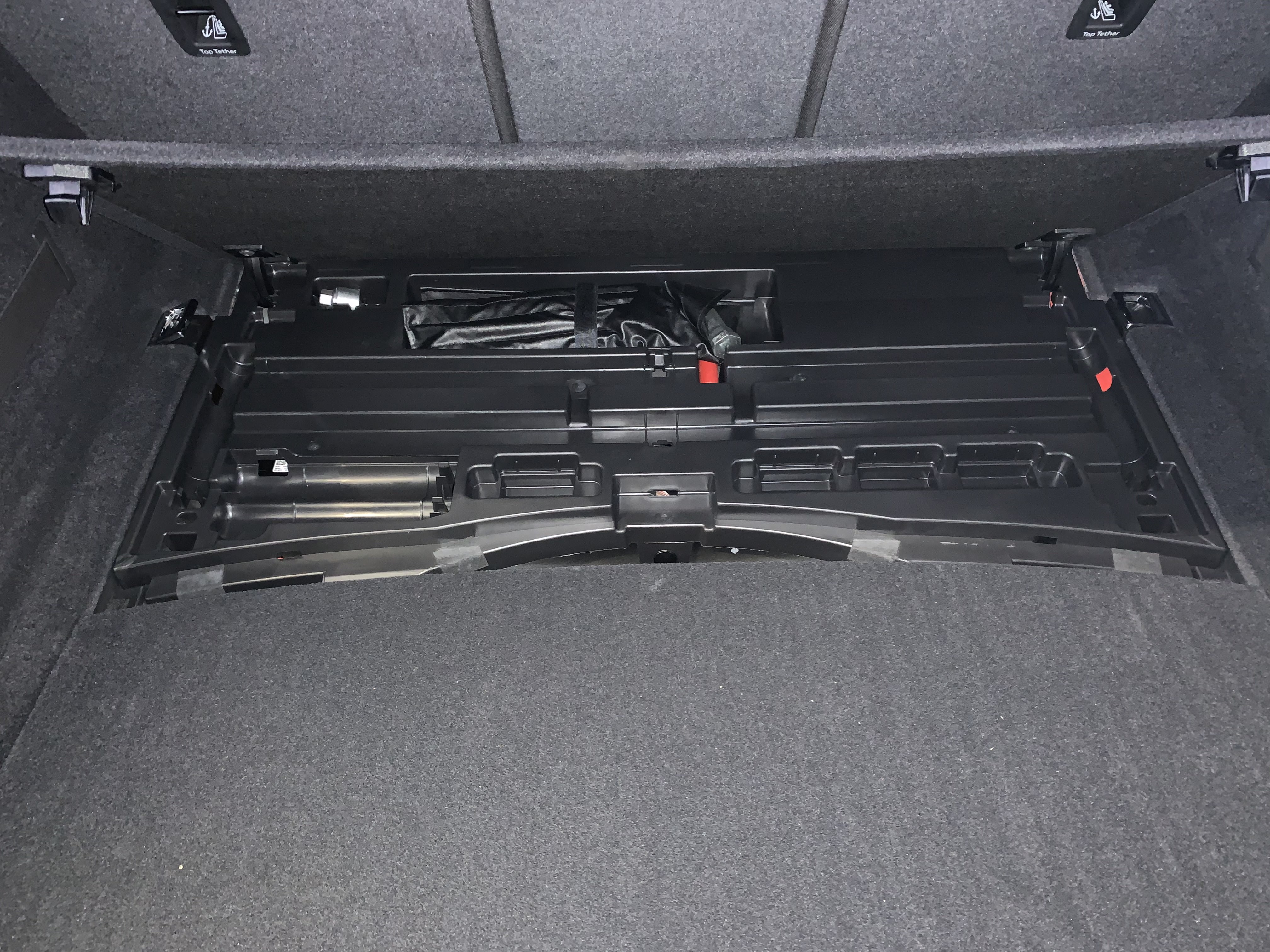

Can some of you from UK kindly share a picture of the other compartment, the one between rear seats and s.w. compartment, so to understand if it is effectively different from the one I already had and a detailed photo to understand how the tools are stored?
[attached my car as of now]
Thank you in advance.

I havent got photos but I bought a compartment from a pre face lift and tried to fit it myself. The dealer is right it will dot fit because of the control modules. I have my jack in the boot next to the spare wheel, like your photo. No other option really

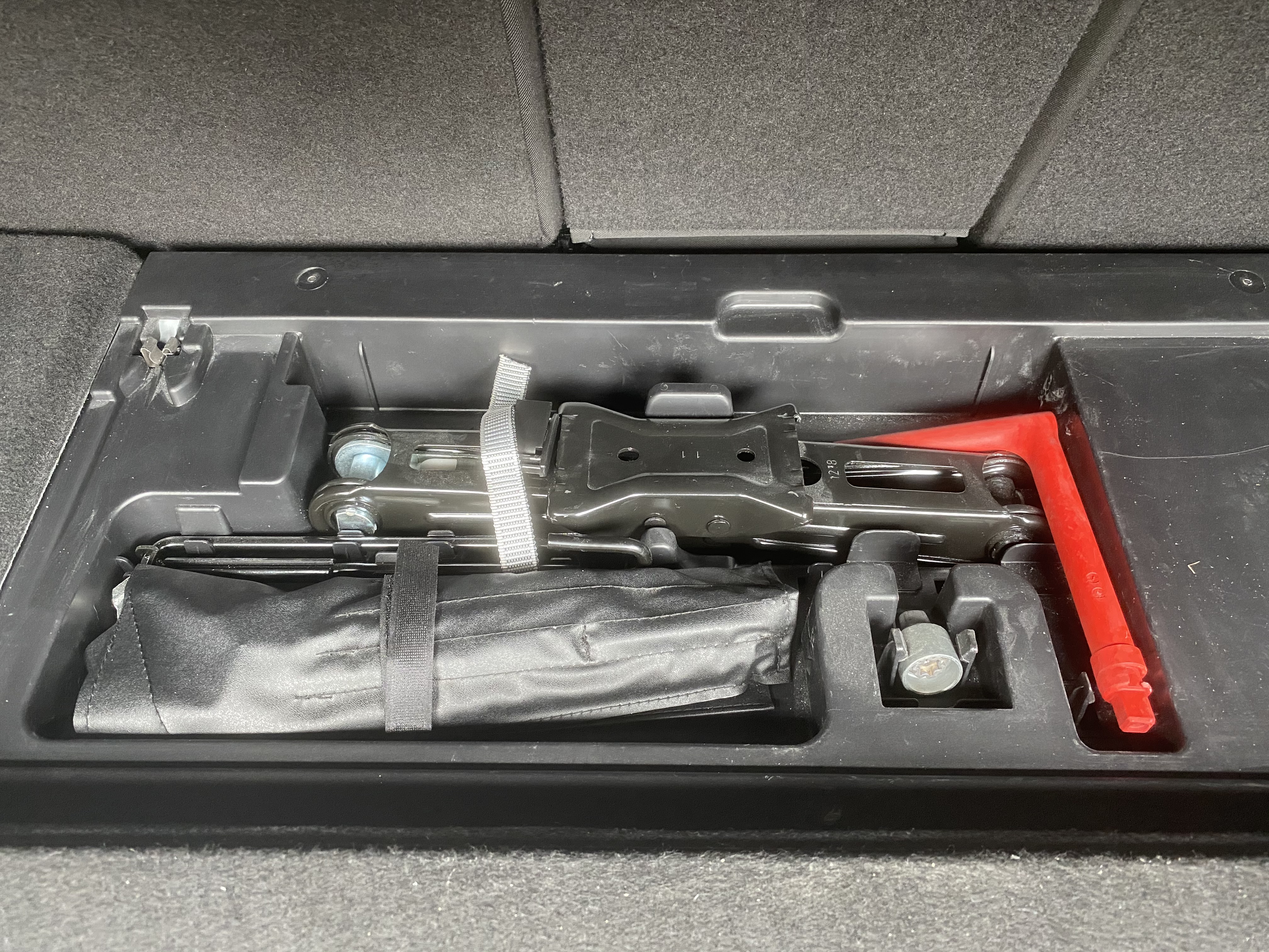

My dealer fitted a spare wheel to my 2020
B9 RS4. He also tried to fit the difference tool tray to hold the jack / crank etc & couldn’t due to some parts under it. So they left the tray my car came with.
Re the crank / jack. He noticed there was a bag option for the jack / crank. It has a cabana clip. With the crank / jack in the bag we fitted it behind the right hand side recess. That’s the one which has some netting. There a small clip you turn & recess & netting open up. Behind is quite a large hole / recess. We hooked the cabana from the bag onto a hole & the jack / crank fits neatly in there. It’s almost like it’s made for it.

Hi, sorry for a delayed reply. I only just noticed the question.
The part no is 80A862985A
On my receipt it says list price £52.76 which is expensive for what it is.
Here’s a pic of it. I have also attached the collapsible chocks bag. Which was another option I bought.

Hi my dealer also got a different tray from Germany but like you it wouldn’t fit. My car Image a Sept 2020 RS4 B9.5 Vorsprung. My car didn’t come with a spare wheel. I don’t think any of the 2020 B9.5’s do.
Plus I don’t think there is tray that fits our car. That’s what my UK dealer said.
You can still fit the wrench & locking nut in the tray that came with the car. That comes in the pouch,
Then fit a spare wheel & store the jack & crank behind the right hand storage housing as per my earlier pics
