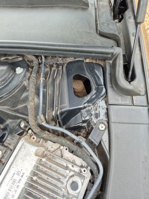

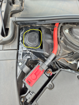

Does anybody happen to know the Audi part number for the nearside rubber gromet that fits into the hole on the top of the front strut tower for a B9.5 RS4 please?
I opened the bonnet over the weekend and noticed the nearside gromet is missing and splattering the engine bay with mud so I would like to replace it. Photos of offside (gromet present and circled in yellow) and nearside (gromet missing) below.

Check out 8W0803593, it looks right.
If you pop the one you've still got out.
a. Does it fit the other side?
b. If it does, I think the part number may be on the underside which you can double check against.
c. If it is the same, put the part number in google search. There seem to be several resellers out there.
I hope this helps you

Thanks, Jools. Spot on! I'm embarrased to admit I didn't think to look on the underside for a part number but it is the one you quoted and the gromet does fit both apertures. I'll get one ordered.
Thanks again for your help, Ian
