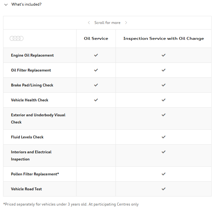

Having just used the two services in my service plan, I've been going through the same process myself. It's not easy. I did come across a page on the Audi UK website for fixed-price servicing for cars 3+ years old. Enter your car's registration and it shows local dealer pricing for an oil change or an oil change/inspection service.
https://www.audi.co.uk/uk/web/en/owners ... ing.html#/
Click on the What's included link to see what's provided in each service (screenshot below). At the bottom of the page, click Services to include optional items such as replacing air filters, brake fluid, spark plugs, etc in the quote.
That may help you decide whether it's cost effective to buy a service plan (discounted until Dec 8th).
