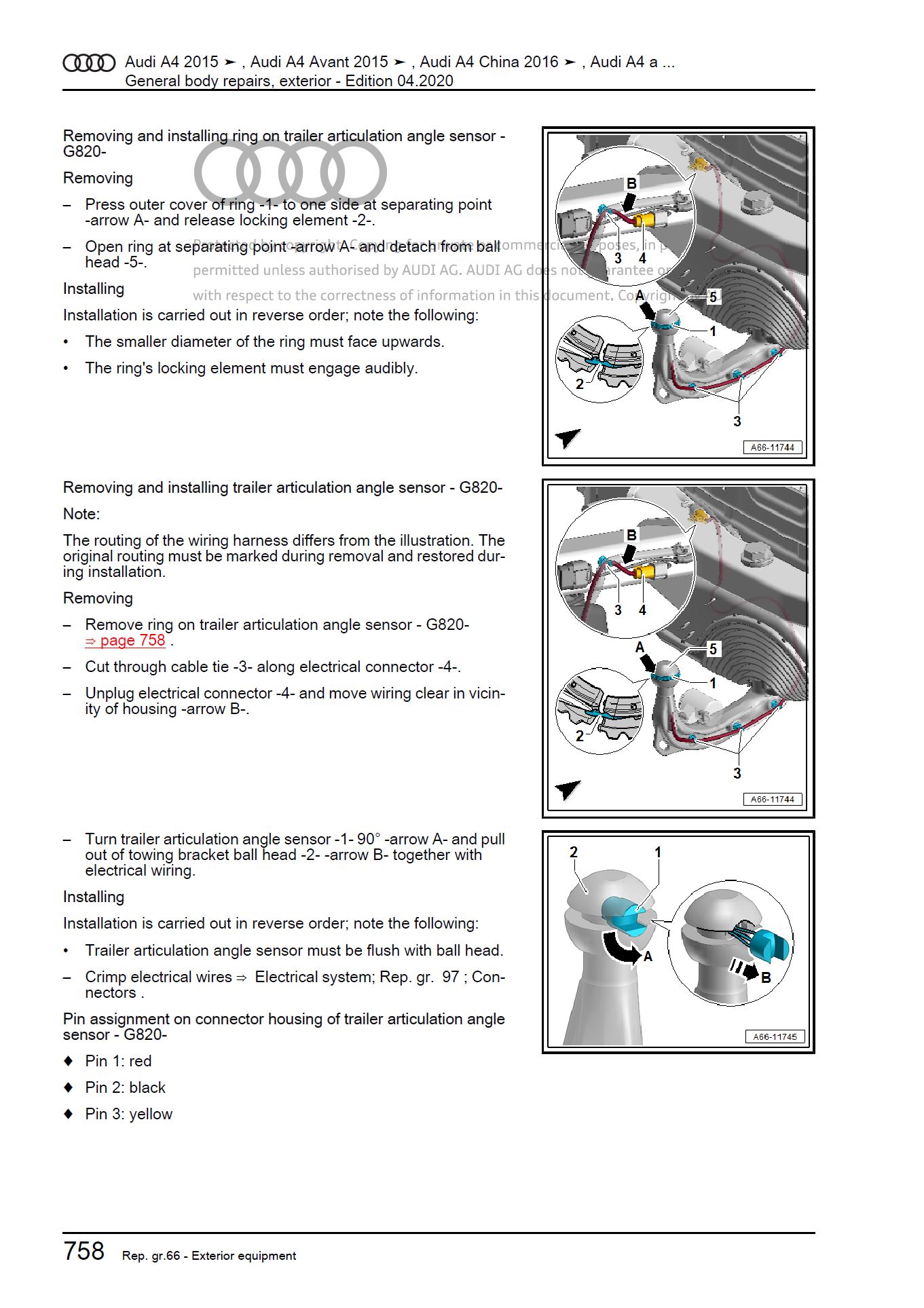

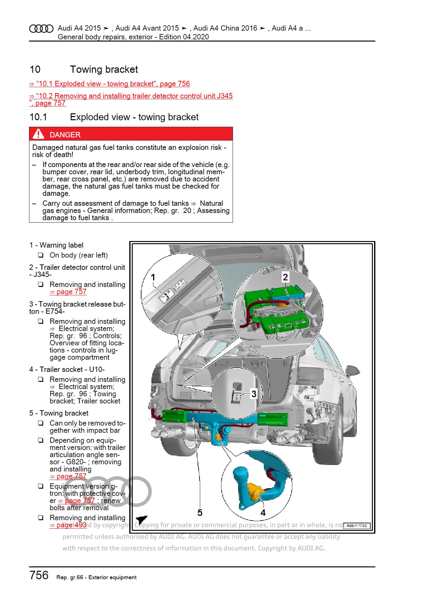

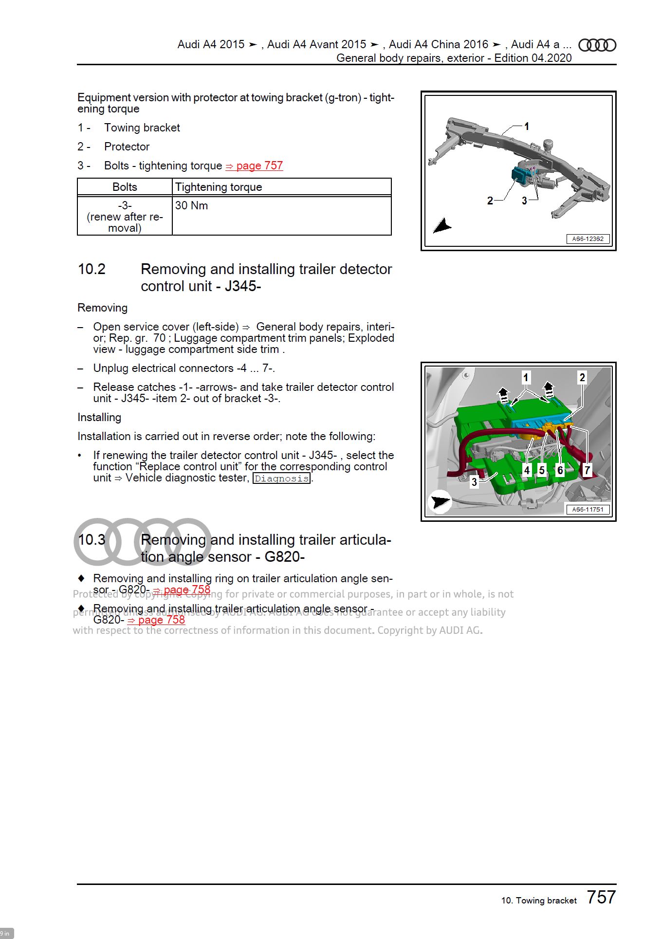

applecrate I've attched a few pages from the Audi manual about the towing bracket and electronics.
I found an A6 towbar retrofit pdf which maybe similar.
I've also got the electrical wiring diagrams as well if that's any use to you.
Towbar Retrofit EBA_4K0055204_en_180613.pdf
(1.06 MiB) Downloaded 54 times
