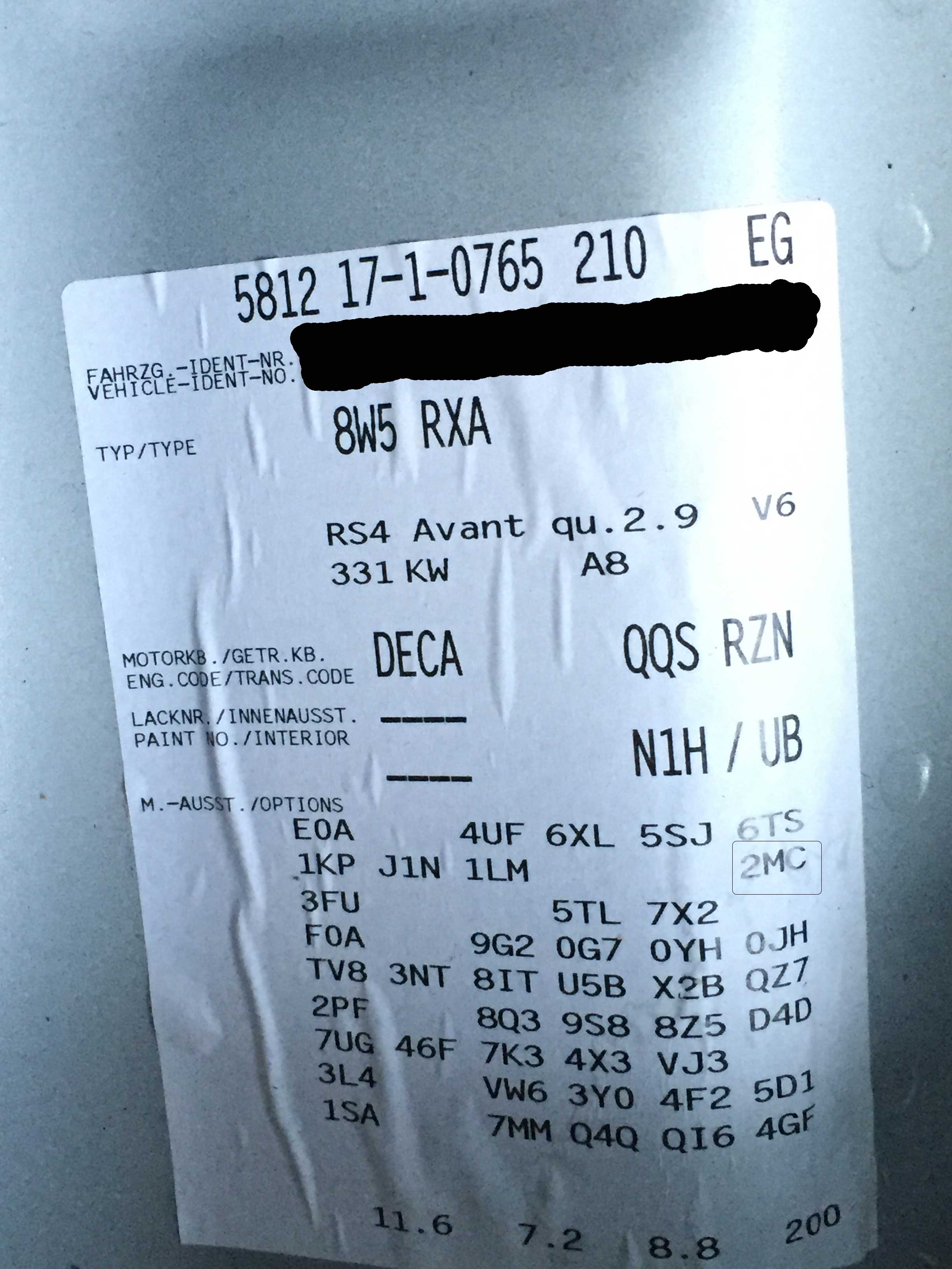

How would you identify a DECA engine?
2018 RS4 B9 Carbon Edition
2014 RS4 B8
2014 RS4 B8
Re: Wheel wobble not what you think!
To my knowledge all B9 & B9.5 6V twin turbo RS4's are DECA engines.
Check your build label found either in your handbook or in the boot under the floor tray.

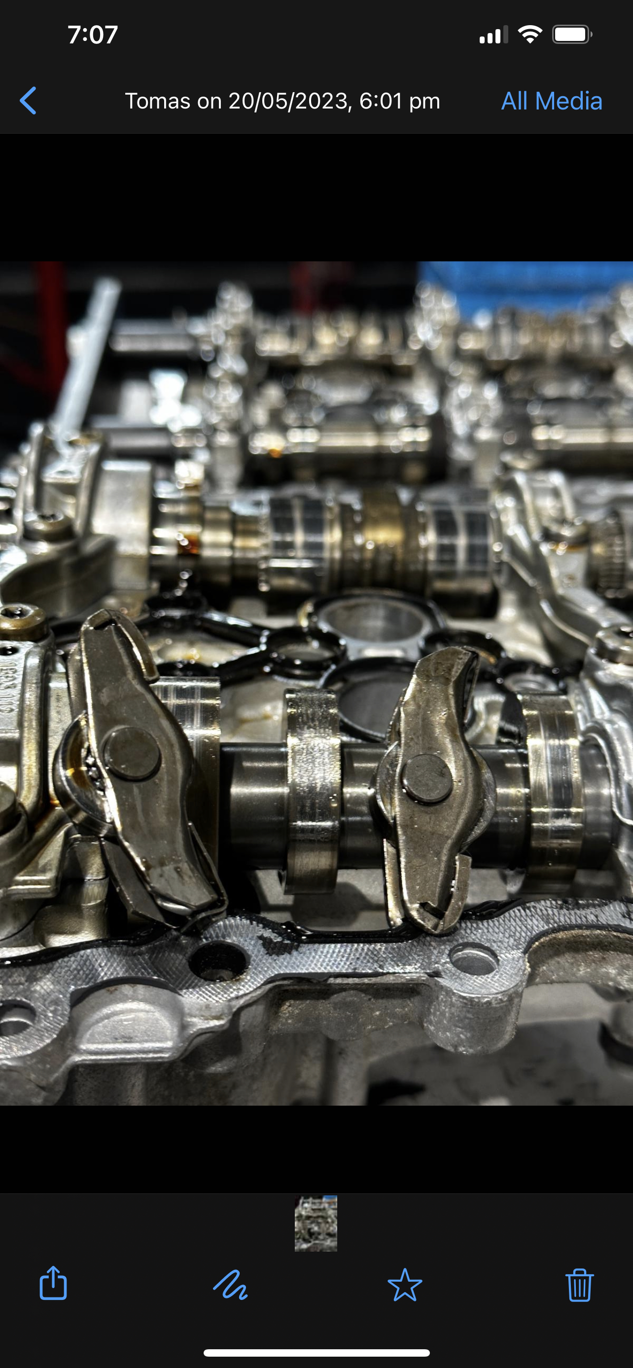

The pre 2019 engines were fitted with the old 'chocolate' rocker arms, I don't have exact build dates but you can check by using an endoscope down the oil filler cap and looking towards the front of the car. With enough fiddling you can see one of the rockers.
I think that the bad rocker arms aren't only used in the DECA engines so there may be others out there with a ticking time bomb ready to go off. I was lucky, if you call it that, a needle roller collapsed and stopped the outer race turning, scouring the cam lobe but the bearing stayed in one piece.
The bad rockers use small diameter needle rollers, the outer race expands and allows them to make a break for it where they usually end up spread around the head and on occasion in the sump!
The updated rockers use fewer larger diameter needle rollers that to date seem to be OK.
There are several YouTube videos on it.
The picture below shows an old, but still good rocker arm on the left and the collapsed one on the right. You can see how the outer race is offset to the central pin. The cam lobe between them is the one that was scoured.

As mine is a 2018 plate I had the chocolate rocker arms fitted which had to be replaced (not under warranty) chough69000 mile mark!
Collapsed rocker arm bearing and a scoured cam the result.

So obviously I do have a DECA engine… having looked on the production label. I’ve also looked at a few YouTube videos on the early rocker arm issue that makes grim viewing.

If you ask Audi they should be able to tell you what type of rocker arms you have on your engine following back the info on the build record
Worth a try
Worth a try
