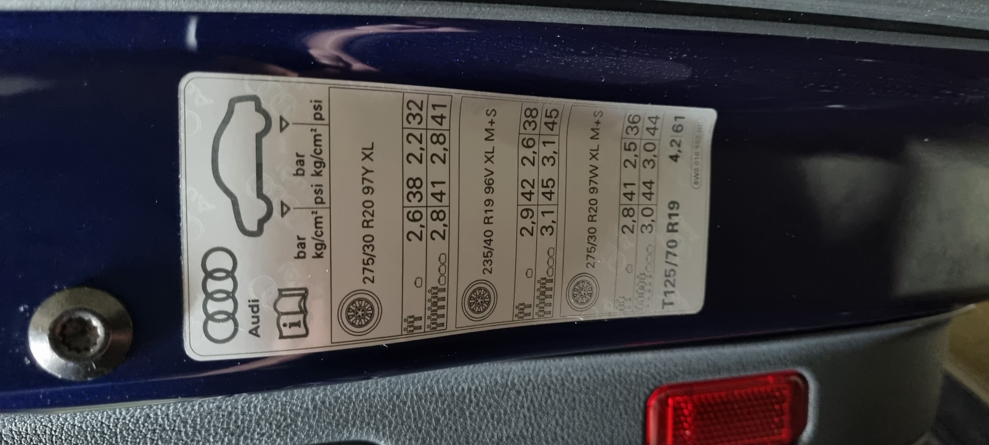

Audi place a Sticker on the end of the passenger front door I recall - with the recommended pressures. For my current RSQ3 I run the same pressures all round @ 36 PSI.

If your running 20" 275s it's 38 psi front 32psi rear
41 psi front and rear for a fully laden car
I run mine on the 38 / 32 with no issues my car is on DRC
