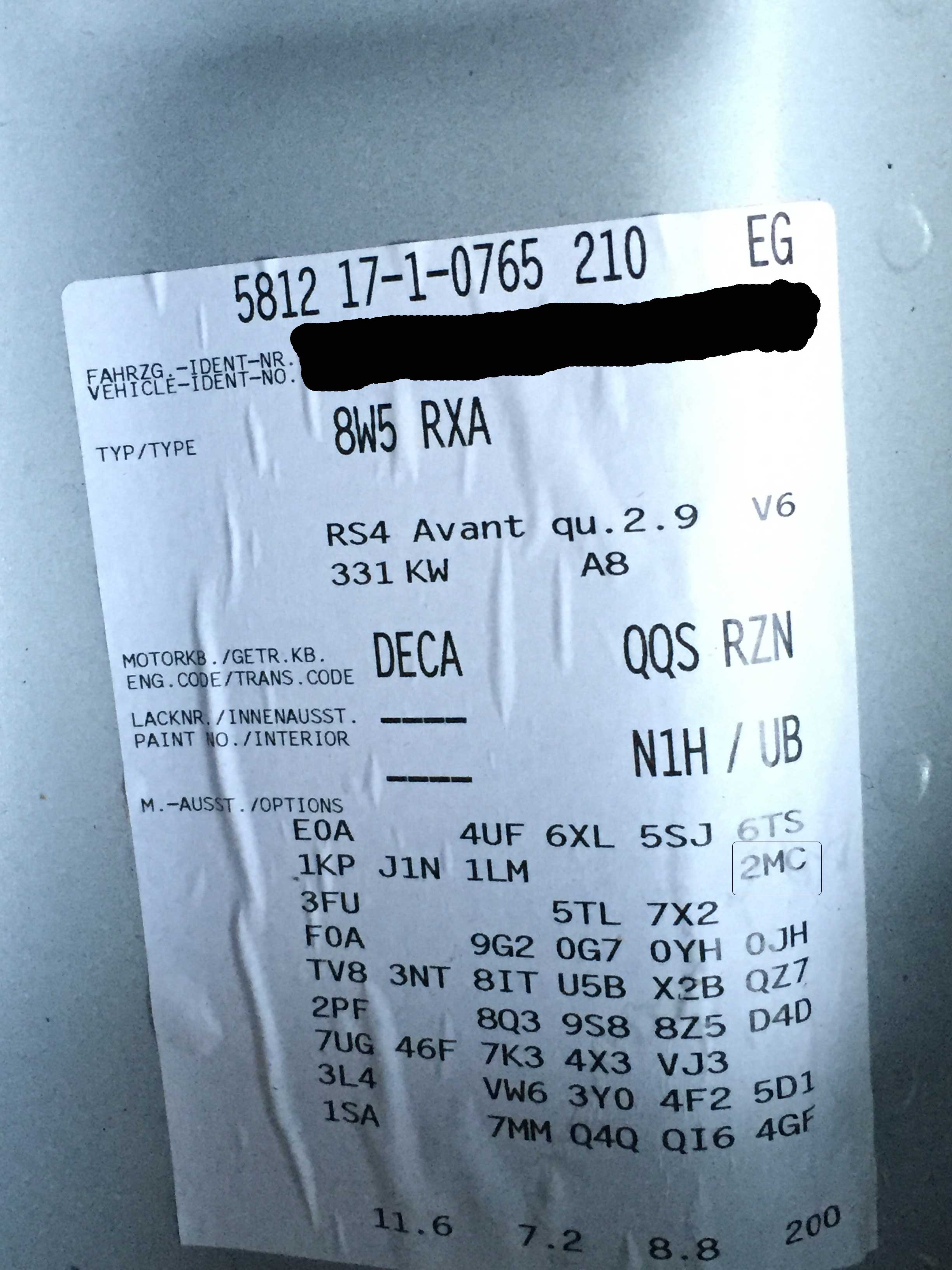

I have attached several images one of my VIN Sticker, the bit I think that refers to DRC is the 2MC on the far right column, second row down which translates as 'Sports suspension with variable shock absorption'

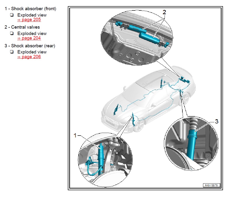

The second from the Audi workshop manual DRC section showing an overview of the system. I think a retro fit would be cost prohibitive unless you could get stuff from a written off one, but then there will be the control wiring and control module. I tried to take a few images of the various bits of kit on the actual car but there always seems to be too much in the way and I couldn't get the lighting quite right.

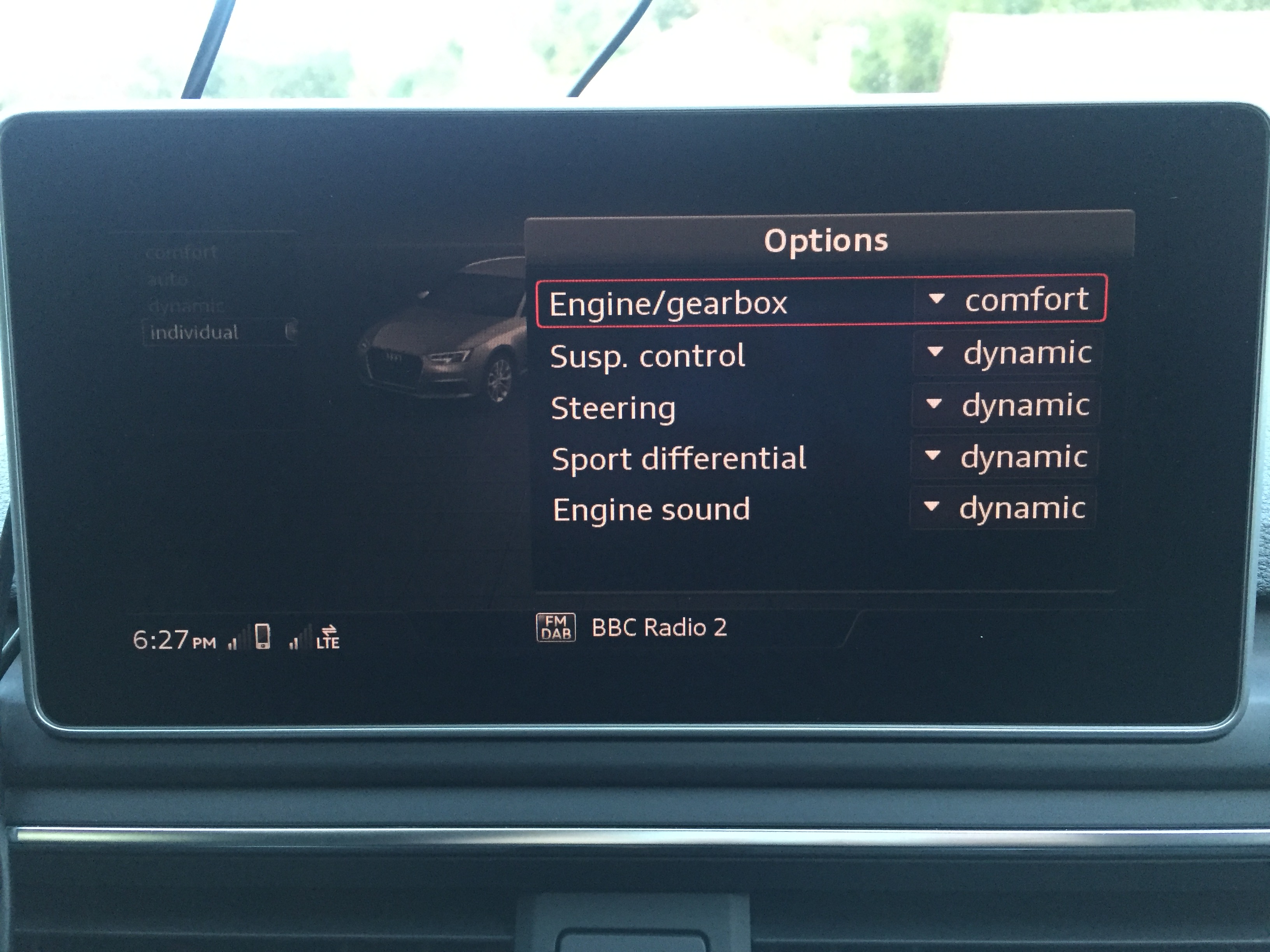

The third of my central display in drive select indiviual mode. The second option down shows Suspension Control which you can select between comfort, auto or dynamic. As I haven't seen this display in a NON-DRC car I can't say hand on heart this menu option doesn't appear in an RS without DRC fitted.
