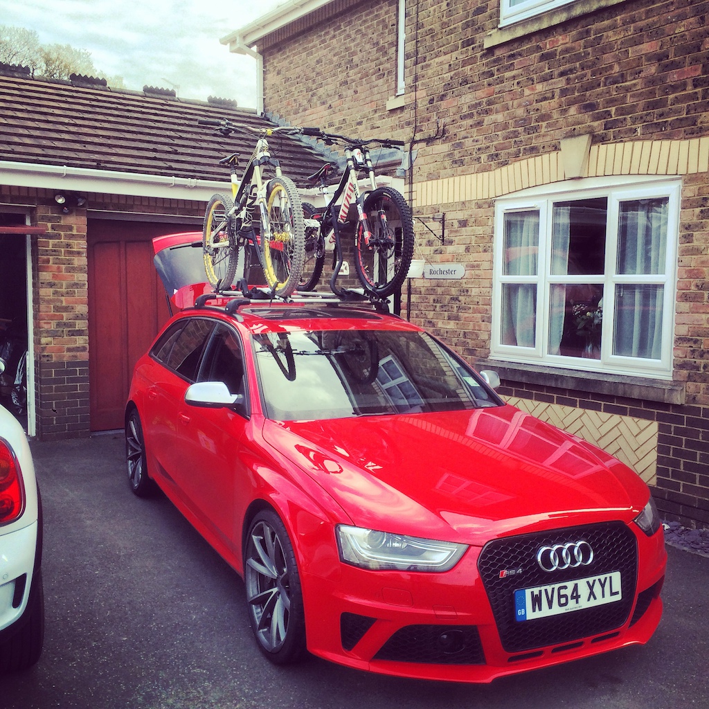

I haven't got around to fitting them on my B9 yet (even though I've had it nearly 2 years), but I've always used the Thule wing bar roof racks with 591 bike carriers
The audi ones look crap as they protrude over the edges and look pretty industrial, whereas the Wing bar ones look decent if left on the car (Mine stayed on my B8 for nearly 4 years)

Yeah, it's mine.
The towbar neck is detachable, lives in the boot in a bag. You wouldn't know there was a towbar fitted once the neck is off.
On mine the carbon diffuser was pre-cut underneath from the factory. I'm assuming that all RS4's with standard suspension would be the same. Cars with DRC can't have a towbar fitted.
There's loads more pictures on the Facebook link in my previous post.
Towbar Express is my company. We don't list them as fitting the RS4 on our website, but the standard A4 bar fits. Quite honestly the neck sits a bit close to the RS4 bumper, so we didn't want to fit them for Joe Public, because we could see issues with people damaging the bumper and blaming us.
Having said that, I use it with a Thule Cycle Carrier, and I've had my dads caravan on it once, just got to be a bit careful.
For anyone planning on doing this themselves, you need a Brink towbar, part number 610900, it's the only one that comes trough the pre-cut hole without any extra cutting.
