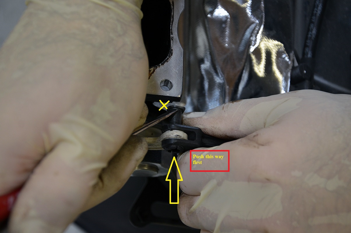

I followed that guide and it went smoothly, but here is some advice:
In step 8 linked below, when removing the plastic dowels\pins that the linkage arms are connected to. The image shows the guy prising it out with a screwdriver. Don’t do this. “Push” them through from the other smaller side, rather than attempt to “pull” them out from the other flat\larger side. The plastic is brittle, and you will break them. Once unclicked and pushed free, then you can pull them out from behind.
https://blog.034motorsport.com/wp-conte ... step_8.jpg Here is an image of the shafts and the plastic arms. The circular silver thing is a cap that goes on one end of one of the shafts in the manifold.

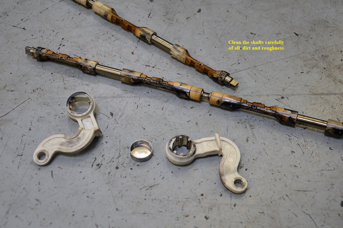

NOTE: The shafts have rubber seals at each end. Don’t lose them and note their orientation for refit. I took pictures along the way so I wouldn’t forget.
These shafts need to be carefully cleaned and all the crud removed from them. I used a scotch pad on some places and brake cleaner. Remove any roughness from the Nylon sections too.
Here are the screws and the flaps after removal and proper cleaning. I soaked them in an oven cleaner chemical overnight. It was a mission. A shot blasting box could have been quicker.

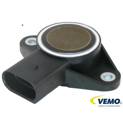

I also replaced both Manifold Flap Position sensors just for completeness. Vemo part number V10-72-1279 are the same part as OEM but with the Audi detail rubbed off. As well I replaced the one-way Vacuum valve that sits under the manifold itself. You can see it here the black and white valve.

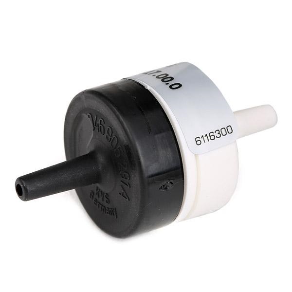

Pierburg Valve Part Number 7.05817.00.0 is the same part as the OEM one. Then onto cleaning the actual manifold itself.
