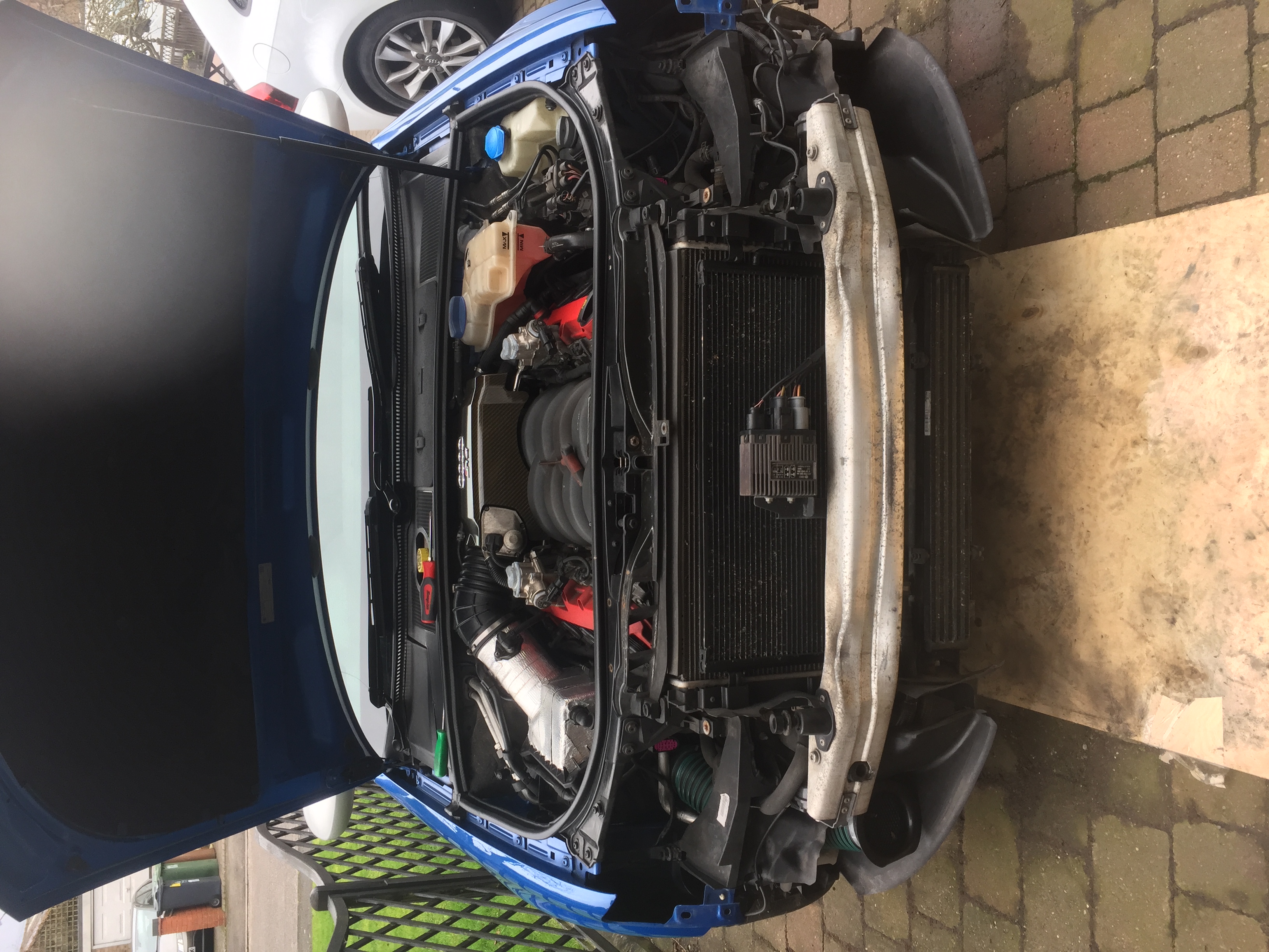

Lads i have started
Not done to much as the weather is crap an isn't enough room in the garage! Hoping to do more tomorrow. So..so far i have striped the front end, there is more to our front end then first thought, in the tts manual it says leave the front end attached via power steering pipes an oil cooler pipes but im not doing that i am hoping to take that all off just to make life easier an not leaning over it all to remove mainfold. This is what it looks like now.

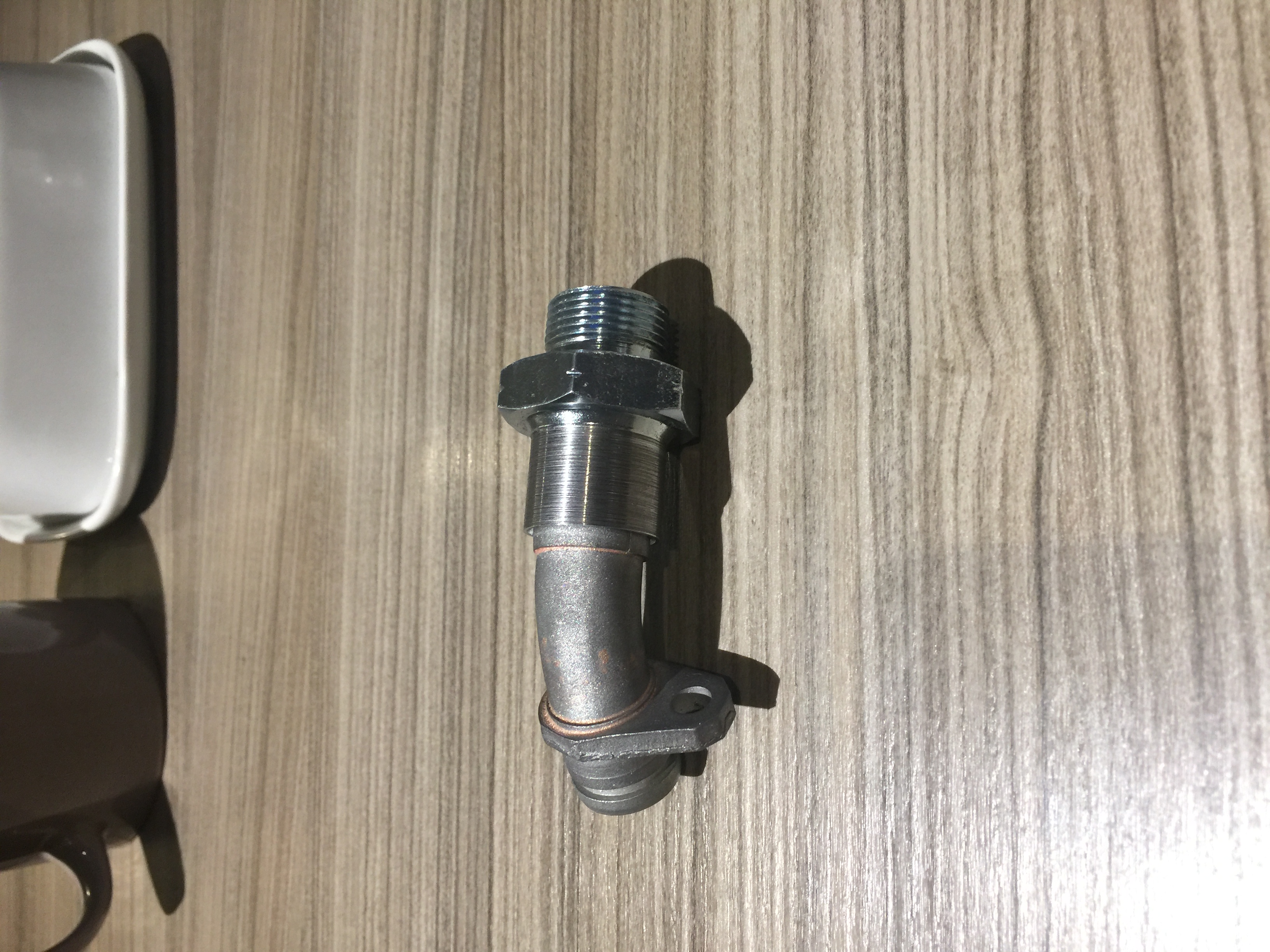

Ok, so i have had a few problems but nothing i didnt expect, as said above i wanted to remove the front panel completely an also wanted to change the oil cooler lines while there. Well i took the oilcooler to work to try get the pipes off with all types of methods to save the cooler but no luck, just strips the threads off. Soo am in need of a cooler and lines but i refuse to pay audi prices.
Been in the trade an also having a hose company at my work i have come up with a plan. More to come on that once all sorted, the picture of the fitting is something im thinking about as thats the bit that goes on to the engine least then can have hoses made easier due to no special ends.

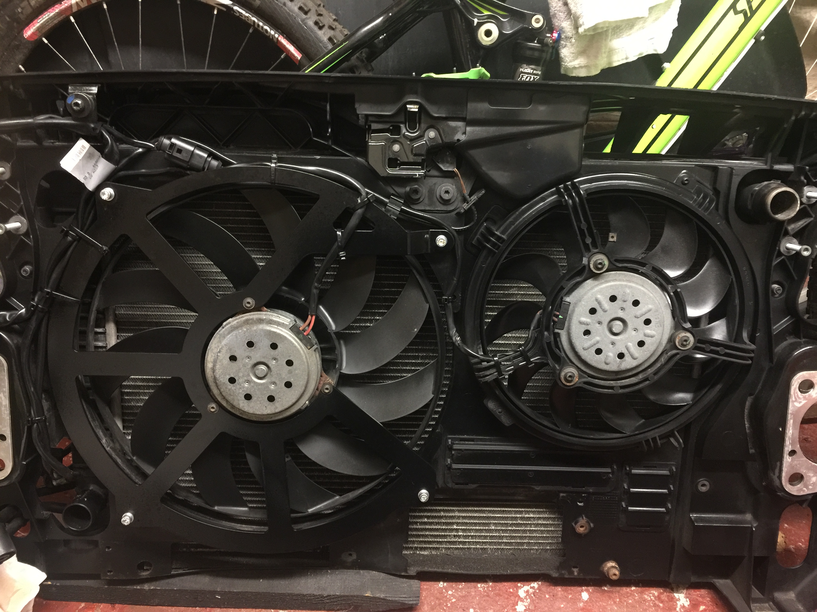

But on the rad pack i have gave it a bit of a clean up an fitted the new large fan cowling and bolts from tts and re-routed some wiring to make room for the extra pulleys.

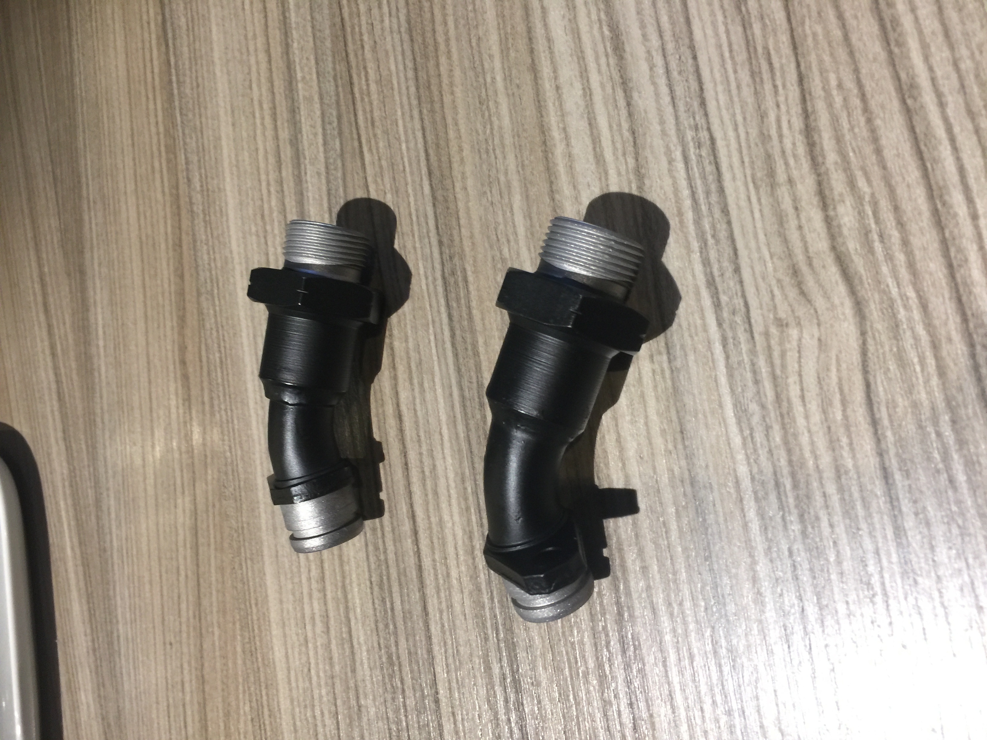

So i made these today
This is the start of the oil cooler pipe mod im doing.

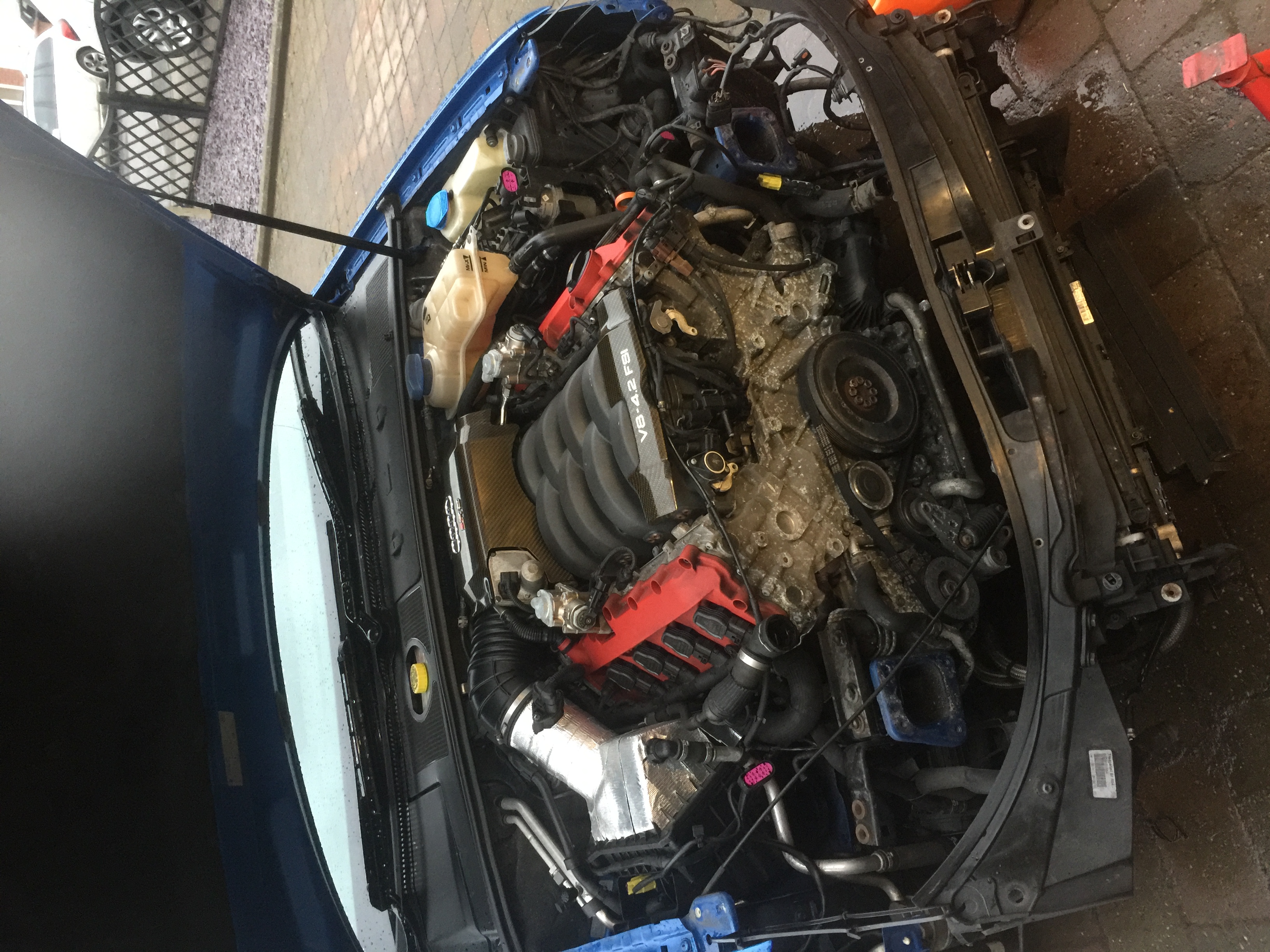

Today i removed the inlet manifold an the other bits an bobs to get ready to install the new stuff.
