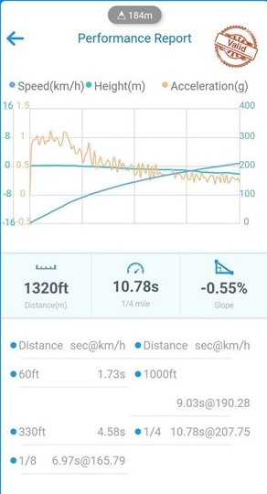

https://www.autotrader.co.uk/car-detail ... 2190651411IanH755 wrote: ↑Sun Oct 17, 2021 3:23 pmI did a Dragy run and you actually see this happen in the acceleration graph - there's a little spike at launch followed by a dip as the car bogs, then a massive dip at 1st-2nd gear change (it just stops accelerating shown as the line dropping back to 0g) and then it takes 0.25 to 0.5sec to get back to full acceleration. I'm quite impressed by the Dragy's plotting software TBH as it makes describing what I "feel" during the event much easier to understand with a visual line to point at.
Most of the speeds and time are almost (or exactly) the same as previous so thats pretty consistent between runs using different devices, which is nice.
That's an interesting chart Ian, and makes a revealing comparison with a modified S8 that's come up for sale on Autotrader. That car has upgraded turbos, 1100Nm torque (similar), 800bhp (rather less) and probably weighs about the same. But of course it has the 8 speed gearbox. Although it's slightly slower to 200kmh, the launch is better, maintaining close to 1g acceleration from standstill through to second gear, then tails away gradually with little interruption from gearshifts. It's not often you get information like this to show what's going on.
Nick
Re: IanH's C6 RS6 900+ spec - Updated 15 Oct 21
The C6's 6 speed ZF box changes gear in approx 300ms and the newer ZF 8 speed does it around 150-200ms and that difference really shows looking at the smoothness of that S8 graph compared to mine. Plus that extra time spent during gear changes on the older box will slightly add to the overall time so, for the 10.78sec @ 129mph run above - ZF6 uses 4 changes to reach 129mph = 1.2sec approx vs ZF8 using 5 changes to reach 129mpg= 750ms to 1.0sec.
