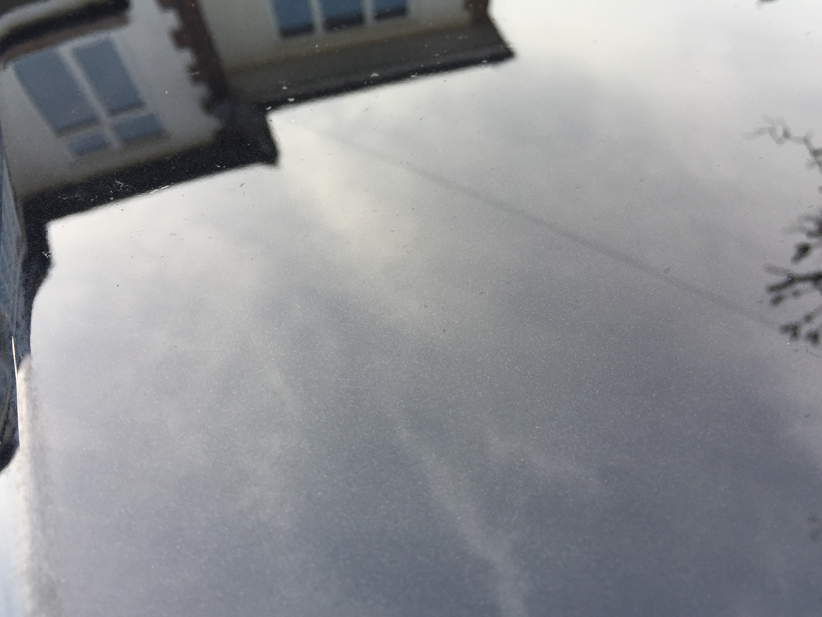

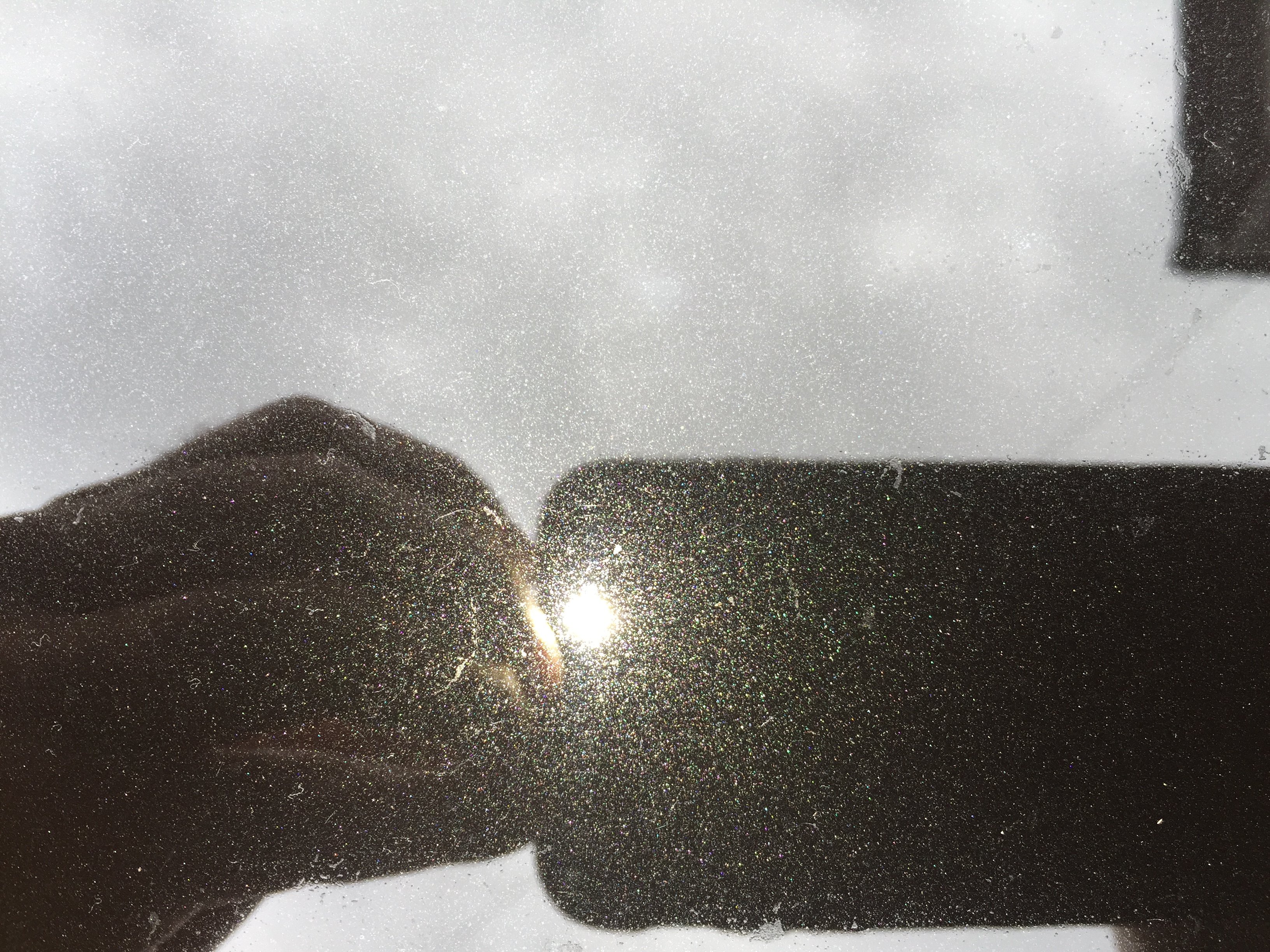

Pollen - It's a b*stard. Be warned.
So, after a recent week away, where the car was parked in a forest for a week, I noticed lots of fine flecks in the paint. Only visible close up, and very difficult to photograph. They were on the car in the recent reflection shots I posted, for example, but can't be seen in the photos. They're visible in this closeup pic (see the reflection of the house):
And this pic with the flash makes them look worse than they actually are:
I had assumed it was just surface contamination, and I'd be able to remove it easily. For example tree sap, which can just be removed with clay - wrong.
I emailed G-Techniq and got some advice from their MD Rob, so over the weekend I had a go at removing the imperfections, just on the spoiler. After a wash, I tried some detailing clay. It did take off some contaminants, but the marks were still there. Then, following Rob's advice, I tried a light polish - white hex pad, little to no pressure. No effect. Then I upped the ante, with a heavy cutting red pad, wolfgang tsr polish, and a bit of pressure. This made a definite improvement, but the marks are still there (although you have to be very close to the car to see them.) I stopped there, feeling completely gutted.
I concluded that the actual EXO coating might be damaged, rather than something on top of it. I think the pollen, which can be acidic, has actually etched the coating. I didn't realise such a thing could happen!
I've exchanged a number of emails now with Rob, and spoken to KDS (where the coating was applied). They both say that pollen can absolutely cause damage to paintwork, and to the EXO coating. The crystal serum below should be much more resistant.
Next steps are that I'll be taking the car into KDS for them to have a look in the coming days, and we'll come up with a plan.
Bloody trees.

Sad times Faisal, I did not know that pollen could be this damaging, I always try and park away from any tree for fear of sap contamination but it's not always possible.
Full detail/paint correction coming up?

Me either! I thought I'd have to clay the car after a week parked in a forest, but never saw this coming!daytonamart wrote:Sad times Faisal, I did not know that pollen could be this damaging, I always try and park away from any tree for fear of sap contamination but it's not always possible.
I think a paint correction will indeed be needed. I should know more tomorrow after KDS take a look. GTechniq have offered to pay for half of the work at KDS, and want me to trial a new version of EXO which they say is more resistant to stains etc.

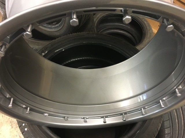

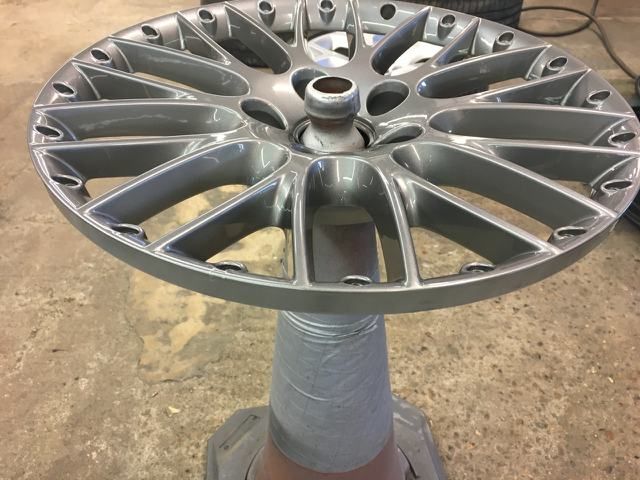

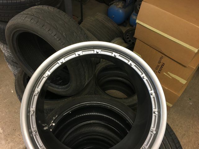

In better news, just got these pics of my "diesel s-line" 20"x10" speedlines from my wheel guy. Can't wait to get these on the car!
Already swapped the wing mirrors over for titanium ones (my original silver ones for sale in the classifieds).
