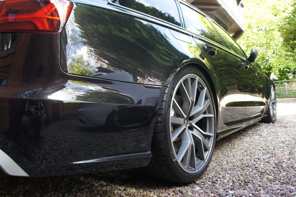

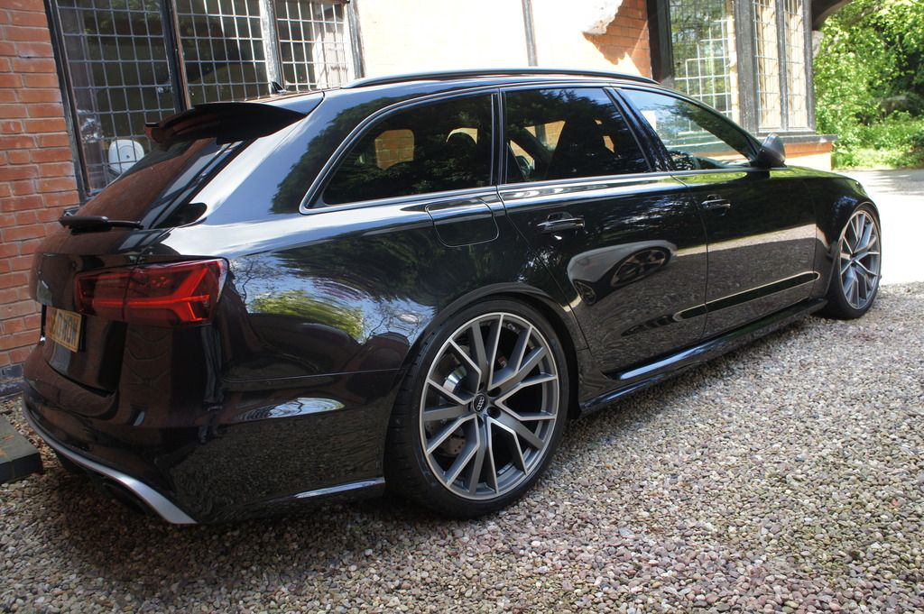

Anyway, here's some photos from this morning:

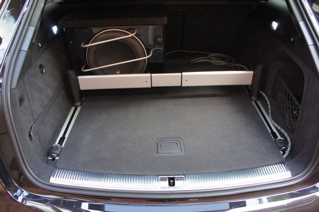

Earlier in the week I added an amp and sub to the boot. Makes a huge difference. And because it is an avant rather than a sealed boot of of a saloon the gain on the amp had to be turned right down (have no sepearate sub control yet, have to tweak using the bass setting on MMI and gain on amp). As the bass has been taken away from the door speakers it means the Bose amp / speakers can go louder without distortion.
So I thought I'd try to pop out the centre speaker grill in daylight this time. It came out easily enough using some trim tools. There are 2 bolts holding the centre speaker in (5.5mm which I thought was an odd size). I unplugged it then put it but bolted the speaker back in for safe keeping.
Initial sound difference was that it sounded much duller. It needed more volume to get the mid range out but as there is no control for mid range it means the overall volume needs to come up. So after turning the bass down further and turning the volume up it now sounds better. I played with the treble a little too but ended up with it back at the 4 o'clock position.
With the added bass and getting rod of that awful centre speaker I am much happier with the sound. Could I leave it like this now? Yes... But I know that will never happen.
I had a go at popping the tweeter covers off and they started to lift but seemed to click rather than pop out like the centre channel so I pushed it back in before doing any damage. I'll take a look on ELSA to see if I was going the right way. My goal was to see if I could easily drop in some better tweeters because the mods have now highlighted these as the next weakest point. Also, it is in dire need of some proper equalisation. I almost installed my processor this week to give me that ability but it would mean full amplification from my aftermarket amps and having to use a high-level input rather than a low level or, even better, a digital signal as is possible with pre facelift cars.
No photos of the amp install yet, but it's not pretty. I butchered the plastic cover that sits in the spare wheel weel to make an amp mount. I'll take some photos when it comes out to be carpeted.
