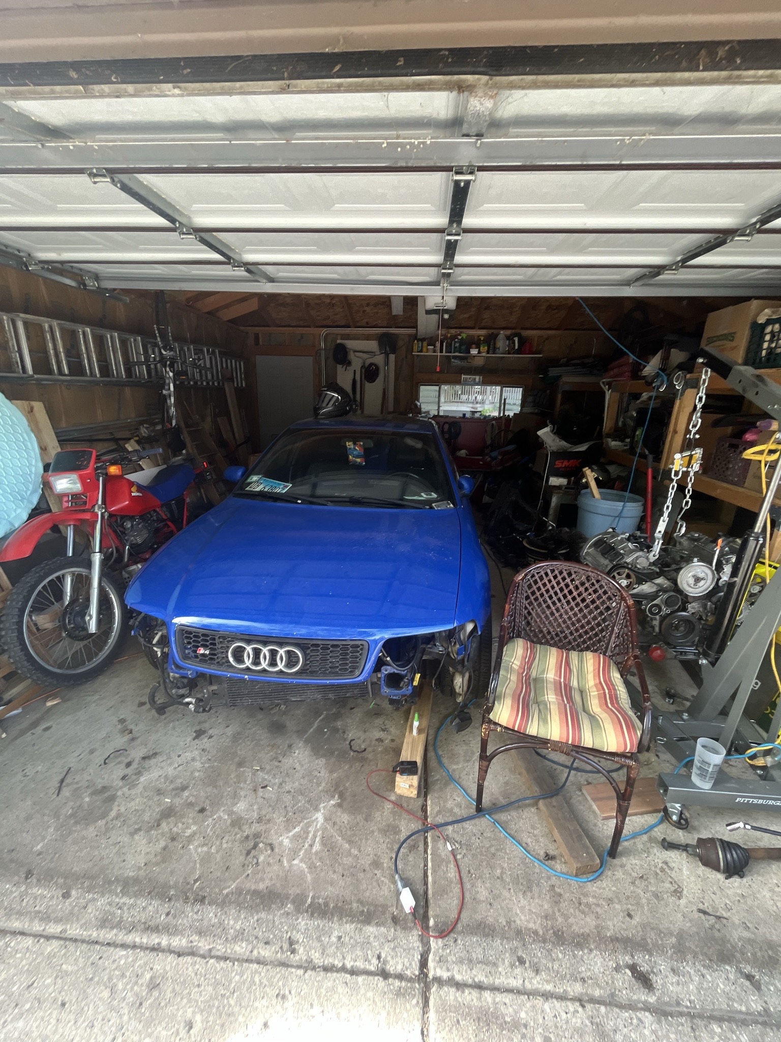

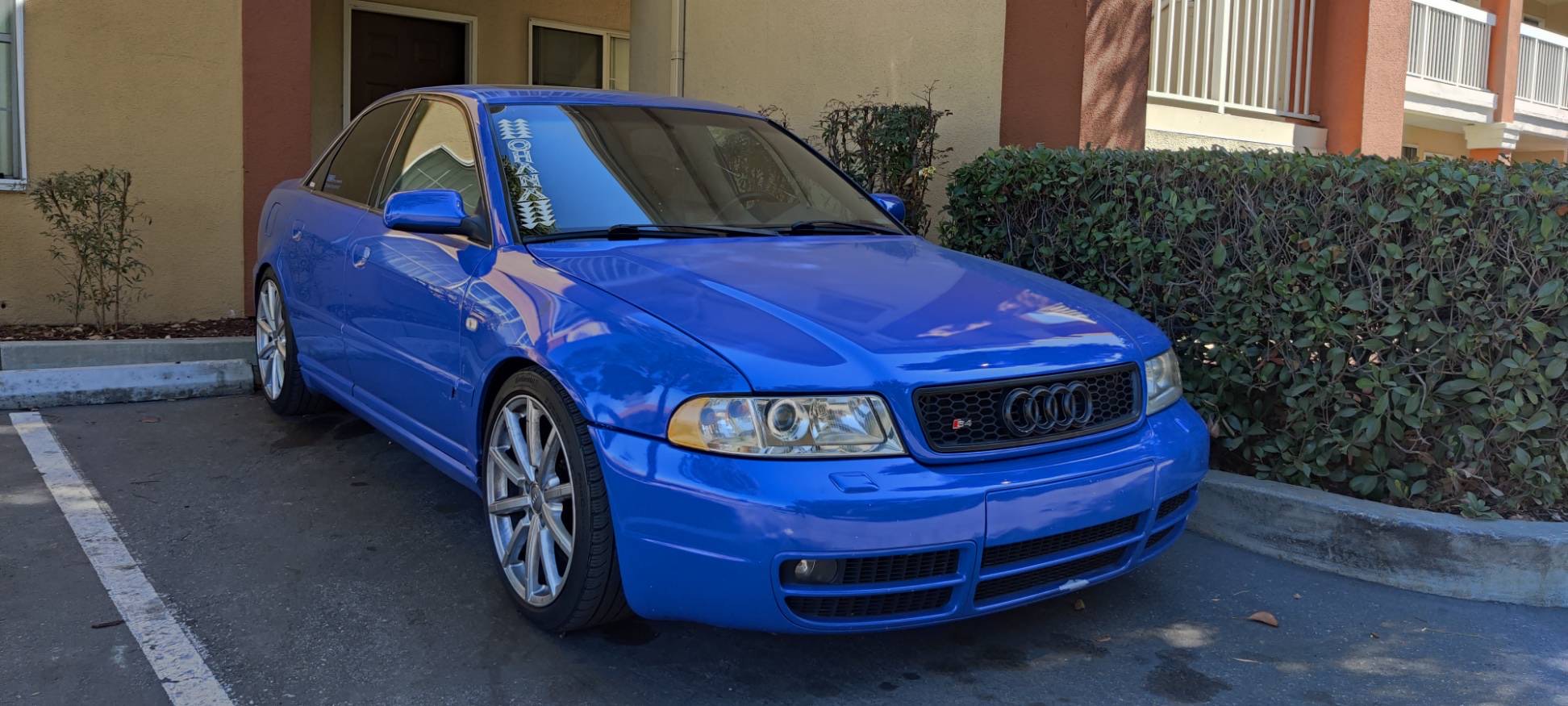

How it started:
How its going:
Hello all, after finally realizing there were more helpful groups for our cars than Audizine I decided to start crossposting to get better advice, this is my Audi246 debut.
My names Von, and this is my 2001 Nogaro Blue Audi S4 6MT.
I bought this for just shy of $10k sight unseen as my first car in 2022 when I was 18 without knowing a single iota about what was about to happen.
Cue classic teenager + B5 S4 story, a car that was definitely not as advertised, and it's now been sat in the garage for 1 1/2 years.
Here's the current situation

My first order of business is to do the oil pan, FMS, RMS on the motor, then top end reseal. From there I have acquired a new late-style intake manifold from the spare motor deal in the free parts horde. It has new cam chain tensioners done by myself back when it was on the road, and while there was no issue with the tensioners, my sealant job on the valve covers was a bit - enthusiastic - if you will and that's what caused the valve cover leak, along with using autozone sealant. I will clean the motor, possibly paint the block, and to prepare for the processes of disassembly and reassembly in the cars motor I will first be doing the same to the spare motor I have to get an idea of the processes and potential issues that could arise. I also have a bunch of excess parts from the spare motor I will be listing out in a later post for anyone who needs parts and/or wants to help the cause and get me some garage space back cause it's at a premium right now. After the motor itself is assembled it's time to put the transmission back on then back in the car. From there I will be doing suspension, then interior, and finally finishing the build with an OEM widebody. I work at an Audi dealer thankfully so I admittedly do get discounts on parts and I have access to the all the service manuals I'll ever need.
