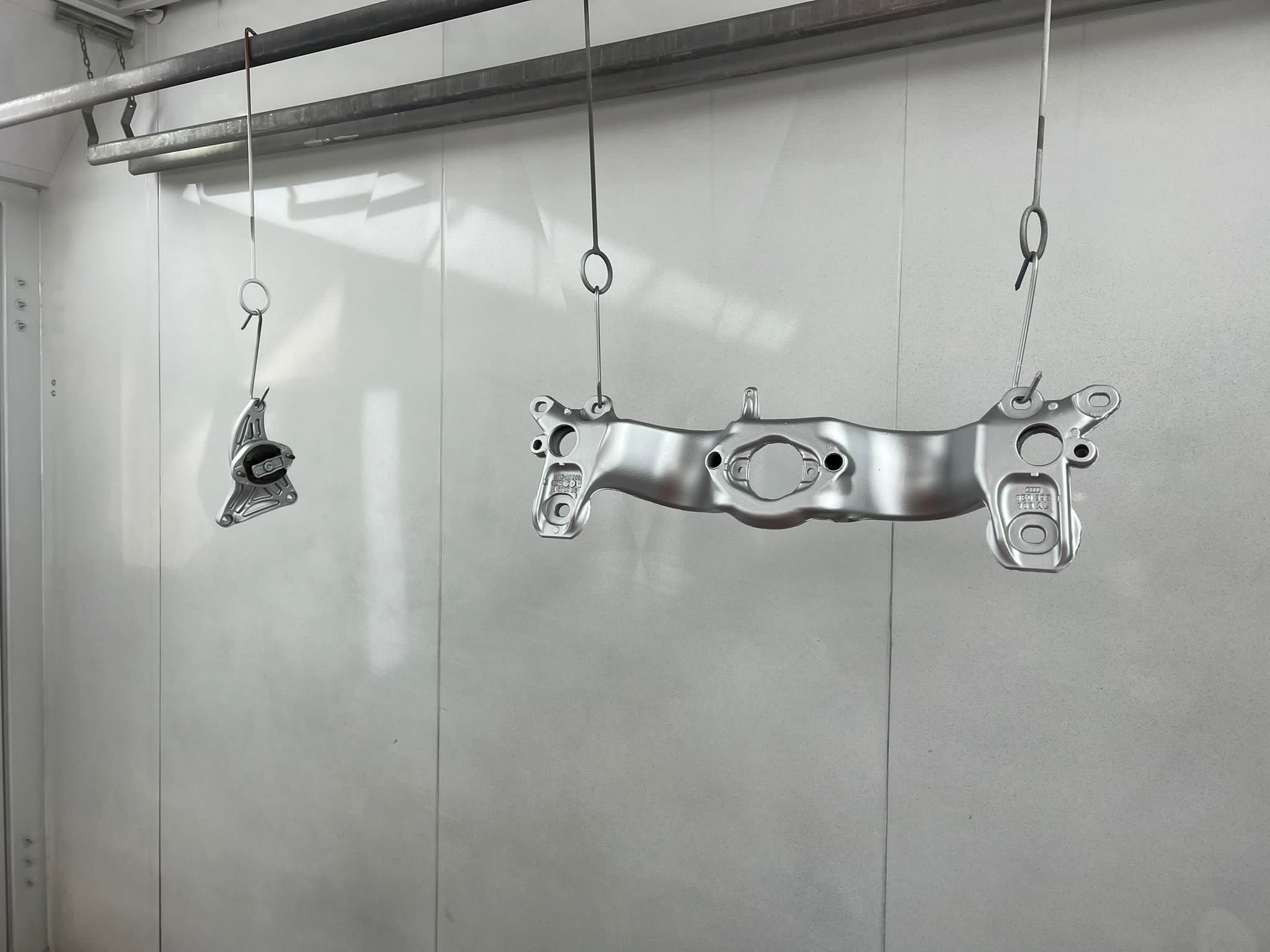

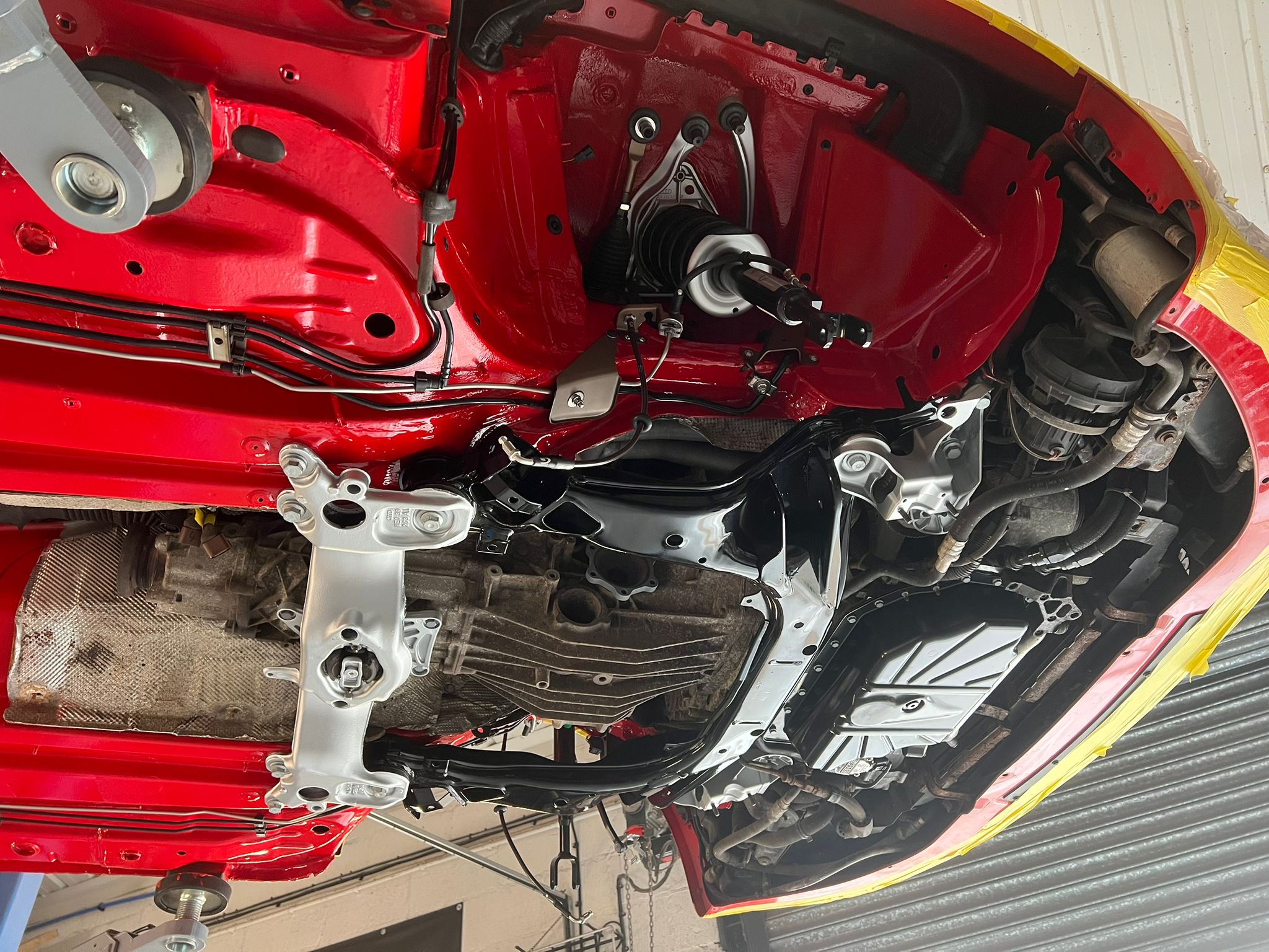

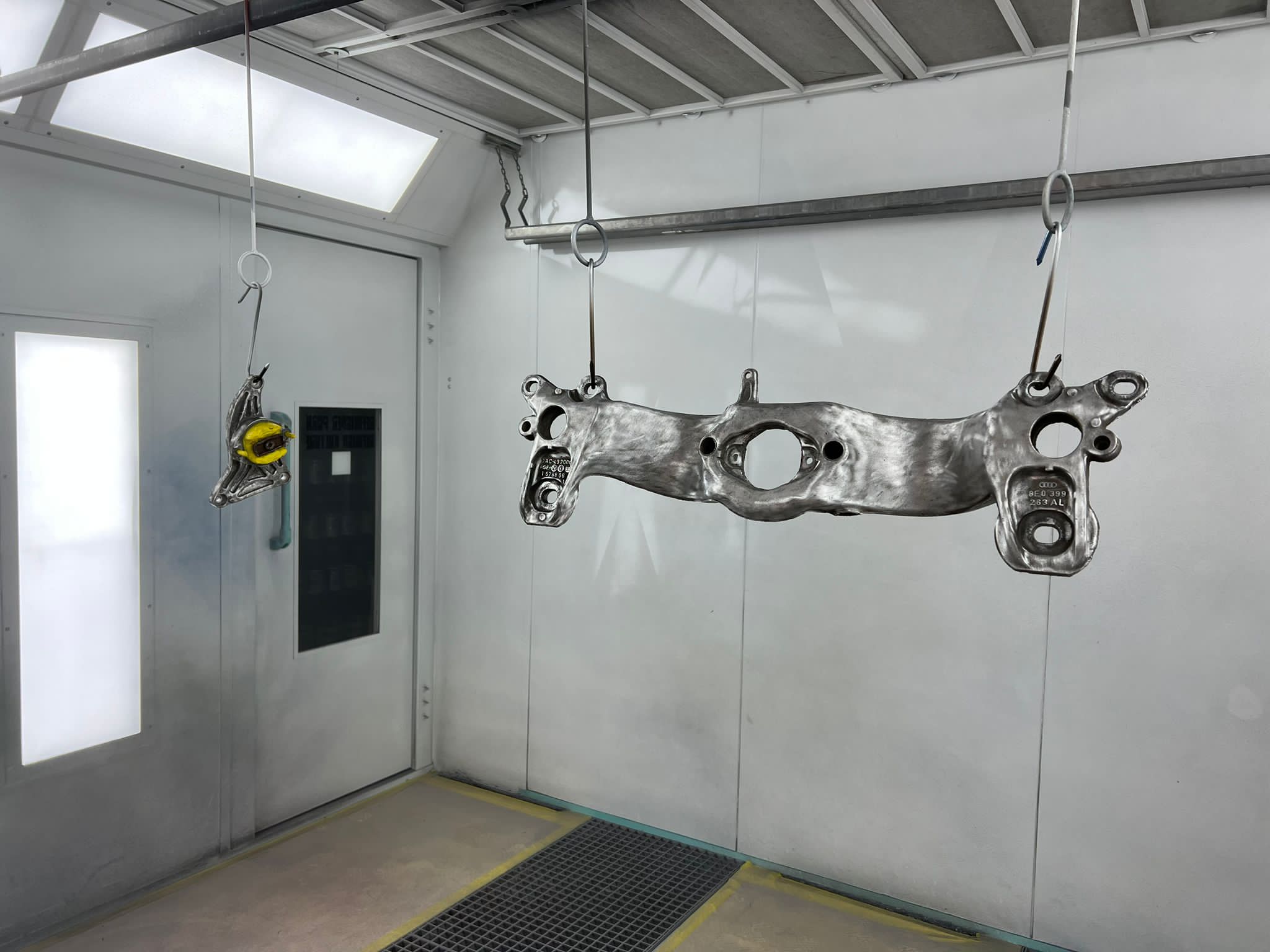

Re: Martin's RS4 B7 Avant Build

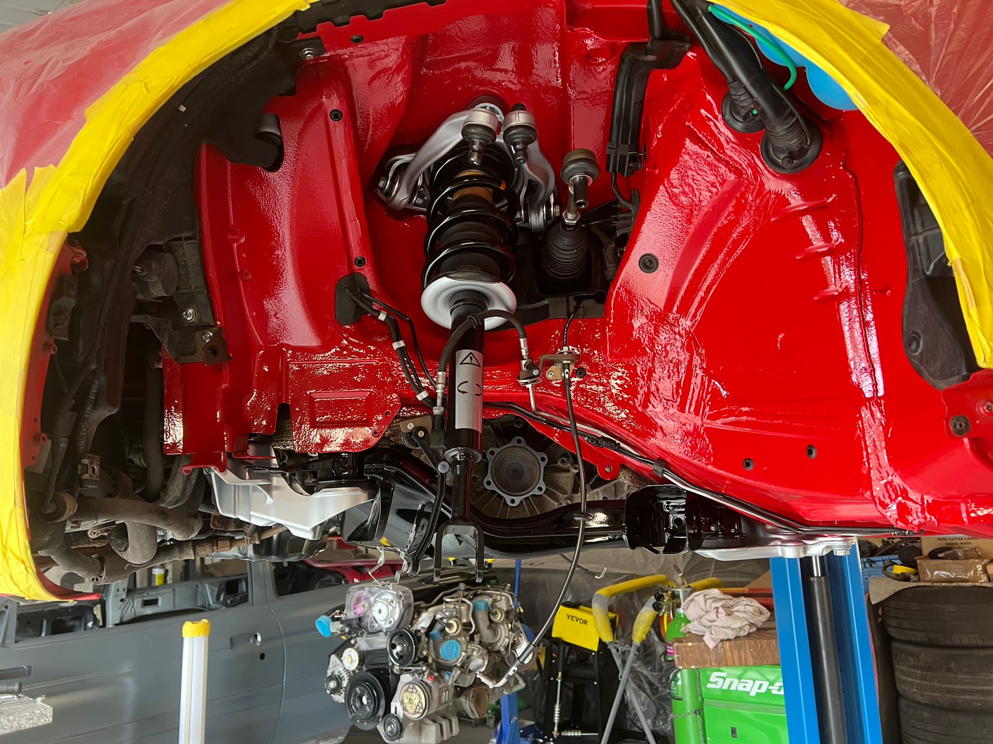

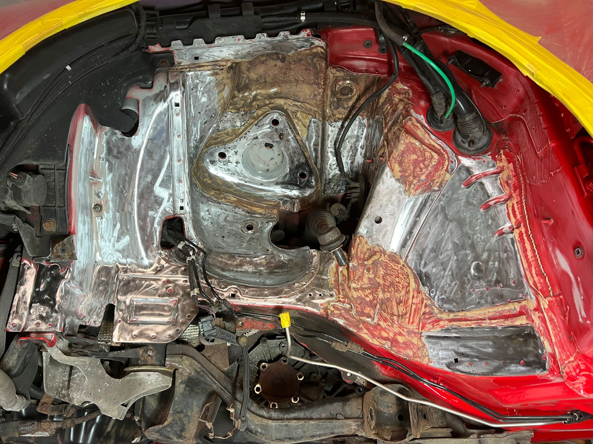

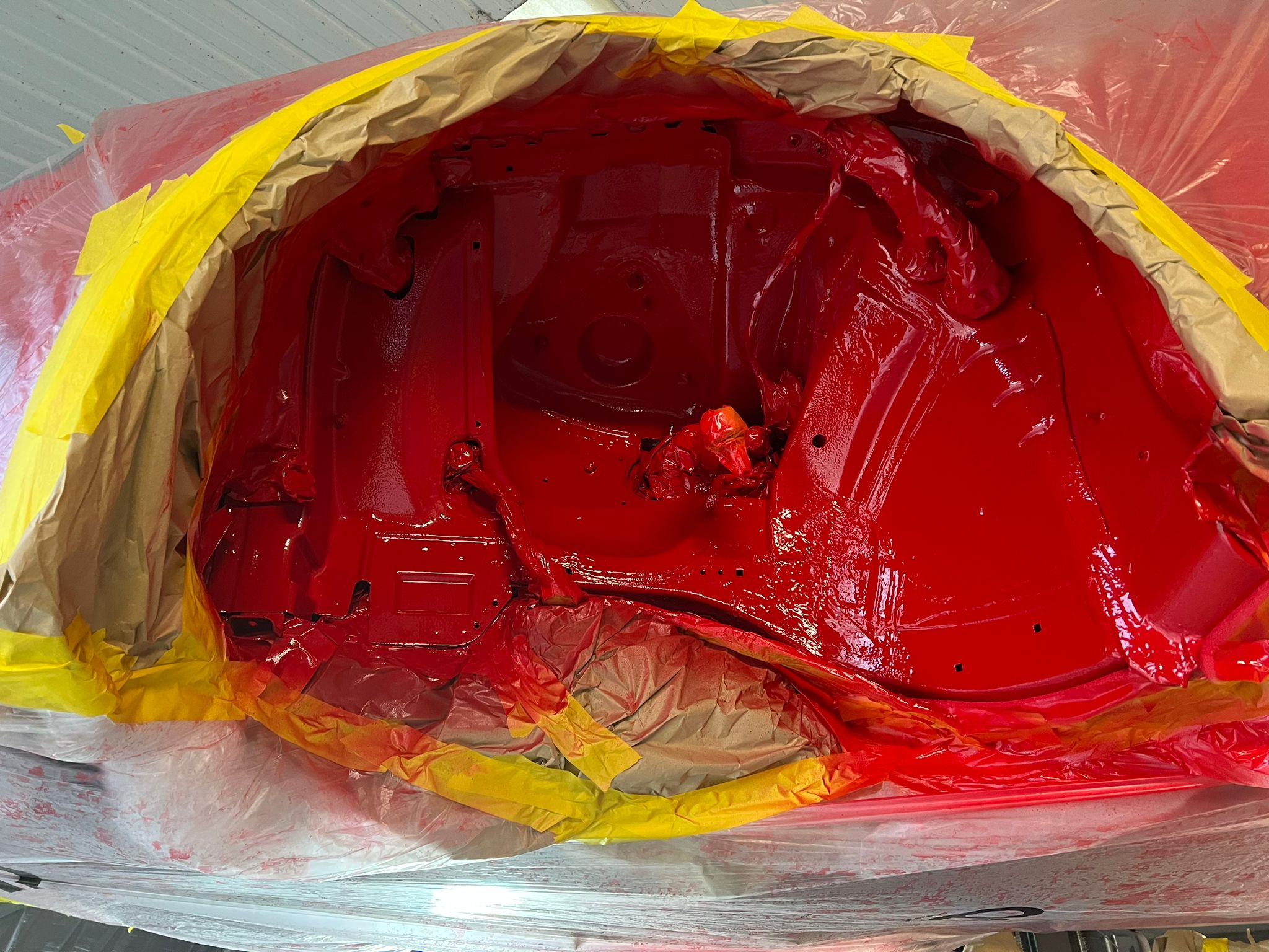

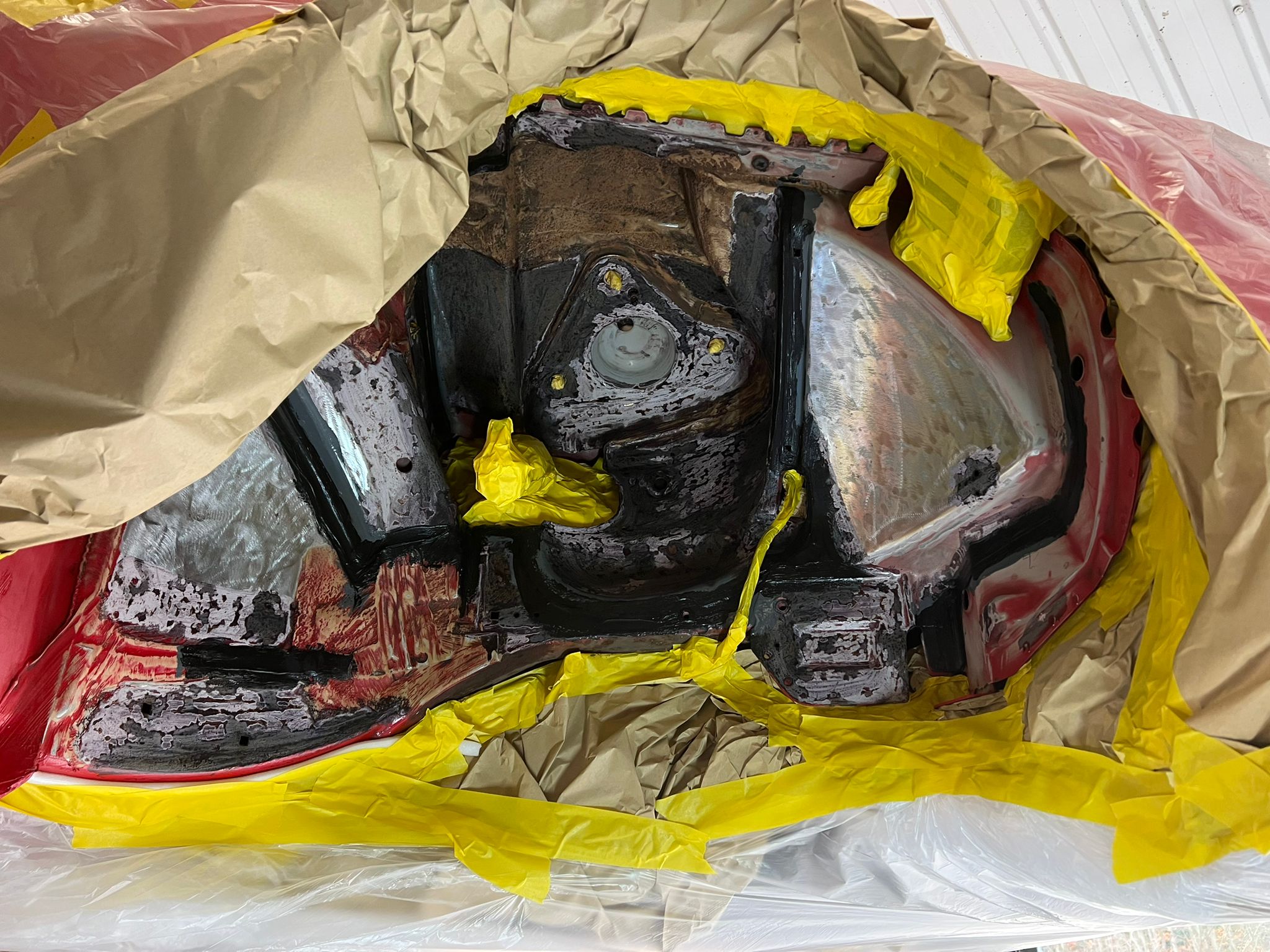

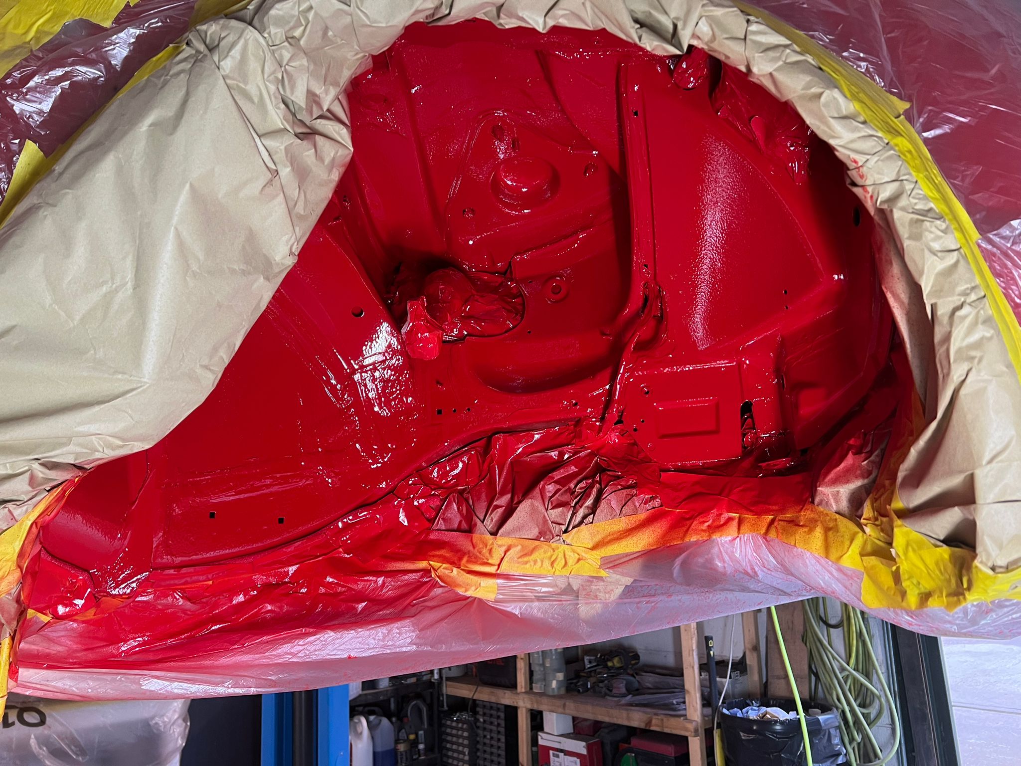

Front end work well underway now.
All the front is stripped, rust treated, epoxy primed and painted.

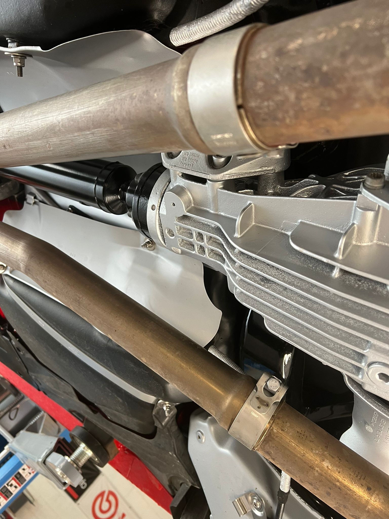

The original cat pipes are at metal fabricators having the flexi bits put in (they were very frayed). Hubs and other bits are being blasted and zinc coated. The front drive shafts have been sent away to be reconditioned by Driveshaft UK who did an excellent job on the rears.
The exhaust was going to be ceramic coated but this can wait until the engine gets pulled next year. That way the manifolds, new Zinram cats pipes and original cat back sections can be done at the same time.
Same goes for the clutch and flywheel, no point replacing them now, will rebleed the clutch line for the time being.

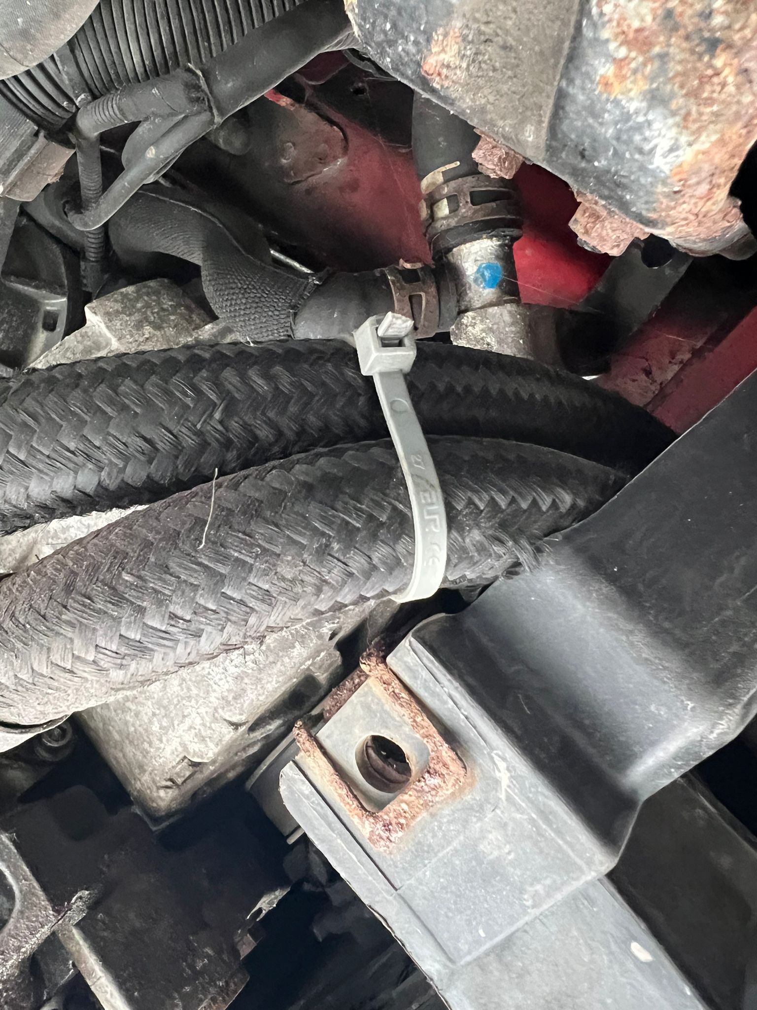

Had a very close call with the engine though.....
The Forge oil cooler lines had been bodged in place with cable ties either by the original installer or during subsequent maintenance work.
The outer coating was almost completely chaffed through!!!
If they had failed it would have killed the engine in a matter of seconds
New hoses on order and Jim is going to run them properly this time.

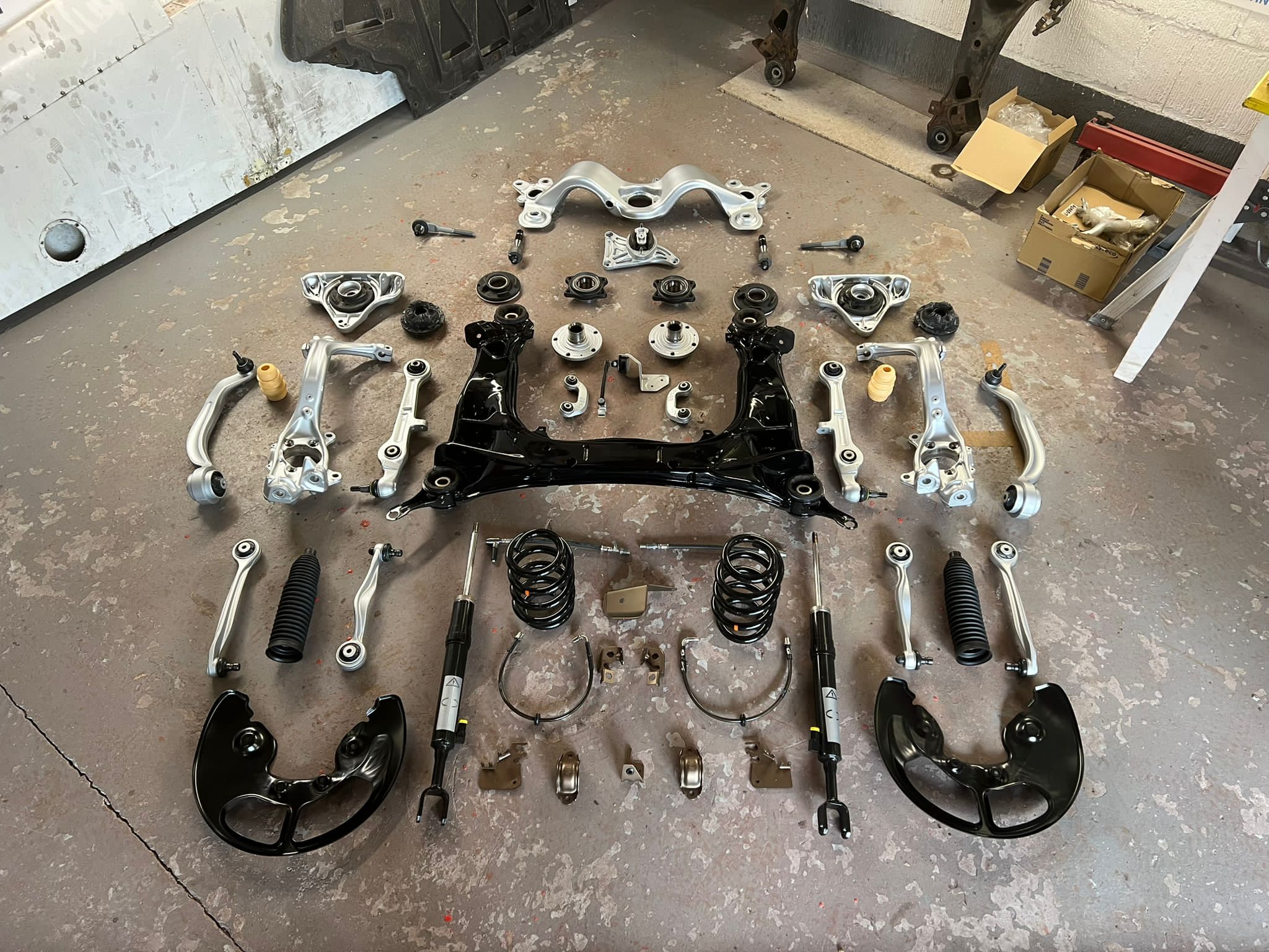

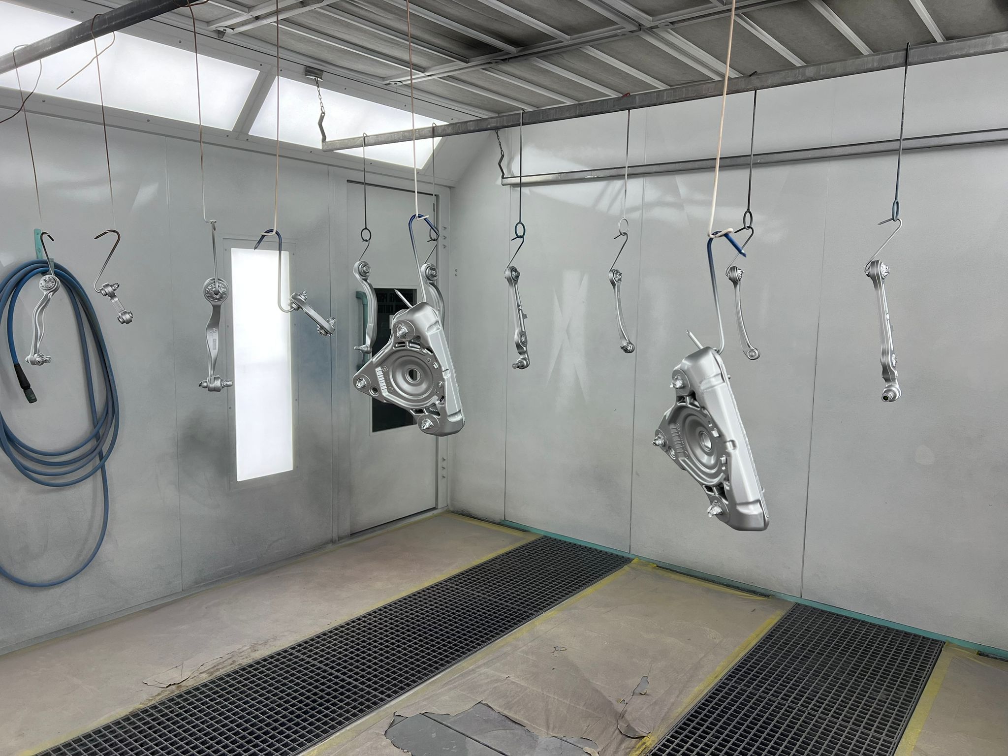

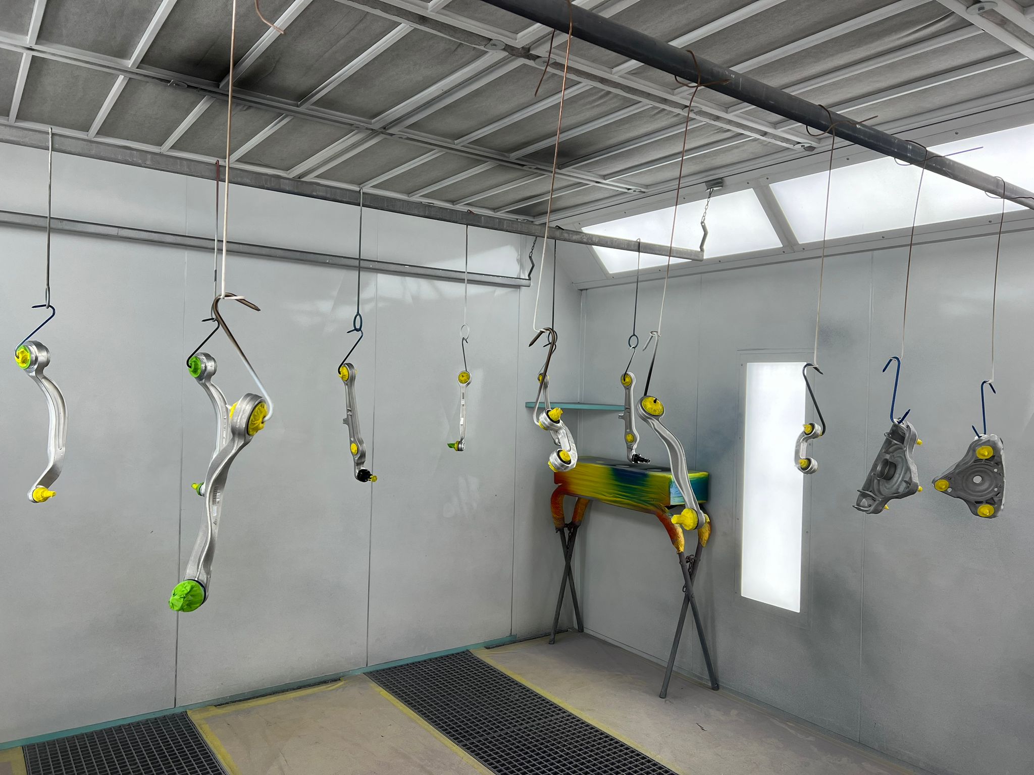

Front end parts lined up and ready to be fitted.
The old bits have been cleaned up and refinished so they can be re-used (where possible) Even the brand new parts have been painted so they all colour match once assembled.
SS+ springs and dampers.

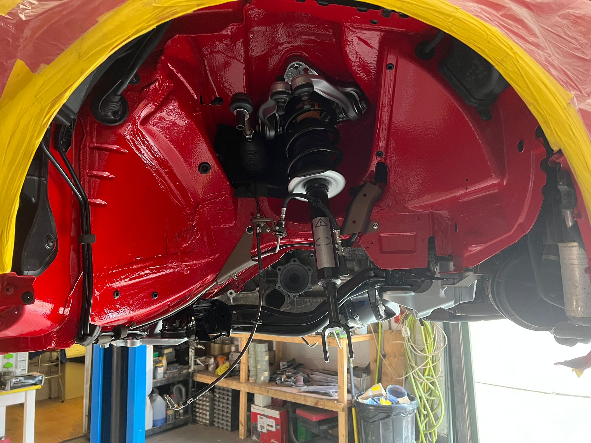

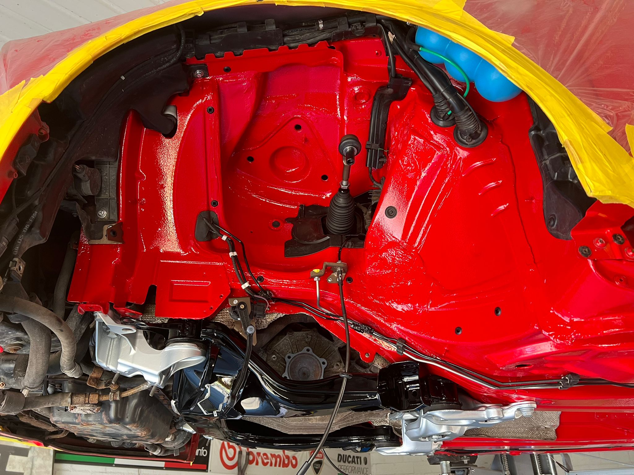

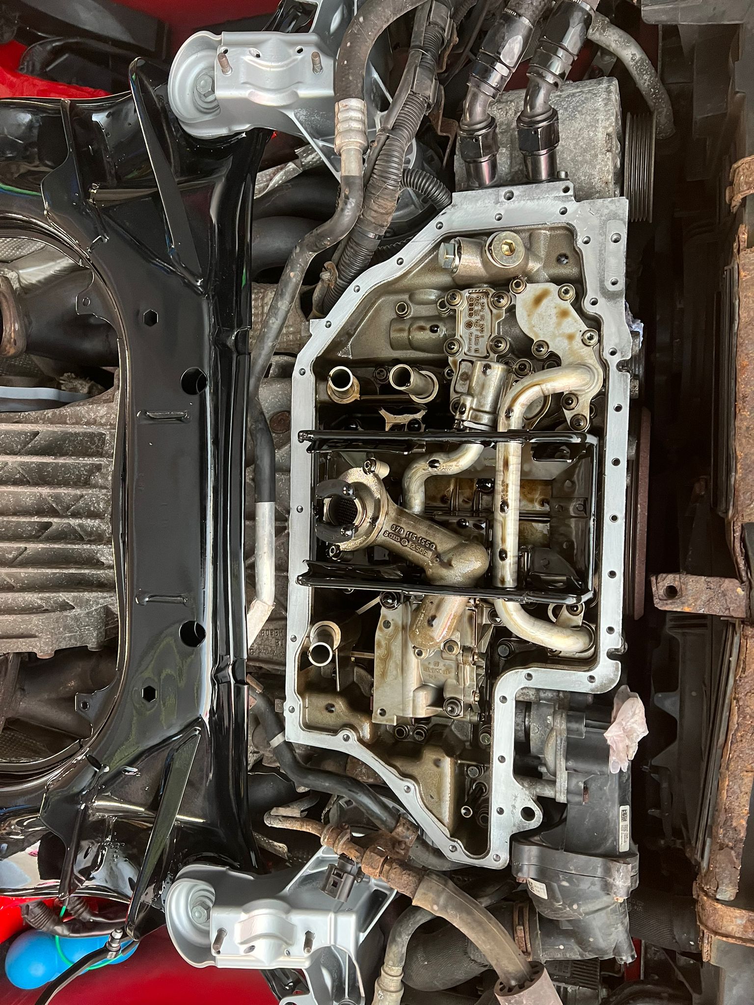

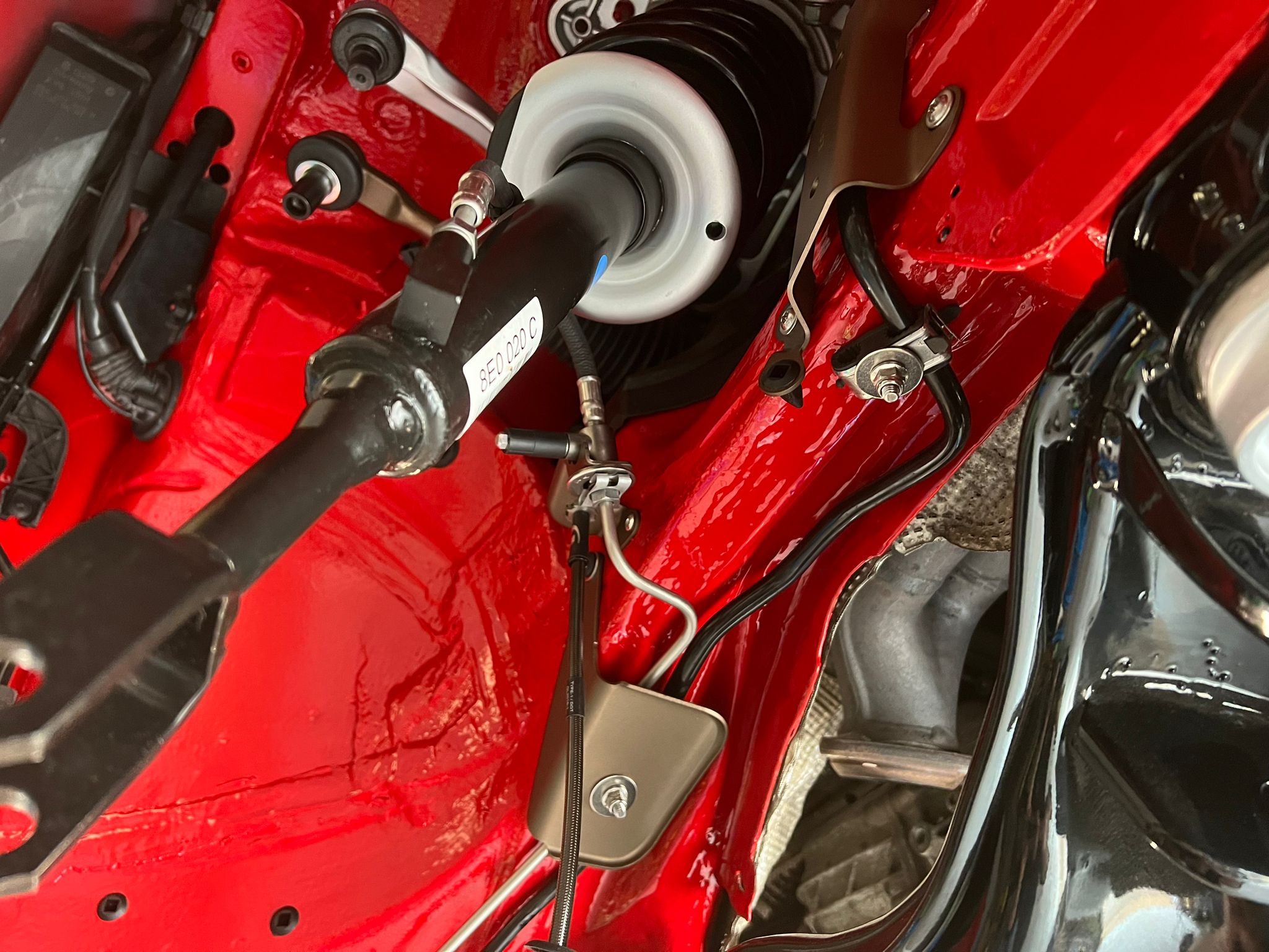

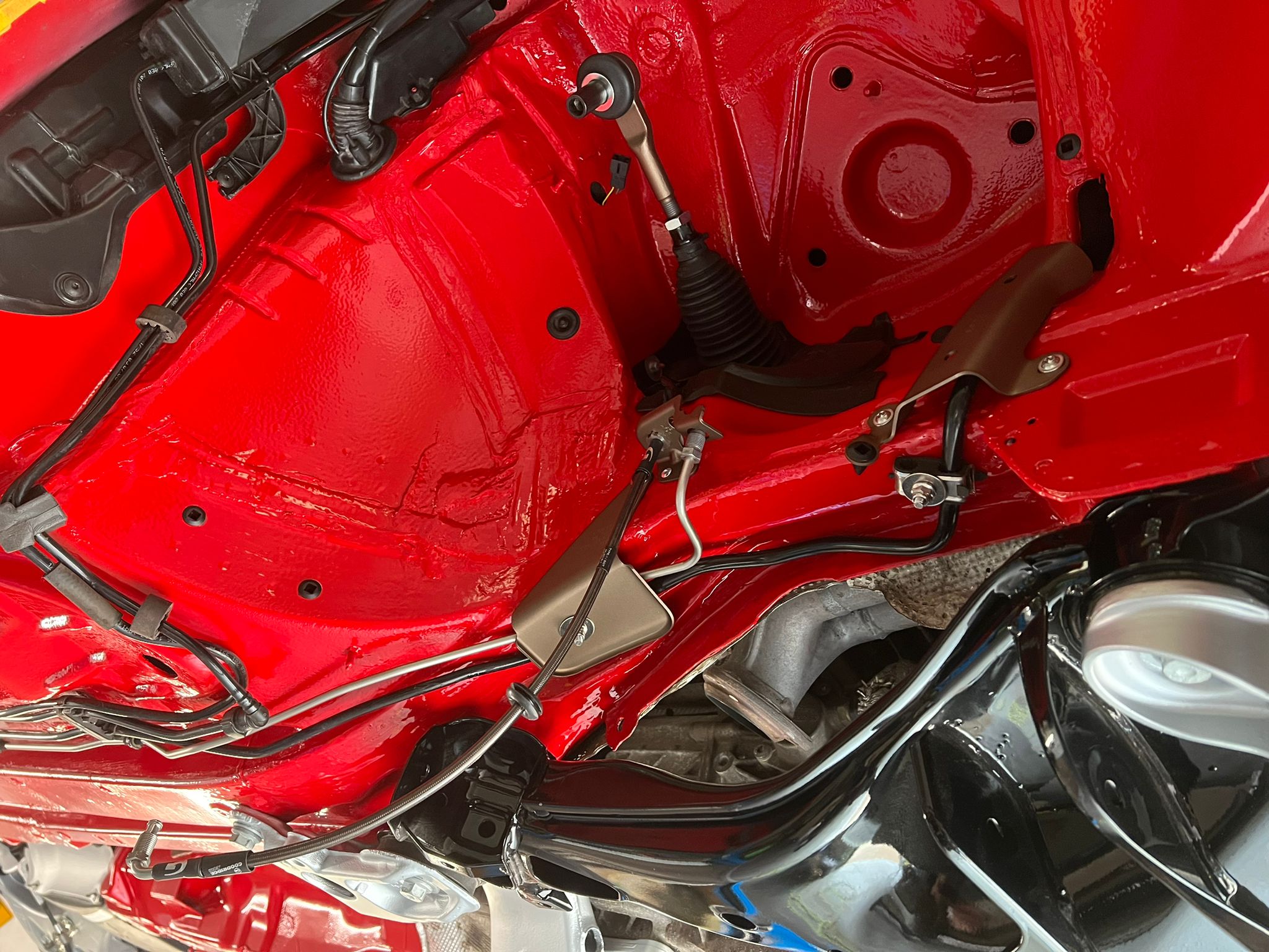

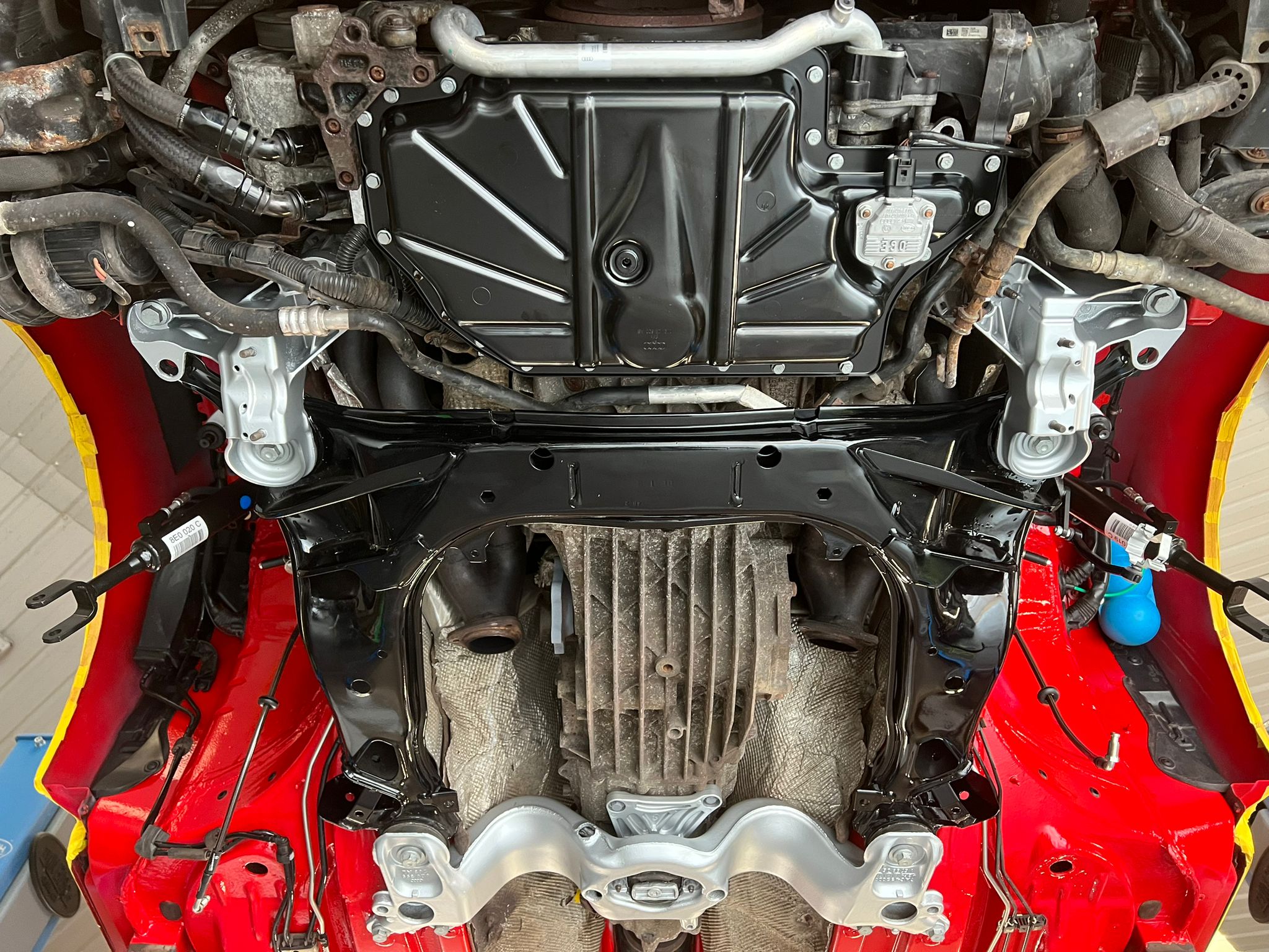

Front end is really starting to come along now. Some of the front suspension parts have been fitted along with a new sump due to the old one being corroded.
The stuff in the engine bay is letting the side down now but that can wait until the engine is removed in a year or so.
Power steering pipes not looking too great though...
Really looking forward to getting the car back and putting some more miles on it!

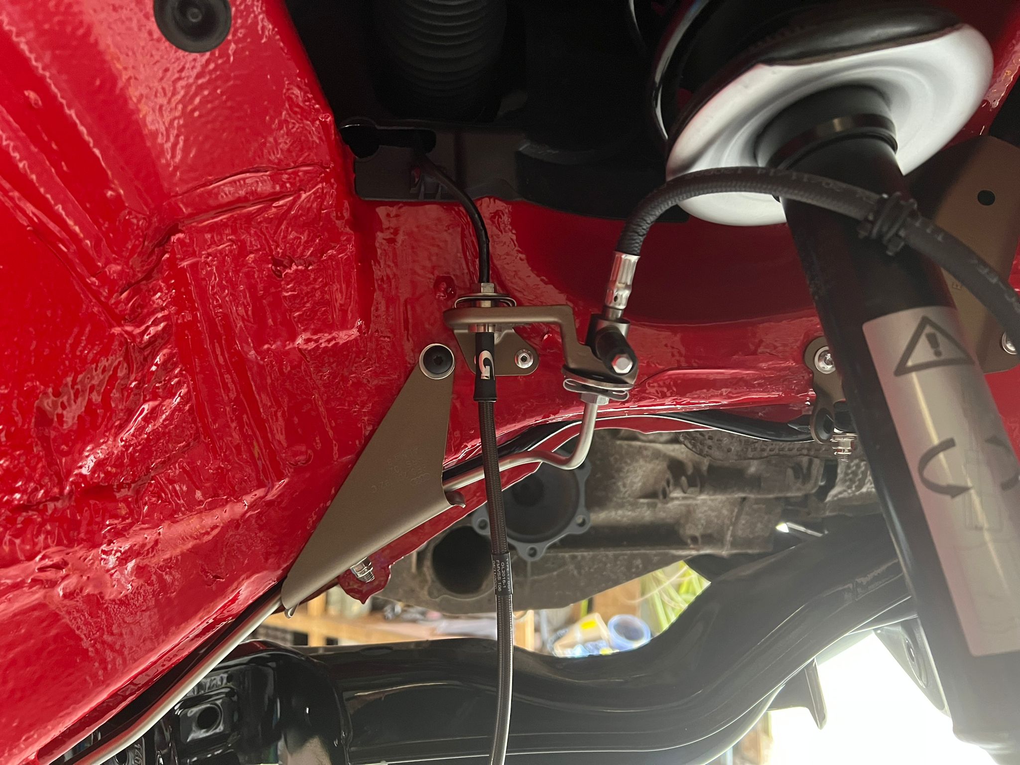

Front end finally finished with all the little snagging tasks completed. One of the brand new SS+ dampers decided to start leaking once the system was charged but luckily it was picked up before I collected the car !!!
New one was sourced and fitted with no issues the second time around. So finally collected the car in June after a long 2 year restoration plan.
It's still early days and I was not able to put a huge amount of miles on the car but what I can say is (in my hands) the DRC SS+ setup is the quicker and more composed setup for road use. That slight shimmy from the rear of the car that was there with the 034 ARB is gone. The car now feels completely planted at speed, absorbing rutted and roughly repaired sections of road with ease. In this regard its is honestly brilliant! It just gets on with it to the point you don't really notice it working away.
There is almost zero body roll and less brake dive. Same goes for squatting at the rear under acceleration.
It's not perfect though, the ride is still a bit crashy around town at lower speeds but probably on par with the KW/034 setup. I put it down to the small sidewalls and 19" wheels.
Because of the relative lack of body roll (it feels flat no matter how hard you corner) I did find it more difficult to read the car. Its hopefully something I will adapt to with a bit more time behind the wheel.
And the front still sits too high but I can just about live with it like that!
Overall there is not a huge amount of difference between the two setups. I would be more than happy to run either setup and may well return to KW V3's in the future when the DRC inevitably starts leaking!
Massive thank you to Jim at Liberty Autoworks and Greg at Southam Bodies for all the hard work they have put into restoring the car.
Next..... onto the engine but that can wait a year or two!
