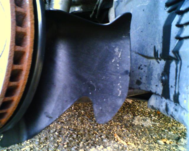

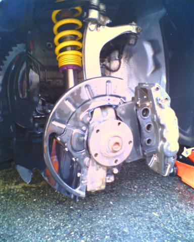

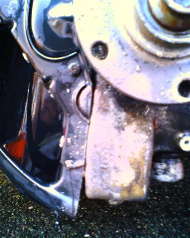

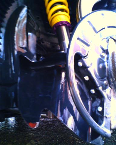

The wheel arch mod involves cutting the vents out of the arch and replacing with mesh. Not worth it IMHO.
Do the Pheaton ducts only, and yes the bottom does need cutting. Took me about 1 hour to fit. There's some pics in my gallery.
PhilT
RS246.com
Posts: 8715
Location: South Yorkshire
Post by PhilT » Mon Dec 11, 2006 1:11 pm
Sorry, no pics in gallery, so here you go....
