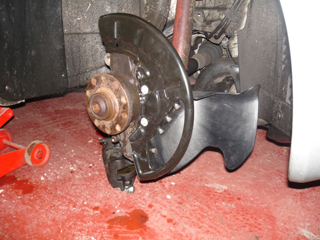

Could somebody pls confirm if the Phaeton ducts and splashguards have holes that will lineup with RS4 uprights only, but not S4s. If so, what would be the easiest way to make them work on the S4, am sure some of you must have done it on S4s. Thx
Fitted both the splash guard and duct to both B5 S4(facelift) & RS4 - the holes line up fine, but you do need to cut a small amount from the bottom of the splash guard

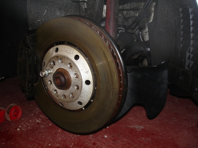

I've done my brake ducts today :D
I had to file the mounting holes so they are slightly closer together and cut the bottom of the back plate. Other than that easy!

Post by s4woody » Sun Feb 04, 2007 3:42 pm
cool..hows the lock to lock with the ducts on mark..

Posts: 5695
Post by MarkB » Sun Feb 04, 2007 4:48 pm
doesn't seem to hit anything, it'll be interesting to see on the MOT ramp with the car down on it's wheels though
