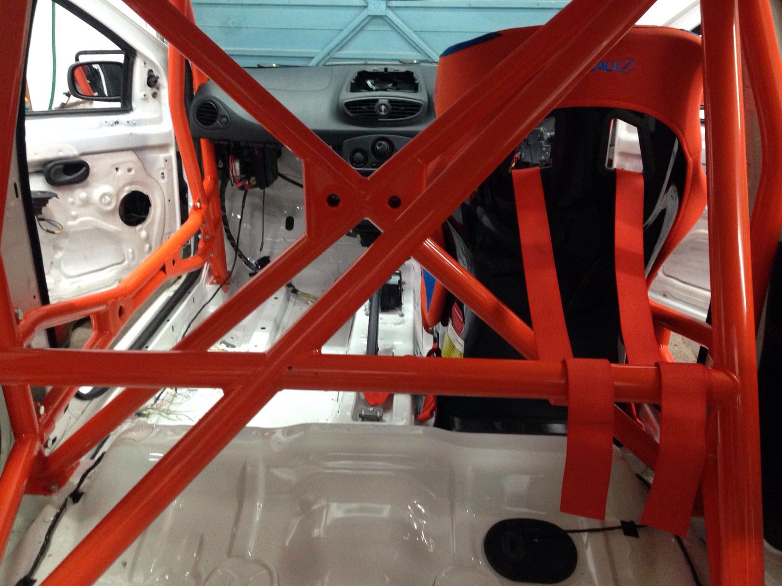

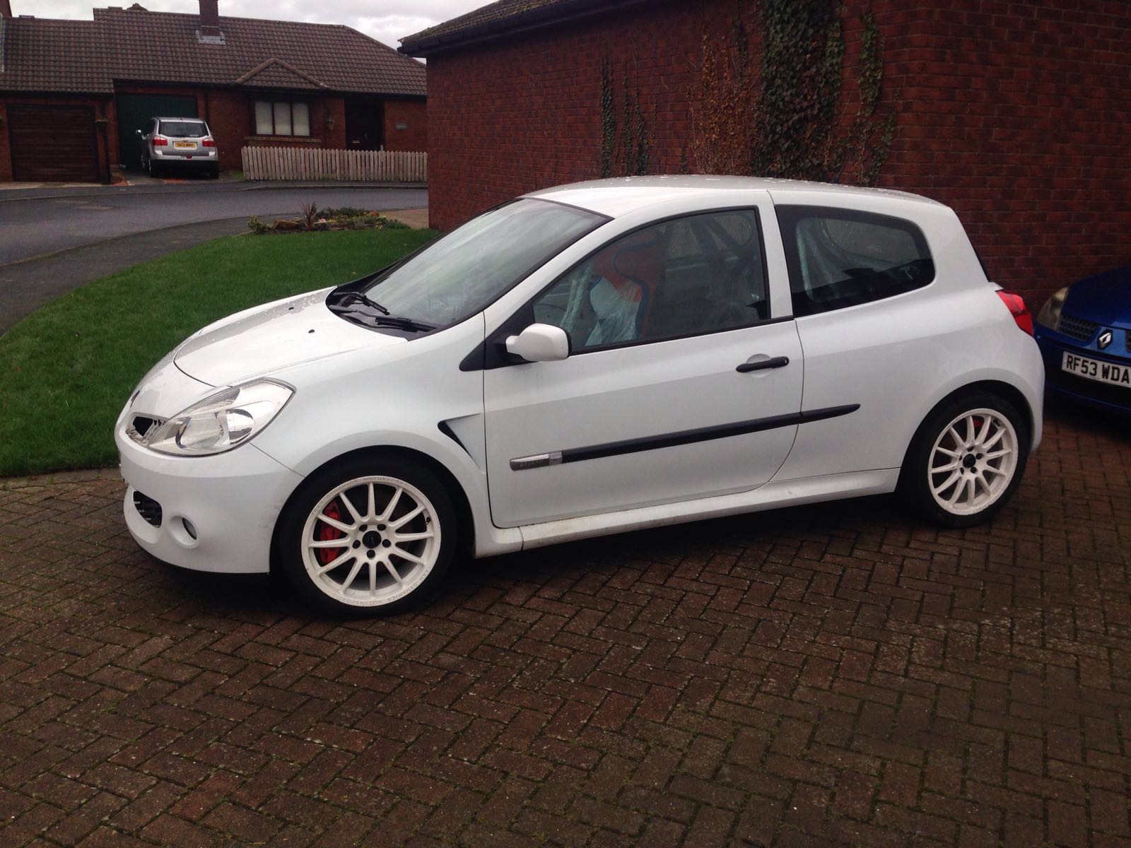

RossDagley wrote:Image
Clio cup 182 on 82k miles in racing blue.
Myself and the co-owner are into it for about £4K all in, the bulk of that is in the cage, exhaust and seats/harnesses. Car itself was only £1100 and would be great as is. Rest of the money is in suspension and tyres.
It's a cracking car and with incredible grip / traction that surprises a lot of bigger cars.
Plans for this year are 2x trips to Nurburgring, and continuous track days in the uk (last one 12/12/15 next one is next weekend!)
What had been done to the Clio before you bought it? You must have spent more than £4k on it surely? The cage looks like a decent multi point weld in job. That must be c.£3k. Does it meet any competition regs? I am liking that very much. Good work. :beerchug:
Nothing done to it previously. Was stock.
We *were* about £4K into it (part sponsored cage and exhaust from JC Weldfab helped a lot) but we're about £7k in now I'd say, having changed to MC750 race suspension and added 4 pot brakes, RS Tuner remap etc etc.
We've built it to just do track days this year then hopefully trackday trophy series next year. Cage is MSA / FIA approved from JCWF. Suspension is good for ktec Clio series / MC750 etc. With a few other bits we'd be compliant (remove aftermarket rear anti roll bar etc).
Was at Bedford again on Saturday and it was staggering as always. Anything more powerful you just let pass on the straights and bully out the way on the corners. Image
Still in love with it.

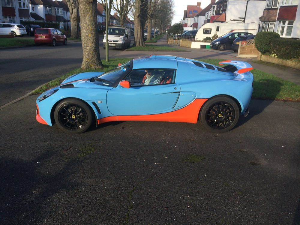

This is my new race build
PJC
Posts: 4736
Re: Anyone running a cheap track car?
Post by PJC » Tue Mar 01, 2016 1:10 pm
Testing at Oulton Park on the 12th
PJC
Posts: 4736
Post by PJC » Tue Mar 01, 2016 1:12 pm
The Exige in its new livery
PJC
Posts: 4736
Neither of them are cheap though!
