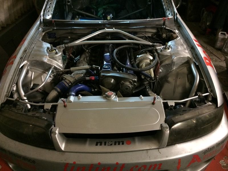

Re: Anyone running a cheap track car?
Need pics of the skylines buddy.
Spec for the old girl
ENGINE:
• RSP forged bottom end with Eagle rods & RIPS baffled sump
• (HEAD) Ported inlet & exhaust ports + ported inner inlet ports + cut down valve guides + squish removed, Bigger Valves, Tomei solid lifter + valve springs & retainers + Head drain kit.
• Jun 270 duration + 10.25 lift cams
• RB26 Cam covers with Tomei baffles
• Japspeed front mount intercooler
• HKS S40i spark plugs
• Link G4+ ECU + HKS Twin spark
• Anti-lag, launch control, flat shift
• RSP induction kit + custom intake box
• Rising sun alloy intake pipe
• Splitfire Coil packs
• Nismo oil cap
• HKS Rad cap
• Tomei adjustable cam pulleys
• HKS Super drager Exhaust
• 1.5mm head gasket
• Greddy style plenum
• Apex performance 80mm Throttle Body
• Rising sun Custom twin catch can breather kit
• Samco boost hoses
• Samco water Hoses
• Japspeed Alloy RAD
• Sard 850cc injectors
• HKS SSQV BOV
• Turbo beanie + heat wrapped downpipe
• XS power Screamer pipe
• Tial MSV 46mm External wastegate
• GTX3582 turbo with ported shroud & TO4Z Billet Comp wheel (Tial 0.82a/r Turbine)
• Leadfoot racing Steampipe Greddy style top mount manifold
• RSP custom cold air box
• Devilsown DVC-30 water/methanol injection kit
• Nismo cooler thermostat
• 13 row mocal oil cooler
• 10 row mocal PAS cooler
• Accusump 8L system
• Nismo engine mounts
• Japspeed engine brace
• Electronic stabilizer
• Earthing kit
• Cold Fusion Nitrous wet kit (25bhp)
• Throttle body water bypass
• Various blue engine detailing
TRANSMISSION:
• Redline Heavy duty Gear shock oil
• Nismo Gearbox Mount
• Trust/Greddy GTR dog box With custom Leadfoot racing shifter
• Competion clutch Stage 5 - 4 PUK
• Andy Robinson Race cars 1 piece lightweight prop
• Conceptua tuning extended + Baffled Diff casing
• Shimmed Diff
• 10 row Diff & Gearbox coolers
WHEELS
• Japan Racing JR-3 9.5J front - 10j Rear Alloys running with Toyo R888 265/35 Front - 285/30 Rear
• Japan Racing JR-3 9.5J front - 10j Rear Alloys running 27/64 Slicks medium compound for track days
• AWC Alloys (Ultralite Nurburgrings style) 8.5J front - 9.5J rear for road use
BRAKES
• DB 345mm brembo grooved front Discs + EBC Blue NDX over sized Pads
• 350Z rear Brembo calipers running CRN Grooved 327mm rear discs + Blue NDX rear pads
• Motul 660 racing Brake fluid
• Conceptua tuning Braided brake lines
• Brake Ducting
• Brake stopper
SUSPENSION:
• Whiteline Front + Rear Sway bars
• HSD Mono Pro Coil overs
• Nismo lower front + rear chassis braces
• Do-luck sill braces
• GTR Rear strut brace
• Front strut brace
• Japspeed lower front strut brace
• SuperPro Steering rack Poly bushes
• SuperPro Sub frame poly bushes
• SuperPro Diff poly bushes
• SuperPro front upper inner poly bushes
• SuperPro Front + Rear lower arm Poly bushes
• Whiteline front camber adjusters
• SuperPro rear camber adjusters
• Custom HICAS removal kit
• Conceptua adjustable front tension rod arms
• Conceptua adjustable rear traction rods
• CRN Custom front drop links
• Nismo Ztune suspension braces
EXTERIOR:
• Vent front + rear arches
• Jun 400r front bumper + Side skirts
• Trust rear valence
• GTR Base spoiler with ARC Magic blade & Custom spiel plates
• GTR Grille
• Custom undertray/splitter
• Custom side skirt Air Dams
• 400r Arch Extensions
• Border Carbon Fiber Bonnet + 400r bonnet lip + raised at rear
• Ziax Carbon Tailgate
• Custom Rear Diffuser & Flat boot floor
• Custom alloy front + rear Canards + front corner spliters
• Carbon Nismo bonnet lip
• Vortex Generators
• DTM style Carbon wing mirrors
• HID Hi + Low Conversion
• DW front tow eye
• FIA Pull switch
• Polycarbonate windows + vents
• Japspeed single wiper conversion with euro wiper
INTERIOR
• Andy Robinson race cars Custom Kevlar Bucket seats
• EARS 5 point harnesses
• FIA 4.0L 4 jet fire extinguisher
• FIA pull switch + master kill switch
• OMP Suede steering wheel
• Custom Acer Tablet dash set up + shift light
• Custom heater matrix set up
• EGT gauge pod mounted by A-pillar
• Various silver dash detailing
• Leadfoot racing custom lightweight steering column
• Leadfoot racing Custom 6 point Roll cage + gussets
WEIGHT REDUCTION (1190kg)
• Space framed front end
• Air con & All Sound Proofing removed + Dash
• Rear seats, Door cards & All Carpets removed
• All Seat belts + roof lining + various interior panels & Elec Arial + stereo removed
• Jack + Spare wheel removed
• Spare wheel well removed
• Parcel shelf + speakers & wiring removed
• Rear wiper & Hicas motors + wiring removed
• All exhaust + Manifold heat shields & various unused brackets around car removed
• Complete Hicas removal inc ECU & wiring
• Various wiring like heated seats removed + No ABS or S/R
• Elec front window motors + Switches
• Various Carbon panels (see exterior) + Polycarbonate windows
ICE
• None!!
SECURITY
• TOAD CAT 1 Alarm + immobilizer
• RAC Tracker
PERFORMANCE (mapping being finished mon, figures are based on last map)
