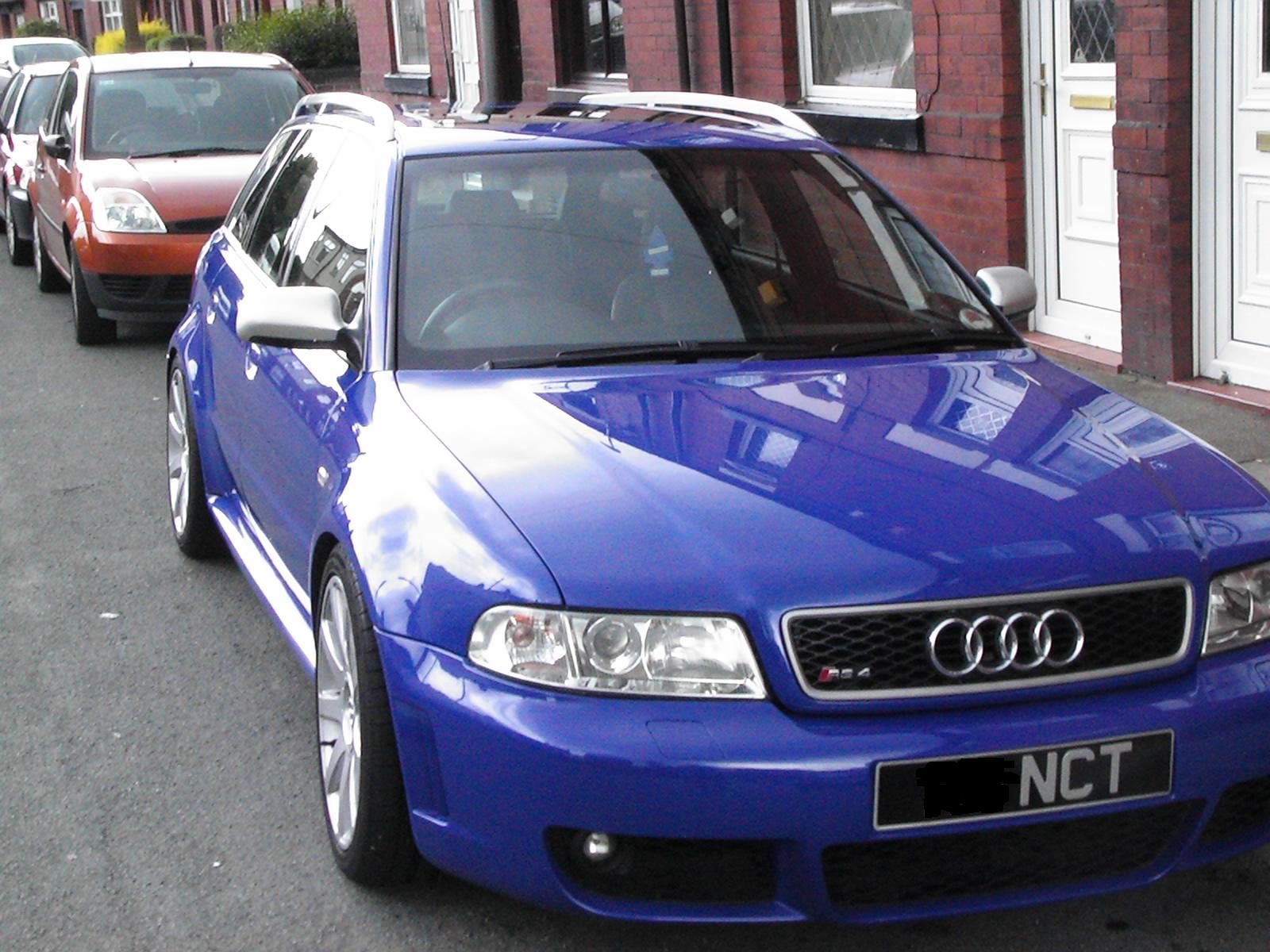

This is how my car looks with spacers of 15mm@front and 20mm@rear:
