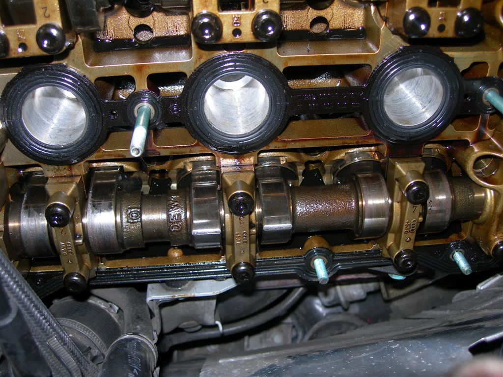

It does happen on S4 engines as well. Suspect case hardening on the cams pitting on the followers causing accelerated wear.
A pic of my old S4 AGB shown this a few times. Happened back in 2003 in a 1998 S4 covered 74k on Mobil one oil.

I had too have *all* my camshafts replaced by MRC to cure the misfiring on my RS4. Doug advised that he had seen this quite a bit on S4's\RS4's and attributed it to the longlife servicing regime, in that the oil doesnt provide adequate lubrication over the period.
:blackrs4: B5 RS4, MRC Remap, Milltek, RS6\B7 Brakes, Black\Carbon
TopBear
Posts: 924
Joined: Mon Jul 03, 2006 12:41 am
Location: Glasgow
Post by TopBear » Wed Nov 21, 2007 11:32 am
Pic

Not sure the cam wear is a symptom of this, the example I posted was running on Mobil One changed every 10,000 miles, I think it was just the camshaft was not hardened correctly.
