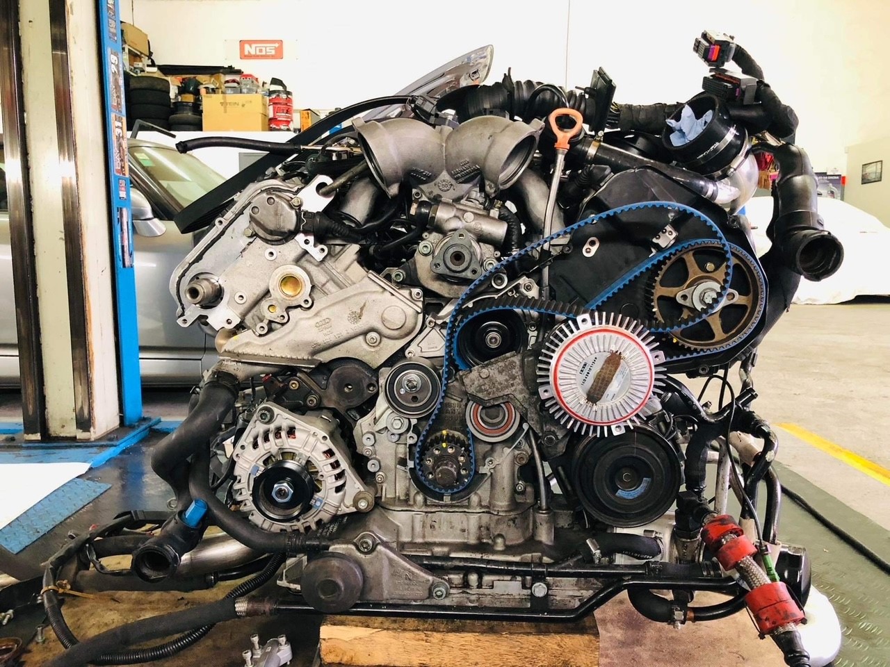

After fully building the engine, with forged rods, JE pistons, upgraded valvetrain , bigger turbos etc , i have made around 1400 km of a break in period.
When finished, corrected some minor bits , such as oil leaks and installed the tfsi coils (thetuner conversion) and bosch ev14 950cc injectors.
Went for mapping and in the middle of a mapping session the engine shut down.

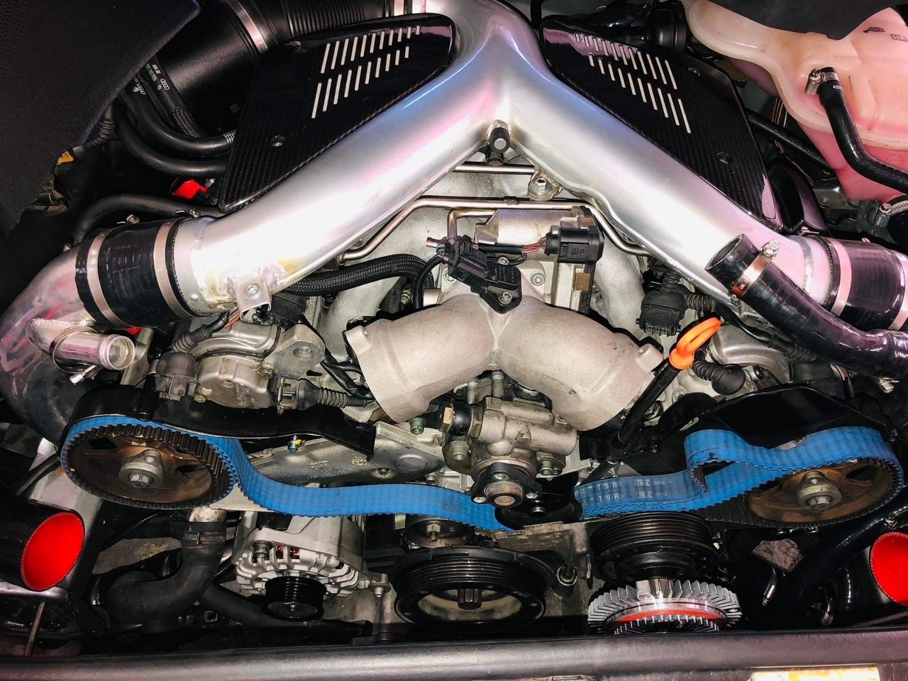

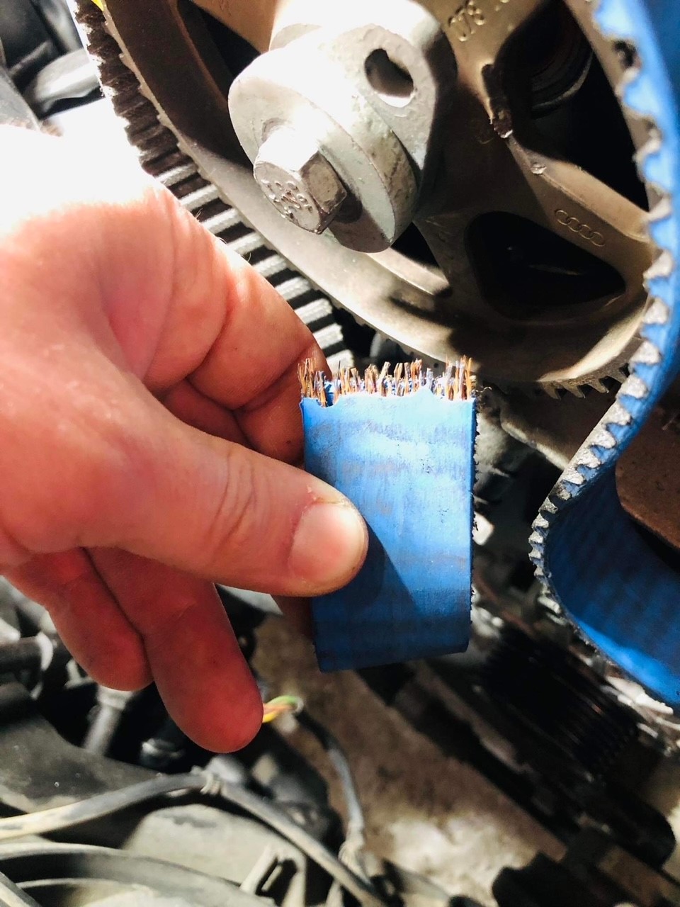

Result : Broken timing belt. ( brand new gates blue rpm installed with rebuilding ).

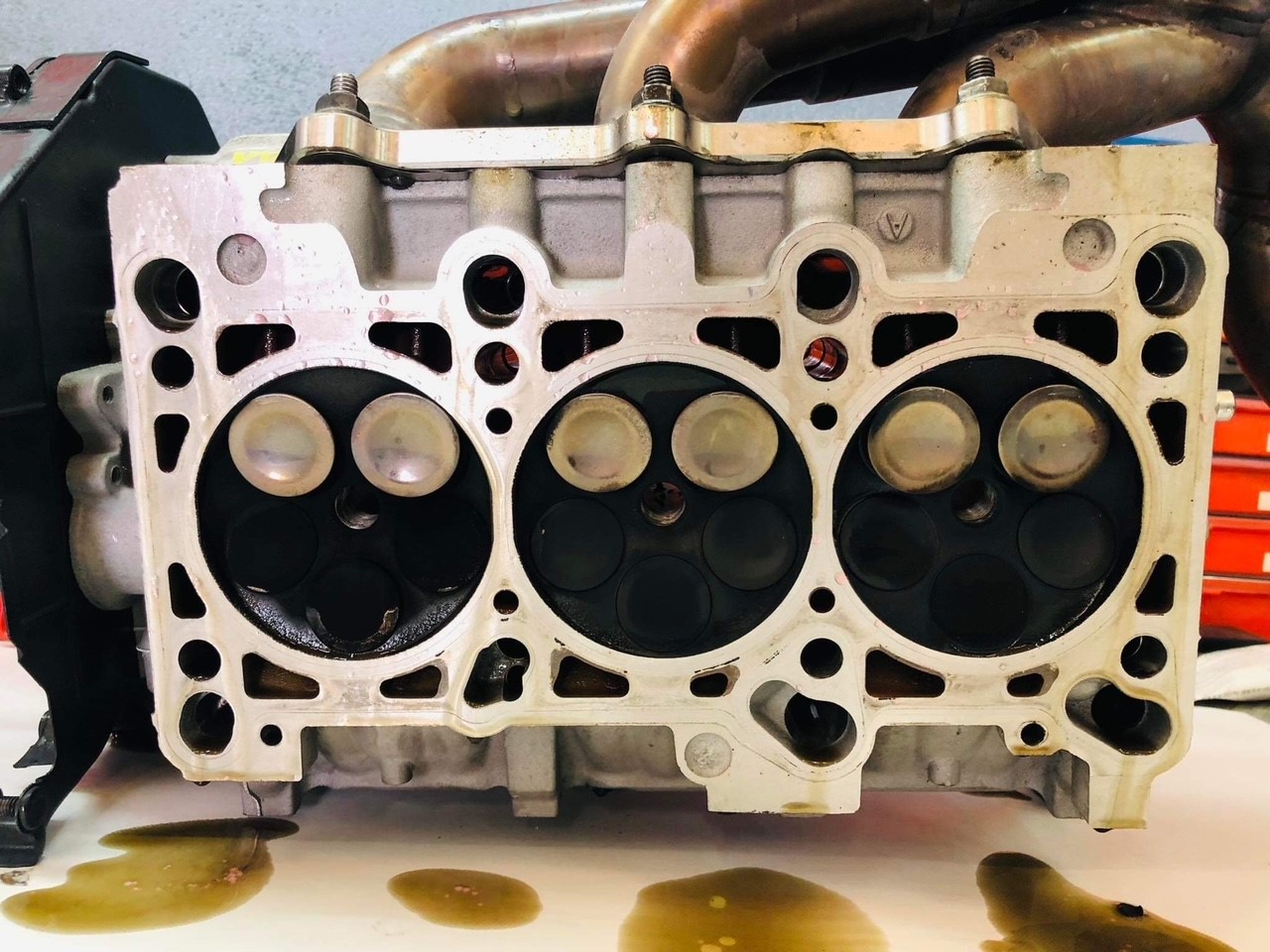

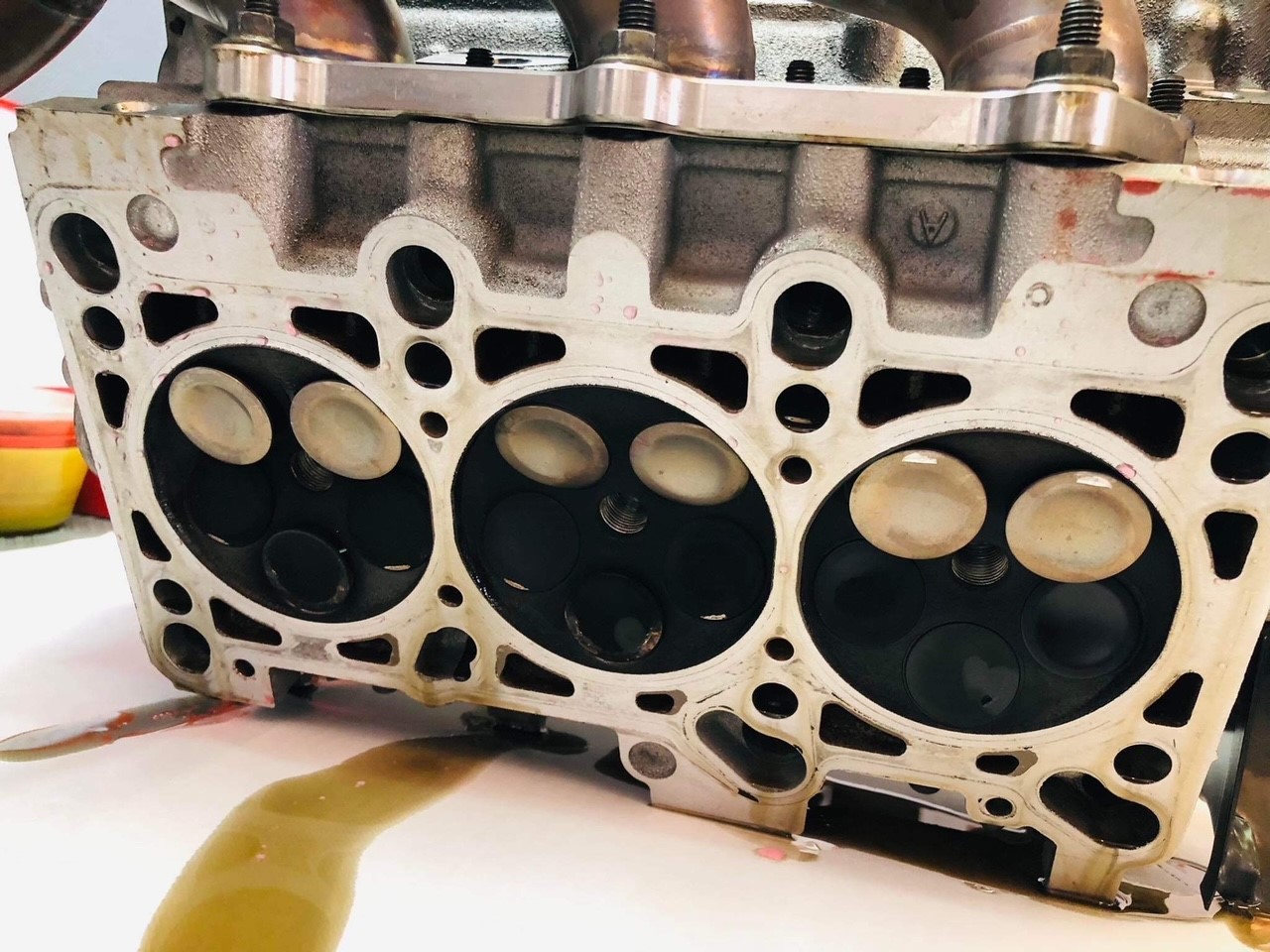

Already dismantled engine and conclusions:
- Most of the engine valves are bent ( ferrea competition )
- Not a single problem found on pulleys , waterpump etc ( all of them are new )
- Slight marks on pistons that won´t cause any problem later.
Other than that, the chamber gives me the idea of a very lean mixture, also the exhaust valves were "rought" on the surface, indicating too much heat.

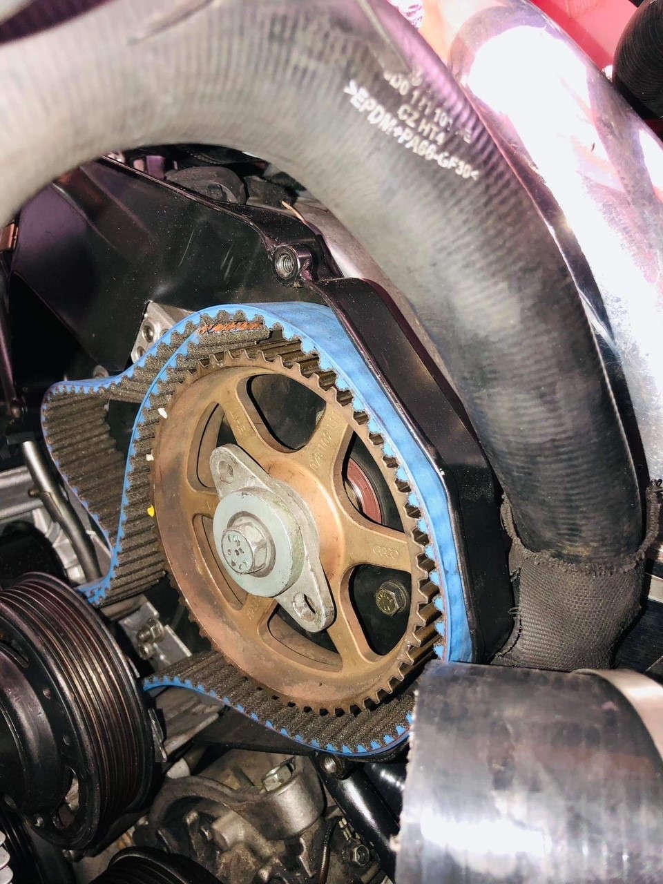

Did the belt snap because of overtension ? It seems that the supposed 15nm of tension wasn´t applied.

That's not good - was the belt new? I guess it could be a lot works i.e. bent rods or a hole in the block.
Why did you chose to use an aftermarket belt rather an OEM Audi one?

Well,
Don´t have an explanation for that.
Always knew Gates as timing belts company, and saw a vast amount of tuners using these gates rpm belts :)
There are many tuned S4´s and RS4´s using this exact belt..
Brand new when i bought it, it has the break in quilometers :)
