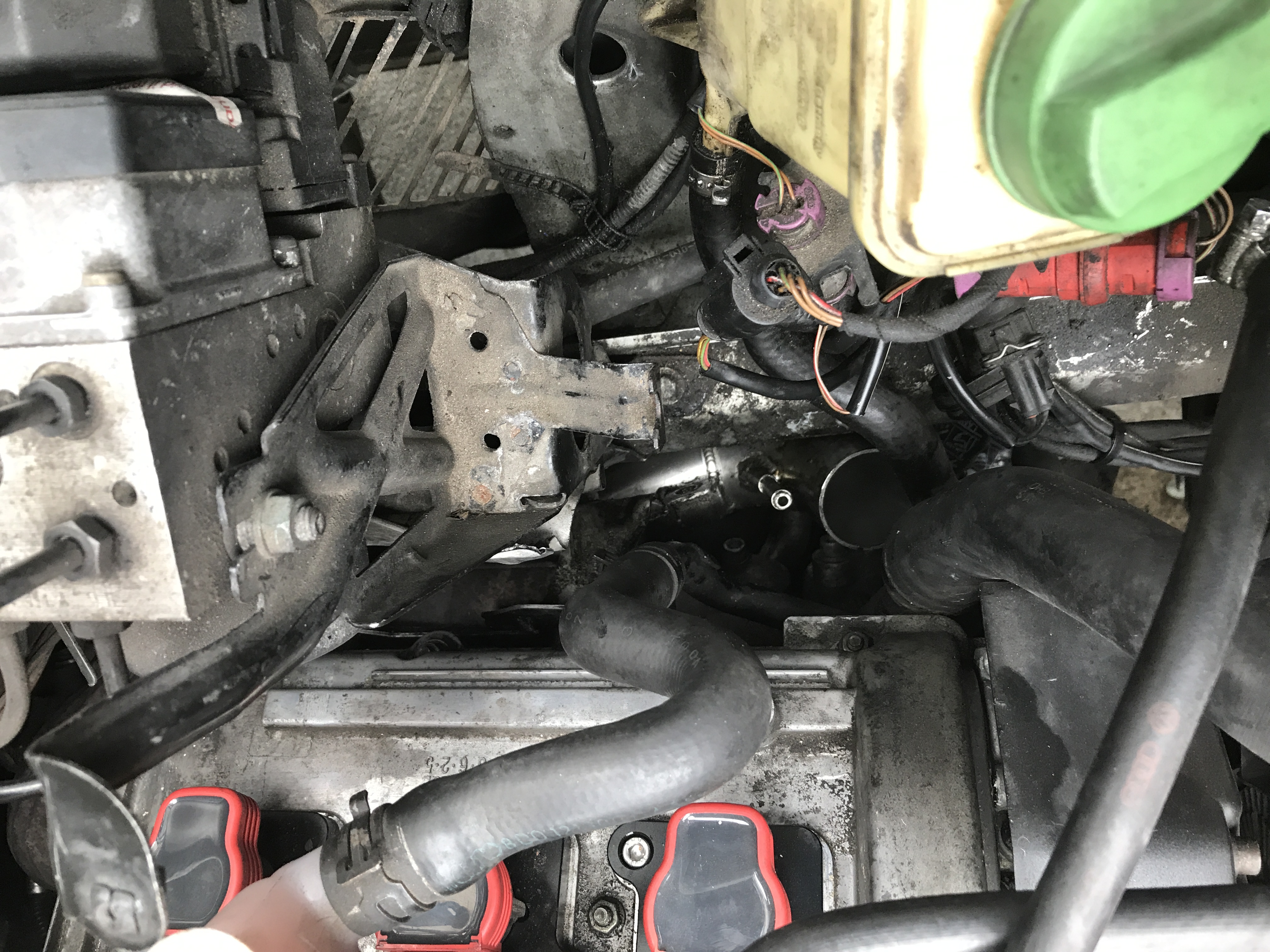

Remove the bottom bracket, move the expansion tank, the power steering bottle, headlight, partly remove the inlet pipe and you will see the top nut.

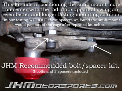

Get a new snub rubber and whilst there get three M10 x 45mm Allen heads, 3 washers, 3 oversized 10mm thick nuts as spacers and bring the snub bracket forward from the motor.
Search on JHM motorsport for snub mounts and you will find a picture relevant.

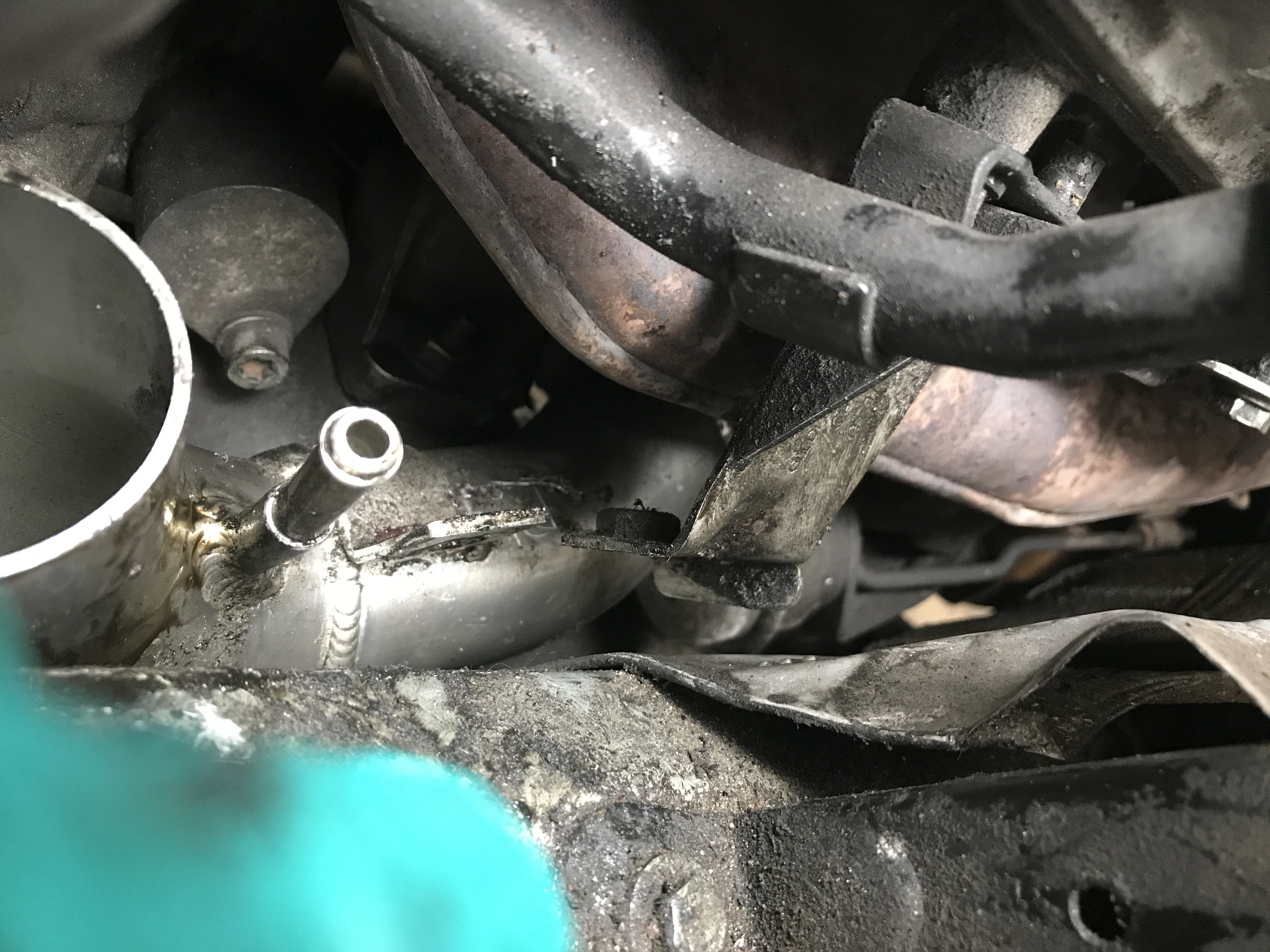

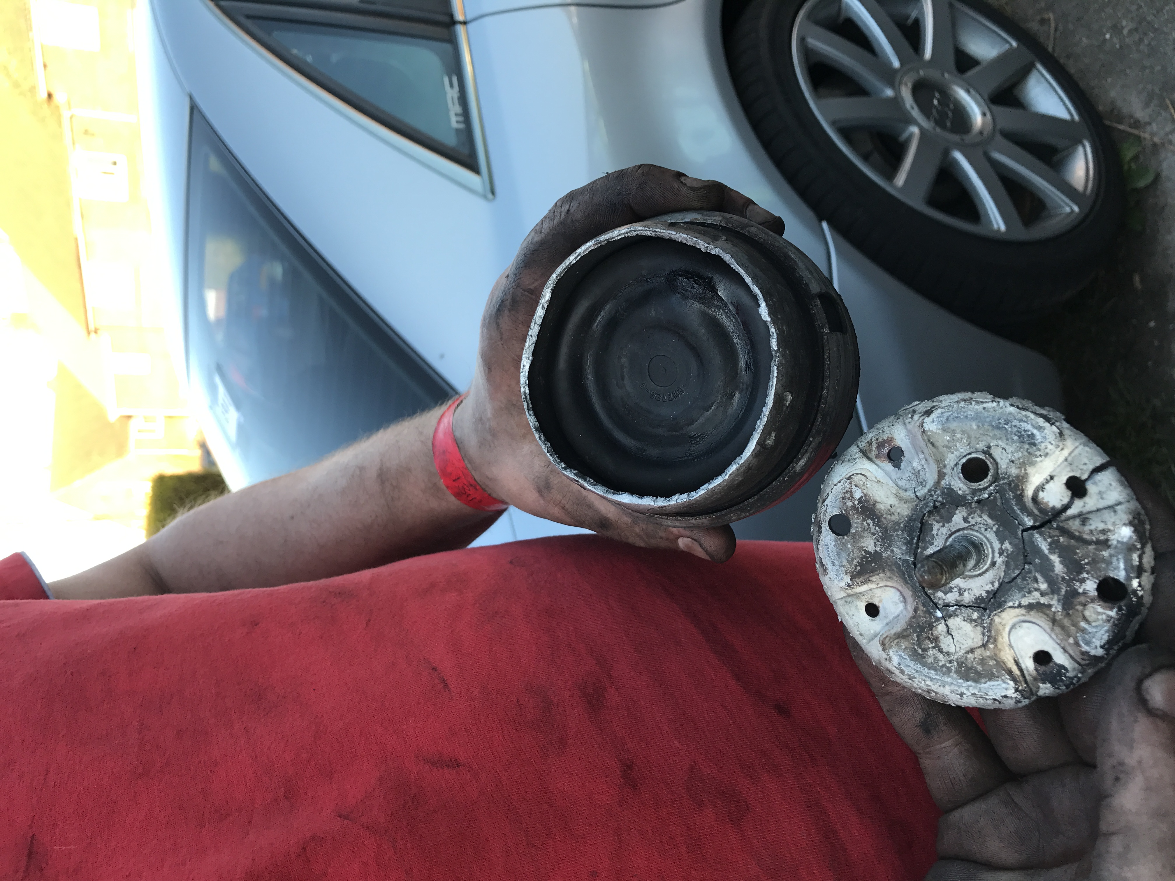

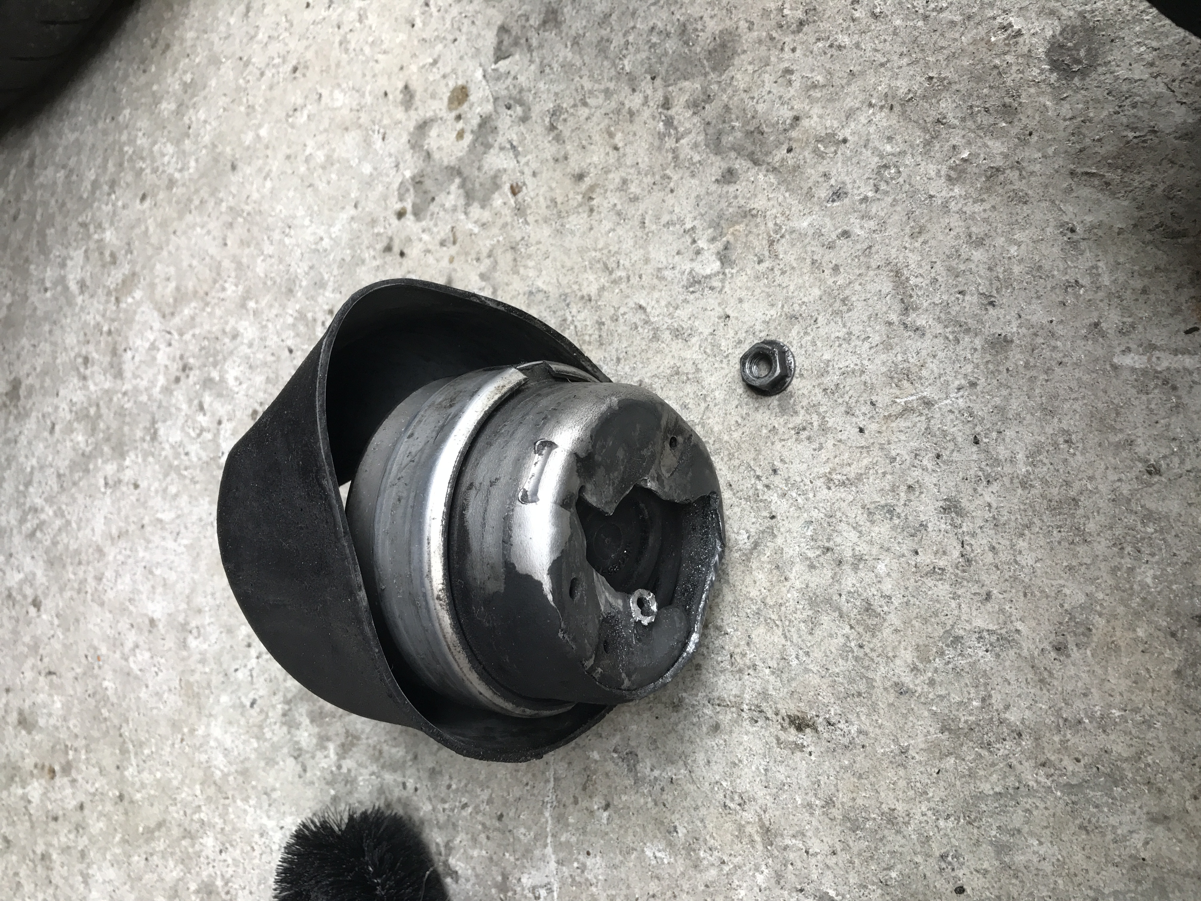

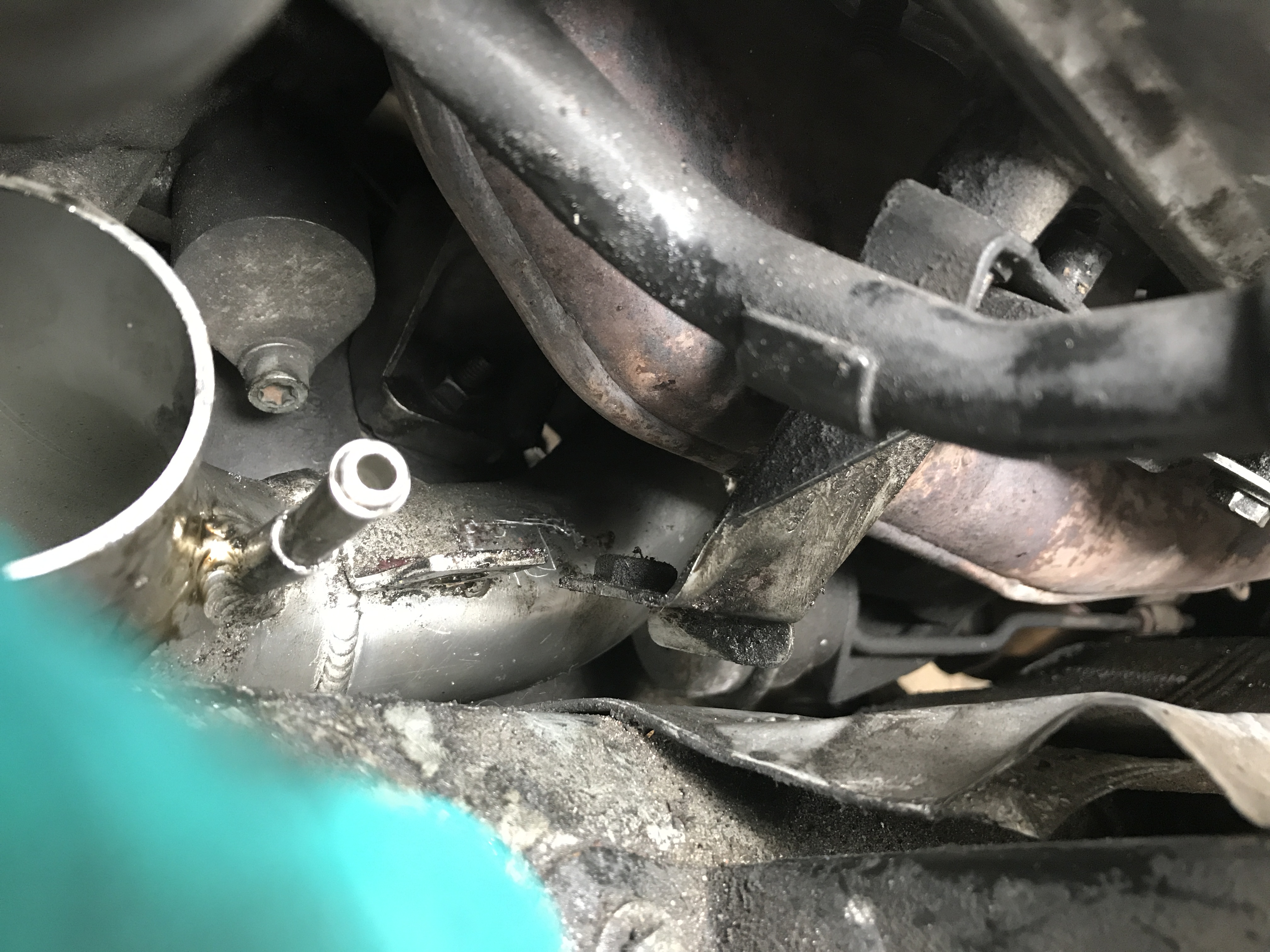

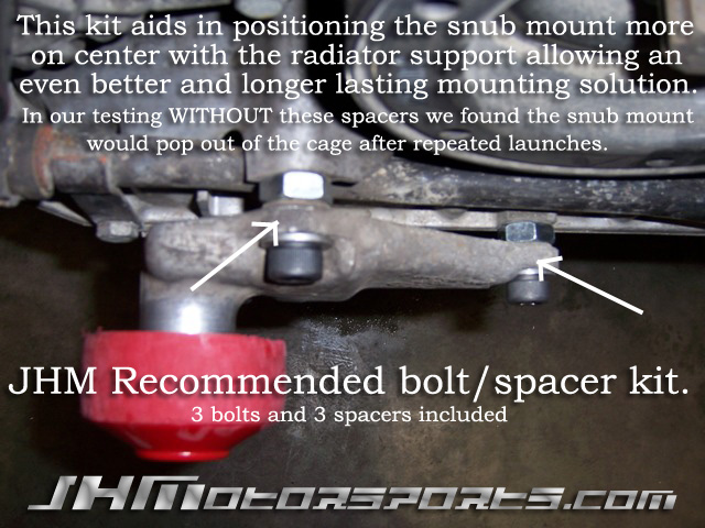

I've added some pics taken during doing the left.
I did the snub, the right and both gearbox mounts in 7 hours.
The left also took 7 hours.
If I'd of done all together I'm thinking allow 10 hours.
