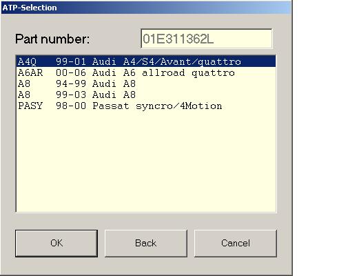

MarkB
Posts: 5695
Post by MarkB » Mon Aug 06, 2007 3:05 pm
This info...
gearbox part.JPG (25.88 KiB) Viewed 888 times
Mark

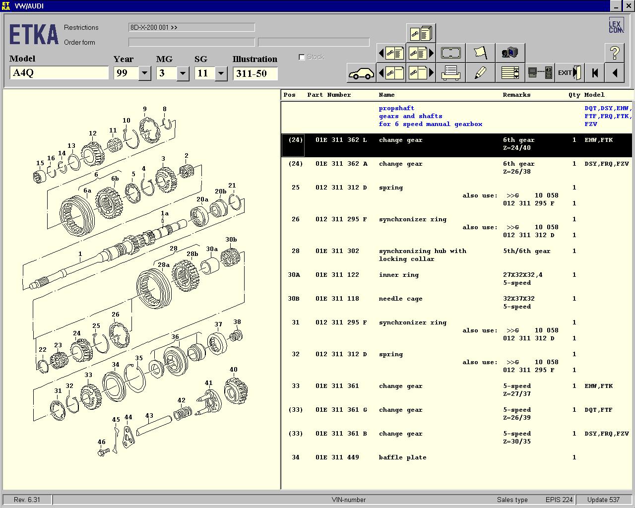

MarkB
Posts: 5695
Post by MarkB » Mon Aug 06, 2007 3:09 pm
and this?
gearbox gears.JPG (203.02 KiB) Viewed 886 times
Mark

Post by viperbl » Mon Aug 06, 2007 3:09 pm
Thanks Mark ... So wait a min, does that mean that the S4 box has the longer 6th gear??!?
RS4 B5 Saloon8) with 750+ bhp :D

viperbl
Posts: 1152
Joined: Sat Mar 12, 2005 11:23 am
Location: Isle of Man
Post by viperbl » Mon Aug 06, 2007 3:29 pm
I have also found Part no 01E 311 362 D which seems to have a ratio of 0.6 ... so, would this work as well!!?
God I am getting confused! http://www.vagcat.com/epc/search/?pn=01E311362D

Post by viperbl » Fri Aug 17, 2007 11:30 am
Here's a good one!!!
I got the 6th Gear, - 01E 311 362 L (0.6 Ratio), right, my gearbox man has now informed me this only half of it, I need the other gear that it will mate to on the other shaft!
Can anyone work out the part number for this other gear???!??!??!?

Post by viperbl » Fri Aug 17, 2007 12:21 pm
Update, with the help of DSGWagon we found the output shaft 6th gear is 01E 311 165 J.
So, another week to wait now!!! will it be ready in time!
