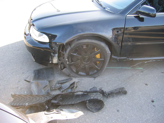

just to let you know how my rs4 looked like after 1 hour running on corsas without adjusting the front axle. repairing cost 5300 euros payed by my insurance....

Post by s8n » Mon May 03, 2004 11:31 am
Nice tyres ;)

Post by johnRS4 » Mon May 03, 2004 11:33 am
That looks bad Carl

Post by PhilT » Mon May 03, 2004 12:54 pm
Carl, you're monster :D

Post by Carl » Mon May 03, 2004 2:35 pm
i know that, and thats my problem....

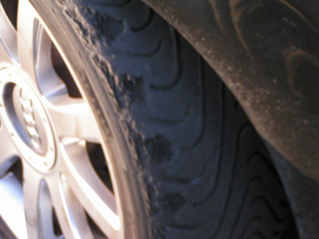

Post by simple1 » Mon May 03, 2004 3:10 pm
And what tyre was that, just so we know which one to avoid :piss: :dung:

Post by Carl » Mon May 03, 2004 6:33 pm
the tyre is a pirelli corsa racetrack semislick. you have to drive it with a special adjaustment on the front axle (german: ca. 4 grad sturz) to avoid that the sides get worn out. doing 15minutes on the rsdc 2003 in hockenheim with normal adjustment and your sides on the front left tyre are gone. see attachment:
Resize of PICT0876.JPG (72.4 KiB) Viewed 2283 times

Post by kiwi_mtm » Mon May 03, 2004 7:31 pm
wow..
Other than Not having the camber kit in, were you on stock suspension ?
Carl
Posts: 98
Joined: Tue Jan 14, 2003 2:31 pm
Location: Germany
Post by Carl » Mon May 03, 2004 7:48 pm
nope. quattro gmbh kit with h&r sway bars front and rear
