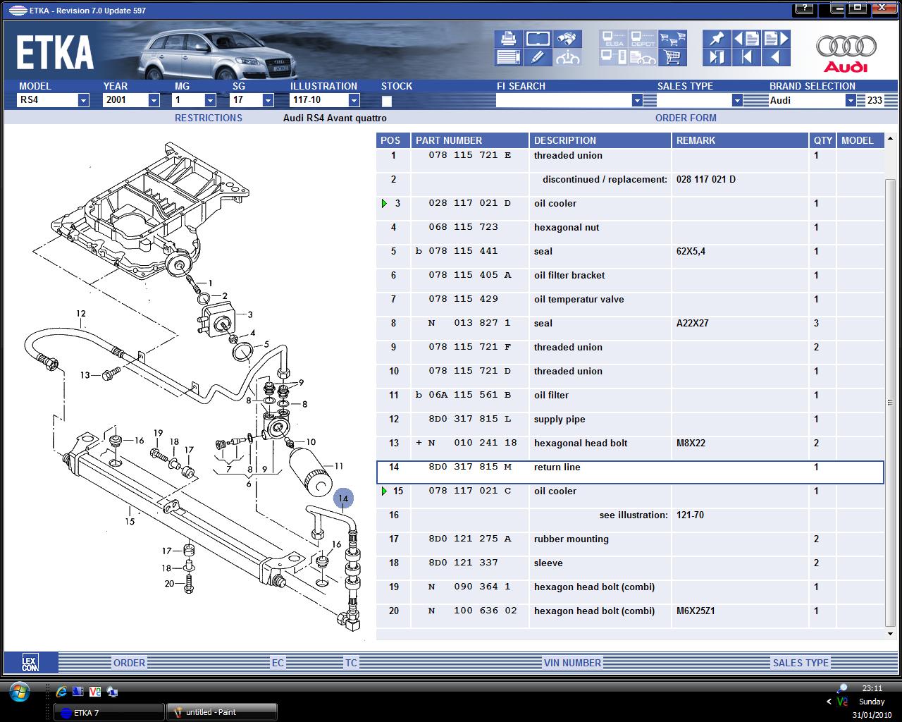

In the attached from ETKA diagram it’s part 14 but it looks like it’s the wrong way round the bent end connects to the cooler and that’s where the hole is.
