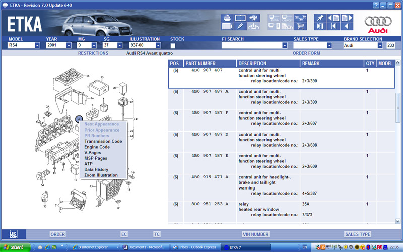

can any one tell me were the relay goes for the mirrors

ETKA says positions 11 and 12 (from top left of relay board)
"electronic control unit for elec. folding mirrors, relay location/code no. 11+12/361"

i will look tomorrow but i look today all the relay board has all the relays there
there is no extra conections for any more

no i dont need to swap 1 ive bought all the parts switch relay mirrors just need to know where the relay goes or is there a extra loom that goes to the relay board

There seems to be an extra board above the main relay board - see pic
Mirror relay is no.6 (sorry it's got popup!)

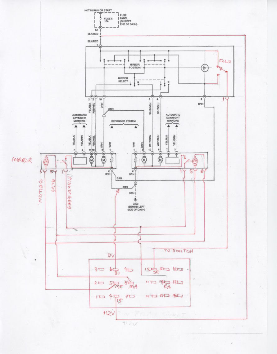

i coped this from another forum
so it looks like u have to wire them in to the relay board your self ill have a go tomrrow and let u know does not look that hard from the picture

i have fitted these today and if u follow the wiring diagram its very simple
just need to get them working with the alarm
