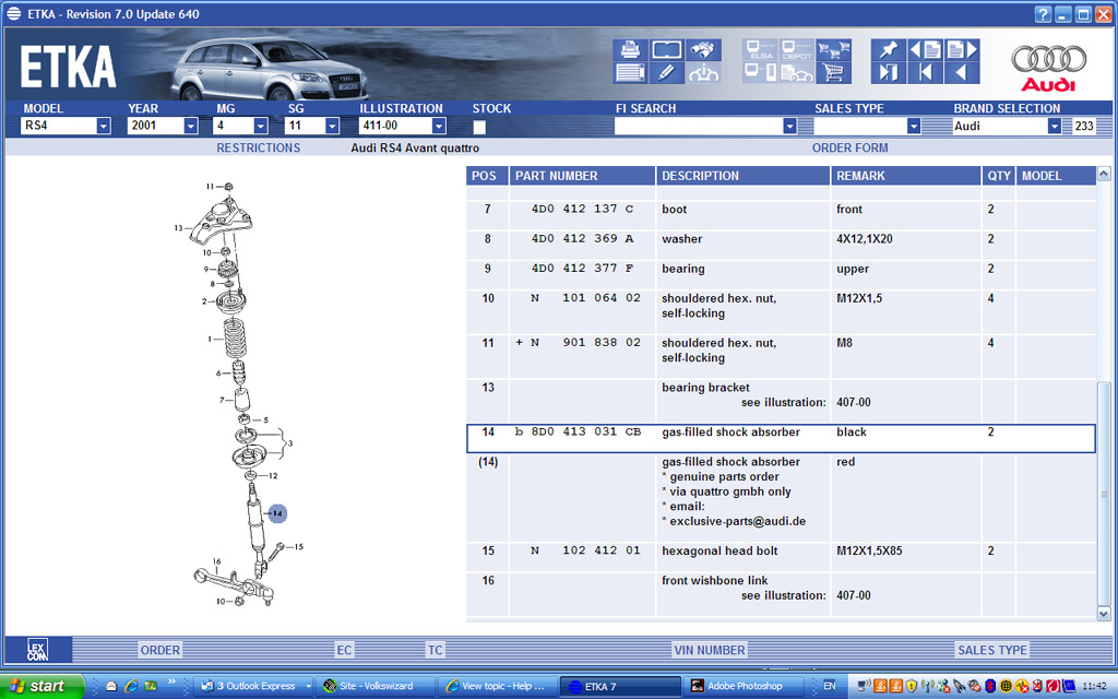

Posts: 4468
Location: The Point
Post by neckarsulm » Sun Nov 22, 2009 12:45 pm
ETKA says black=stock GmbH =red but it could be wrong, pic below
