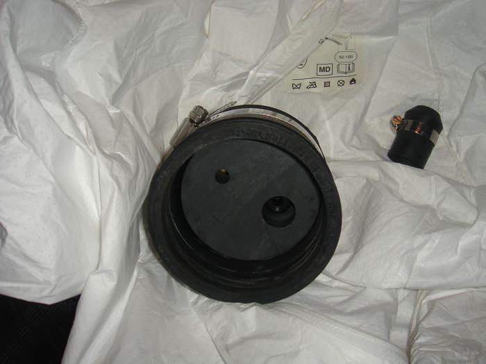

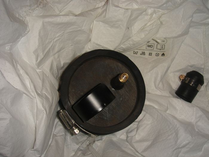

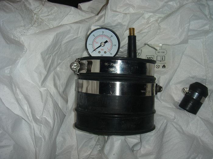

here you go

the little thing on the right is the pcv valve take off on the y pipe blank. when pressure testing you should go to 10 psi max as the intake pipes aren reall designed to withstand pressure. a little suction pump to check the dv diaphrams arent split is a good idea too
